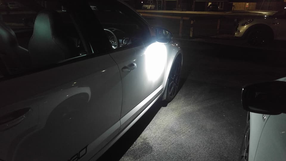

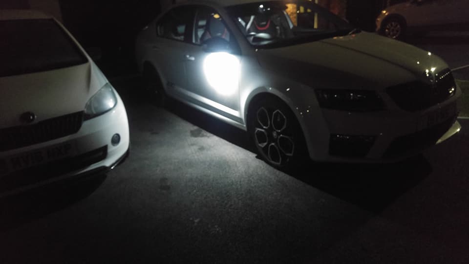

I've also got exactly the same eBay ones and can reiterate they are good and don't throw any fault codes. It would also be possible to just replace the bulb with an led one rather than the whole housing.
me too for the cheaper ebay ones as listed above, the light they give out is really bright, the only thing for me is they are very open ie where you would push the lamp holder into the original item and it seals tight there is just a hole with the 2 wires coming out. I covered the holes with electrical tape but im not sure how much water could possibly get into the mirror housing.
they are really easy to fit as well just follow the superskoda video.

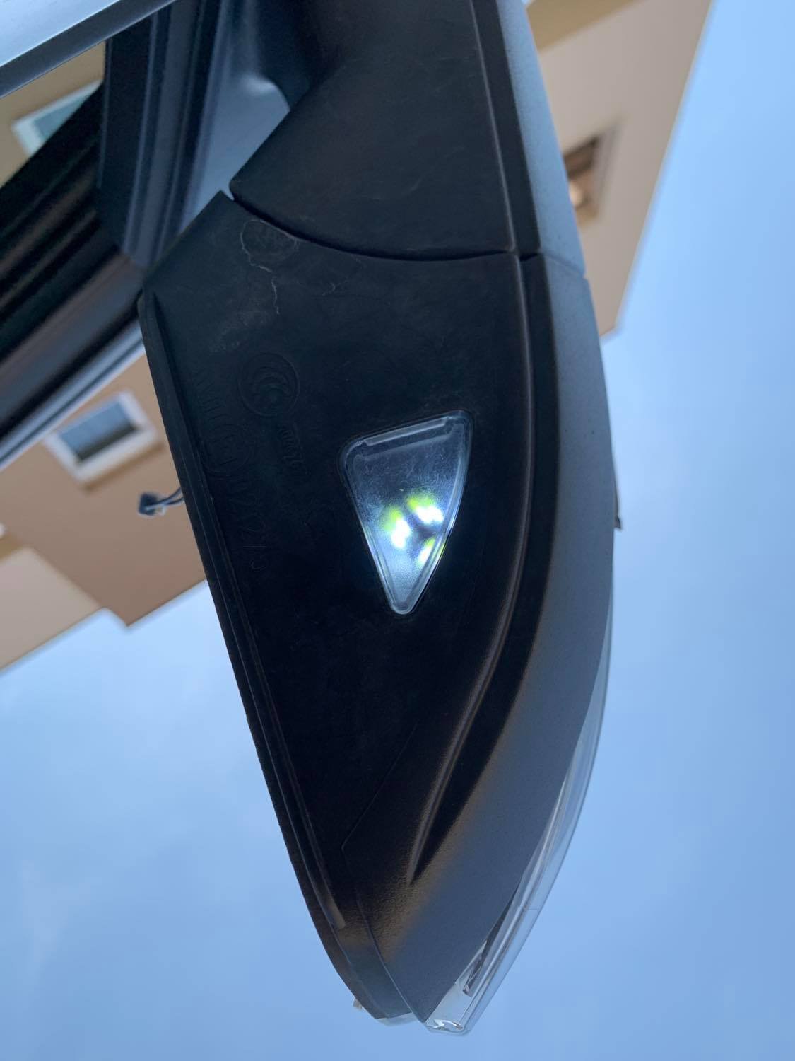

These are too bright in my opinion! Do you have a link to the superskoda video

Is there coding for this bulb upgrade? Not just because of changing bulb type, but also for setting max power if it too strong or something...
No coding needed, i used these bulbs from AliExpress without CANBUS and they work perfectly, no need for reducing or increasing power. It also important that only the smallest LED bulbs can fit, since there is very little space.

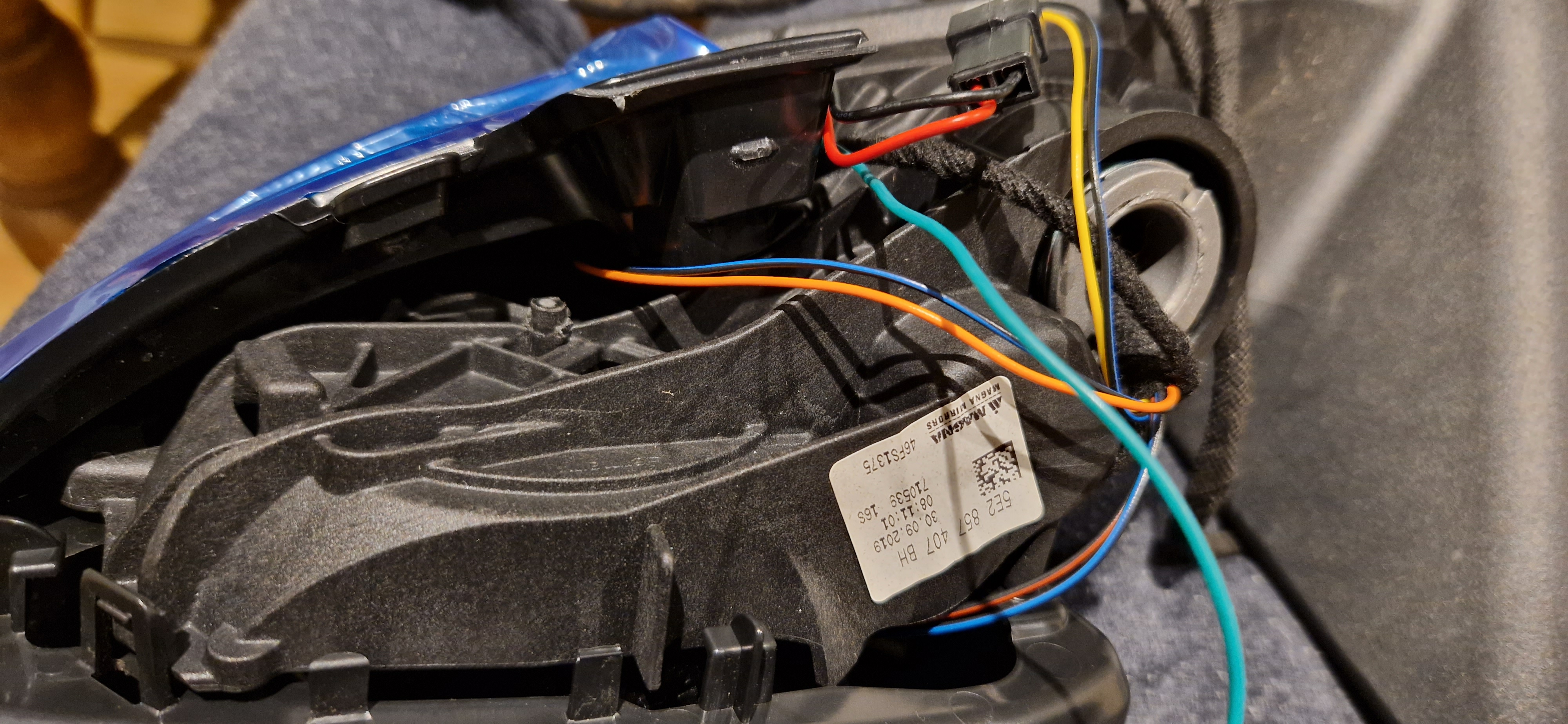

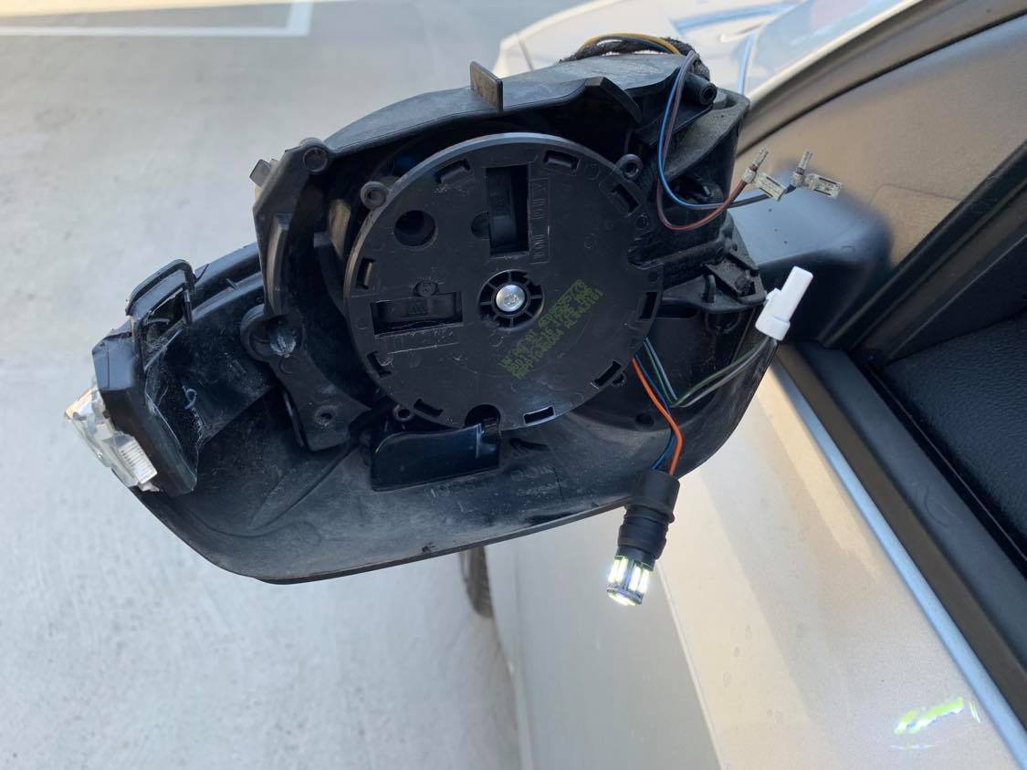

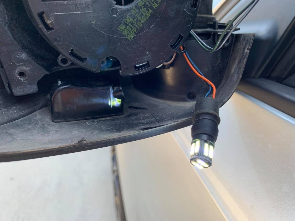

Anybody know which is the positive wire to the puddle lights? Orange or blue?
Thanks
