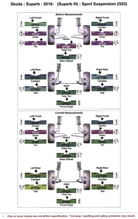

Wheel alignment @ Kwik-Fit question
I had my wheels rotated and aligned at Kwik-Fit. It was quick, courteous and they sent me home with a before and after printout. At the very bottom of the page, in red, it says, "One or more values are not within specification. Tire wear, handling and safety problems may result." So, I paid them £65 and they sent me home with a health and safety warning.
Today, I went to see the service manager for an explanation. He said he had never seen such a warning statement before. I showed him the two values that were out of spec. They were both related to left and right front wheel caster. The range was meant to be 8°15'-7°15'. The left front castor was 7°14', the right 7°09'. So, not way out, and the same as before the service was done.
The manager said some adjustments could not be made and had to be done at the factory. So, I have two questions: 1) does this sound likely? and 2) would the fact that the Sportline sits 15mm lower than other Superbs account for an incorrect specification range? They use the Hunter Tracker wheel alignment system. It does say on the printout: Sport Suspension (G02).
I've queried Kwik-Fit customer services, asked my dealer's service manager for his opinion and, now, you good people. Any comments?

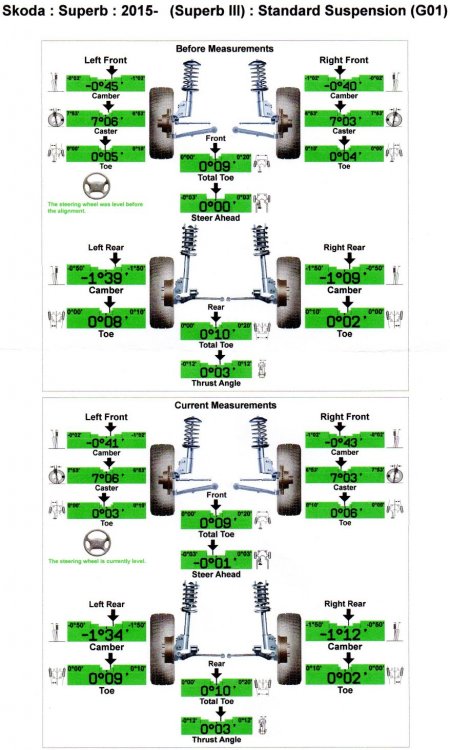

The before measurements.
I had lots of red when I had it done and then put new tyres on which meant it had to be done again, so be warned.
The front left wheel was red on the camber and toe and green on the caster. The front right wheel was only red on the toe. The combined front total toe was red as was the steer ahead.

Obviously I forgot to add that the after test was green on all points.:blush:D

So the camber is out by a maximum of 6' ( minutes ) on one side and 1' ( minute ) the other side.
1' ( minute ) is 1/60 of a degree which is 1/360 of a full circle.
The amount it is out by is insignificant. Don't waste any time or money on this.

After hitting a pothole quite hard last week I decided to take the car over to a friend… a Kwik Fit manager :ohmy: anyway, some helpful info (hopefully):
Hunter kit is still regarded as the best available, but it obviously depends on the operator.
Firstly, the caster is not adjustable on the Superb III… not even by a dealer. The front camber can be adjusted, but only in tandem as it involves loosening the subframe bolts and even then it doesn’t always budge... it’s not something they generally do. He also suggested there was an in place kit available to allow for further subframe adjustment… again, not something they do. The toe is what matters at the front, within reason.
The camber and toe can be done at the rear although some cars come with standard bolts from the factory so cam bolts are needed to make adjustments (SIII has cam bolts already). It might explain @Danny 57’s situation, although they might just have been seized. He also said there are no stretch/single use bolts required for suspension adjustment that he knows of.
He said to fill the tank before coming over and keep the boot filled with what I normally carry. From memory, there were five suspension choices for the SIII and mine was the G01 (standard). Some of the newer Hunter setups have a vin/index lookup, but this 2012 machine asked to reference the build sticker codes. Although the vehicle database updates regularly, the core software normally doesn’t unless there is a fault with the kit. I noticed how sensitive the ramp was and the figures changed the higher up the car was… closer to the cameras. Hunter software options vary and some allow you to skip the ride height values etc. and some add the disclaimer that you got @freelunch… others versions don’t. The kit is calibrated once a year so might be worth asking when your place last had it done.
Up here in Scotland it’s £50 to make an adjustment at the front or rear so £100 if both require it. They do a £130 cover option which allows a check/adjustment every three months for two years.
No adjustment was needed (or worthwhile) on mine:
@Alan_P Thanks for that! I expect that by Thursday I will be getting a very similar reply from Kwik-Fit.
I find it interesting that my castor measurements would have been within spec if the computer had loaded your car's settings.
