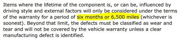

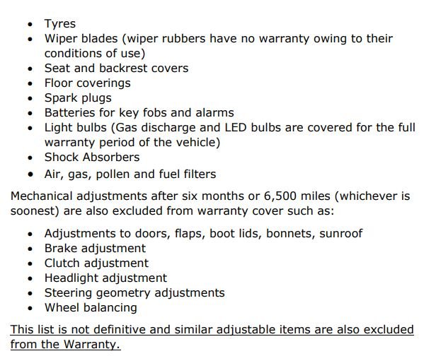

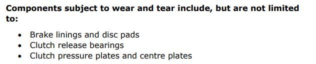

The reason for getting them looked at now was due to this little caveat in their warranty terms and conditions...
