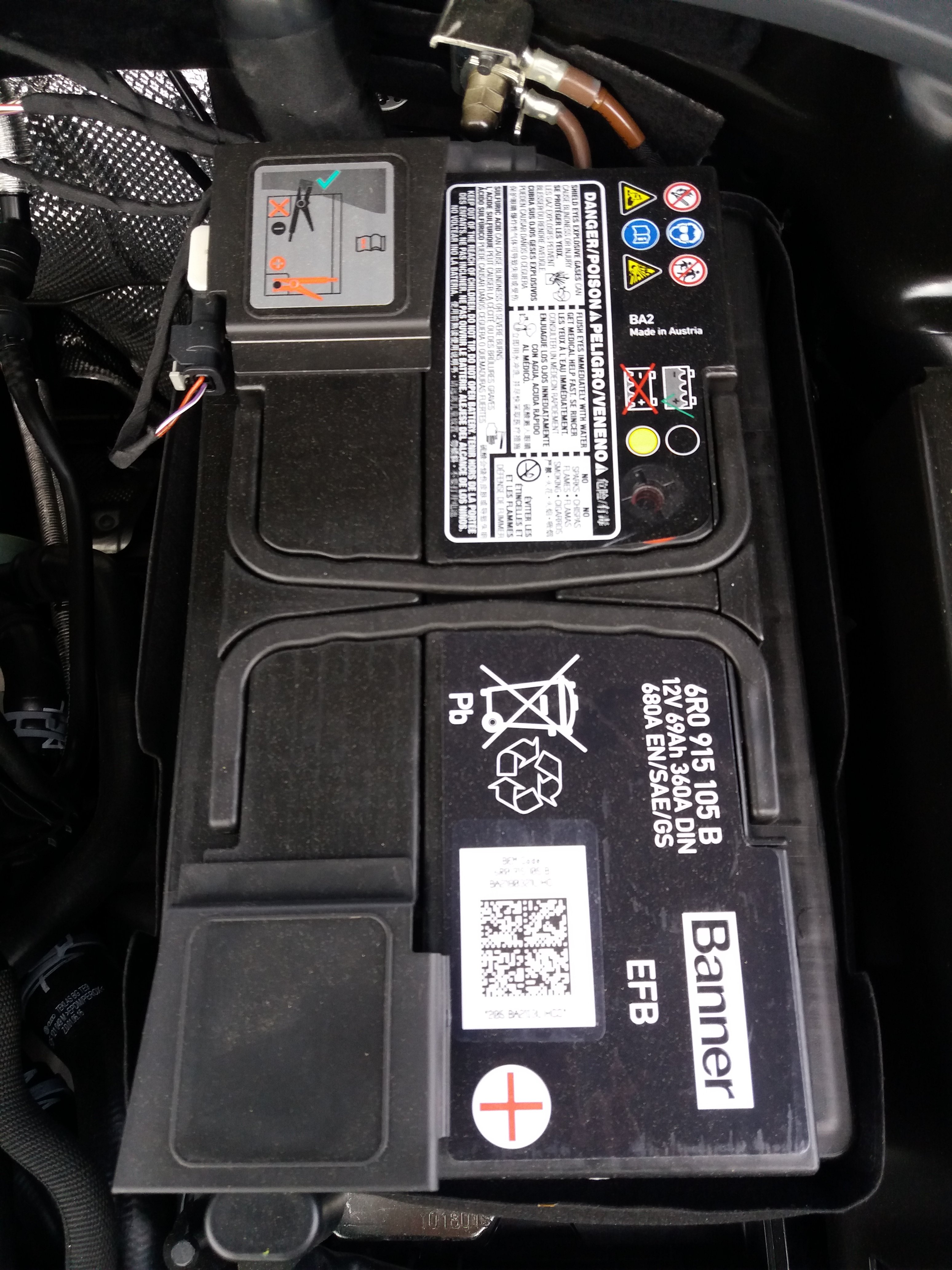

Evening All. I've noticed recently that my Scout starts slower than it used to, it was doing this in the warmer weather as well. The engine starting sign comes up and it takes a couple seconds at least to fire up, nothing major but not as fast as it used to. Is this normal or do i need to top something up?
There is a large batch of duff batteries across the Kodiaq. A well documented issue that Skoda UK are well aware of.
Pop the bonnet and take a picture of the battery. If it's got MOLL written on it, then it needs changing under warranty. Ring Skoda Assist, telling them your car won't start. They'll send someone out to fix it on your drive within a few hours, no messing about by having to book it into the dealer. The vans usually have stocks of batteries onboard, although expectedly there has been a shortage recently.
Luckily, mines a Banner...
This is (similar) to what the defective MOLL battery looks like...
Edited by silver1011
Ah i see, will have a look in the morning. So if it is a MOLL, i just call Skoda Assist (AA?) and tell them it won't start, even though it does?
Yep!
Otherwise they'll tell you to wait until it fails, at which point you'll be left stranded somewhere.
Or, they'll tell you to book it in at the dealers so they can perform a battery health check. If it's a MOLL then it is very likely it's faulty and they'll swap it out there and then.

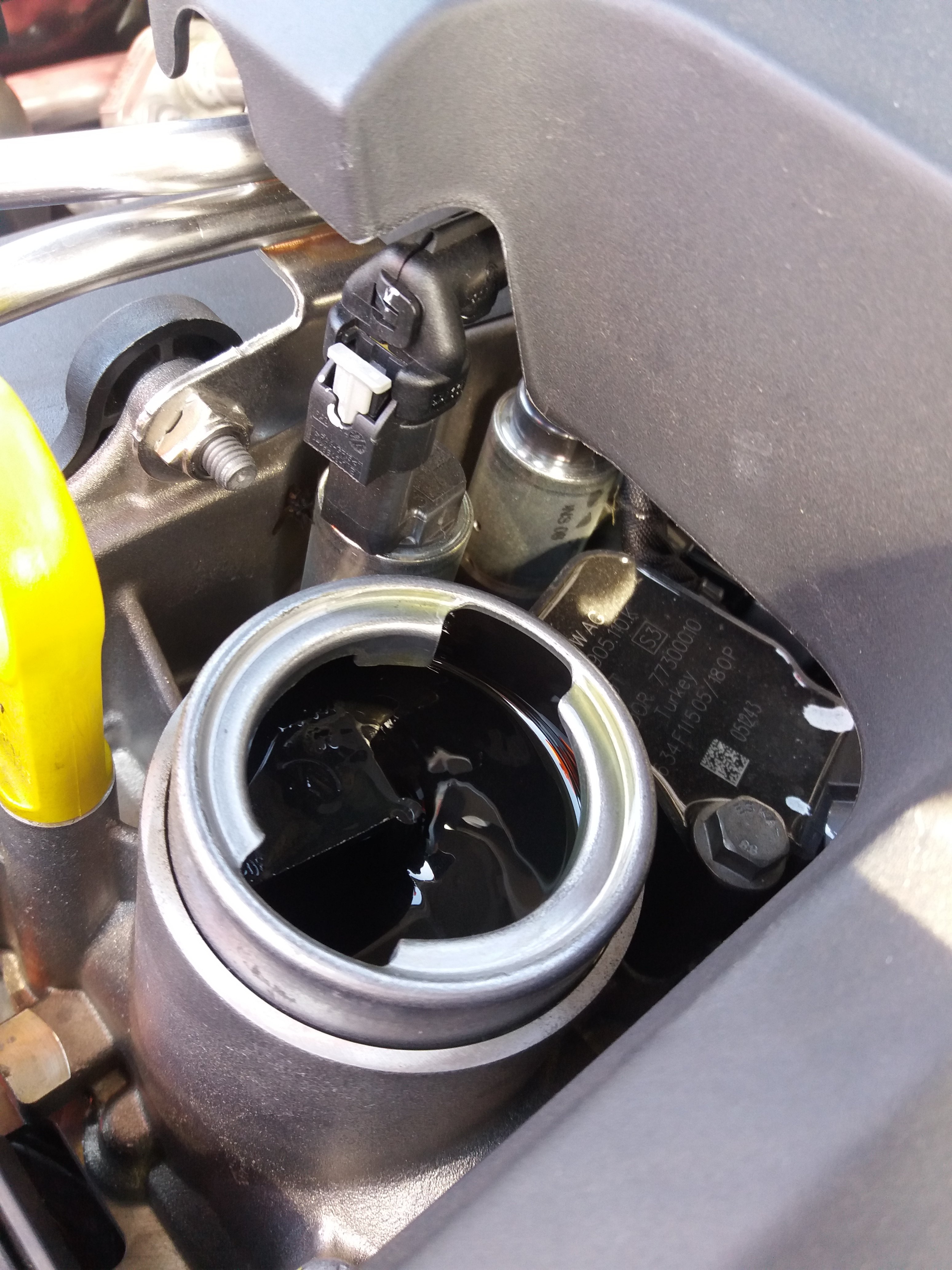

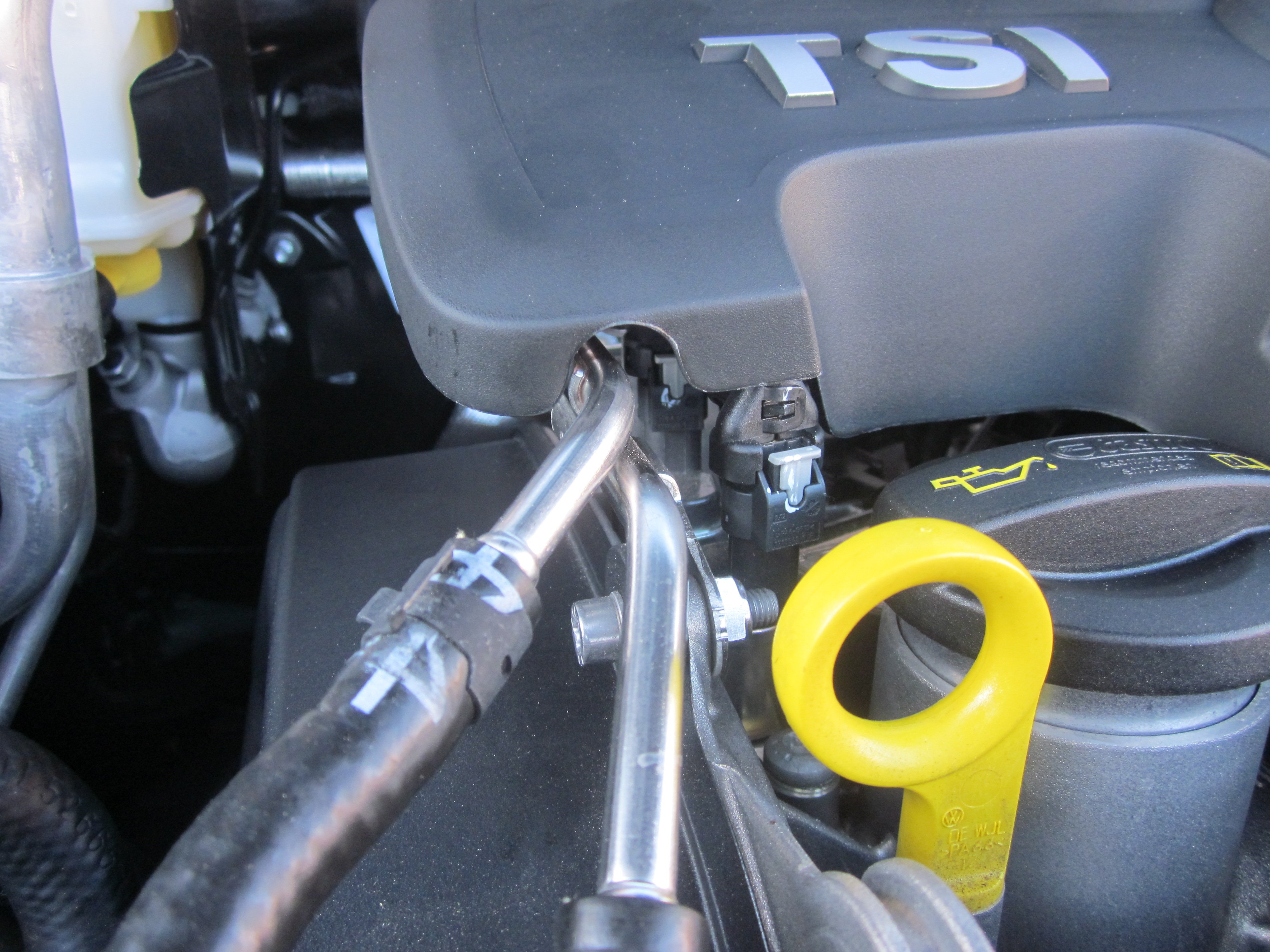

Also topped up the oil the other day, what is the point of the two pieces of plastic wedging down the dipstick? There seemed to be something to line them up with but as much as i pulled it wouldn't come out easy. So i crouched over and rested my elbows on the front of the car and preacher curled the git, boom one of the pieces of plastic went flying into my face and the dipstick came out. It's hard to seat the dipstick back in which should be the easiest thing in the world so you can check the level once you've cleaned it, but it had to push down hard to reseat it. All seems completely pointless, the dipstick is well and truly lodged into the whole, it wouldn't come out on its own!
The issue is often intermittent with the duff batteries. Sometimes the car won't start, on a different day it'll start as usual. You've nothing to lose by calling them out.
Just make sure you're going to be home for a few hours, depending on their response time.
The little lugs on the top of the dipstick help to secure it in place. As long as you lift it directly up and not at an angle it should come out with some force.
No lugs on my 1.4 TSI Scout though...
I think the diesel one looks more like this...
Yes that looks like all the other dispticks i've ever seen, but there's no way in hell this dipstick would go out of place without those plastic lugs. Anyway one's gone now so i should be able to get into it easier now :D
Checked my battery yesterday, its not a MOLL (can't remember what it was but it was def not a MOLL.
Probably either Varta, or Banner.

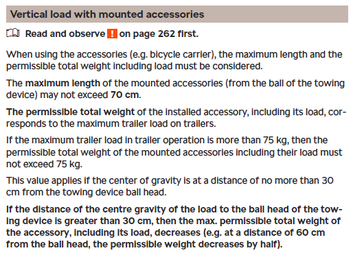

Can't wait to get back out with the family on the bikes, now we have some new bikes I thought I'd better check the tow bar vertical weight limitations. All good.
The tow bar rating, according to the manual is 75Kg...
The carrier weighs 20Kg leaving 55Kg for the bikes themselves.
Voodoo Bizango -  12.7Kg
Cube Access - 13.4Kg
Pendleton Junier Hanberry - 10Kg
Apollo Claw - 9Kg
Total 45.1Kg
So I have around 10Kg spare which should be enough to allow for the two kids bikes to grow in size and weight as they get older.
