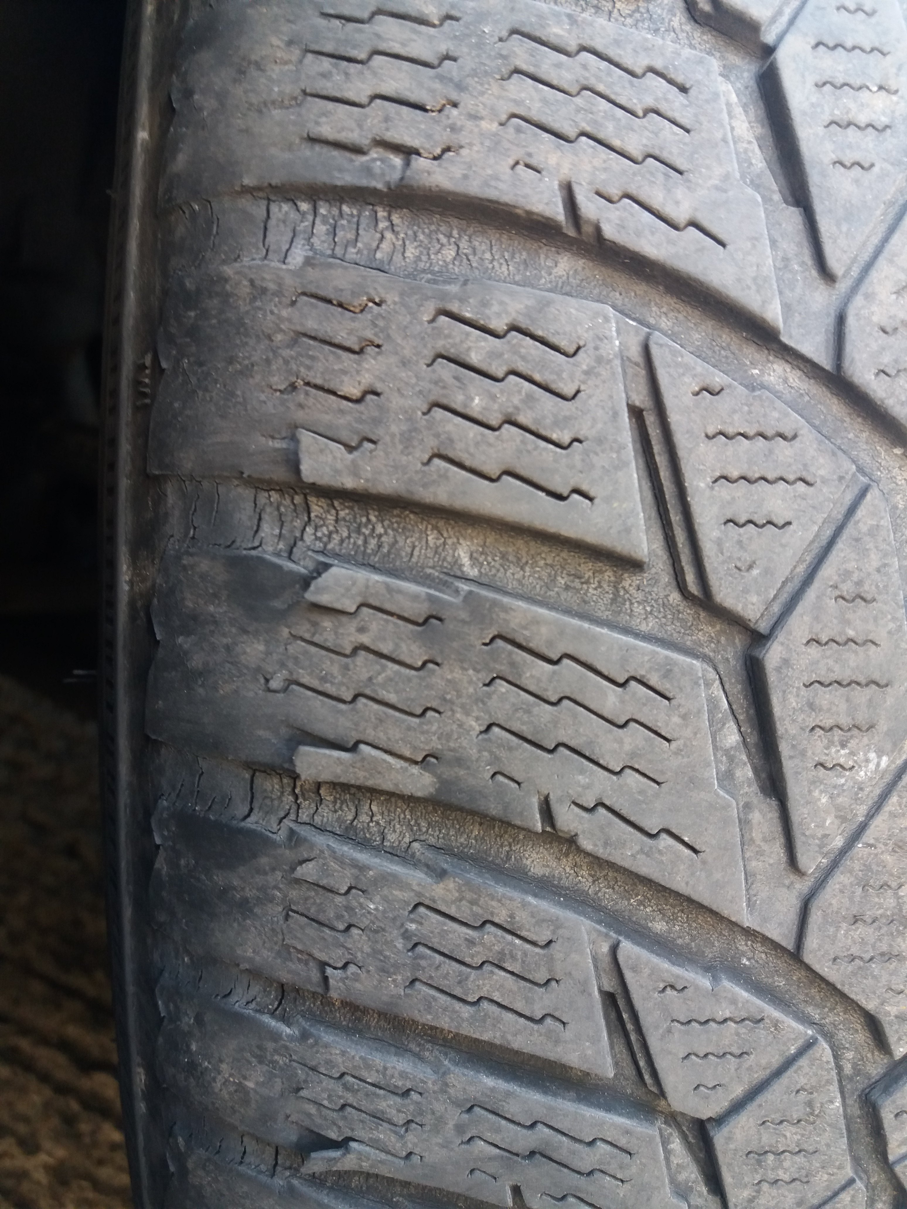

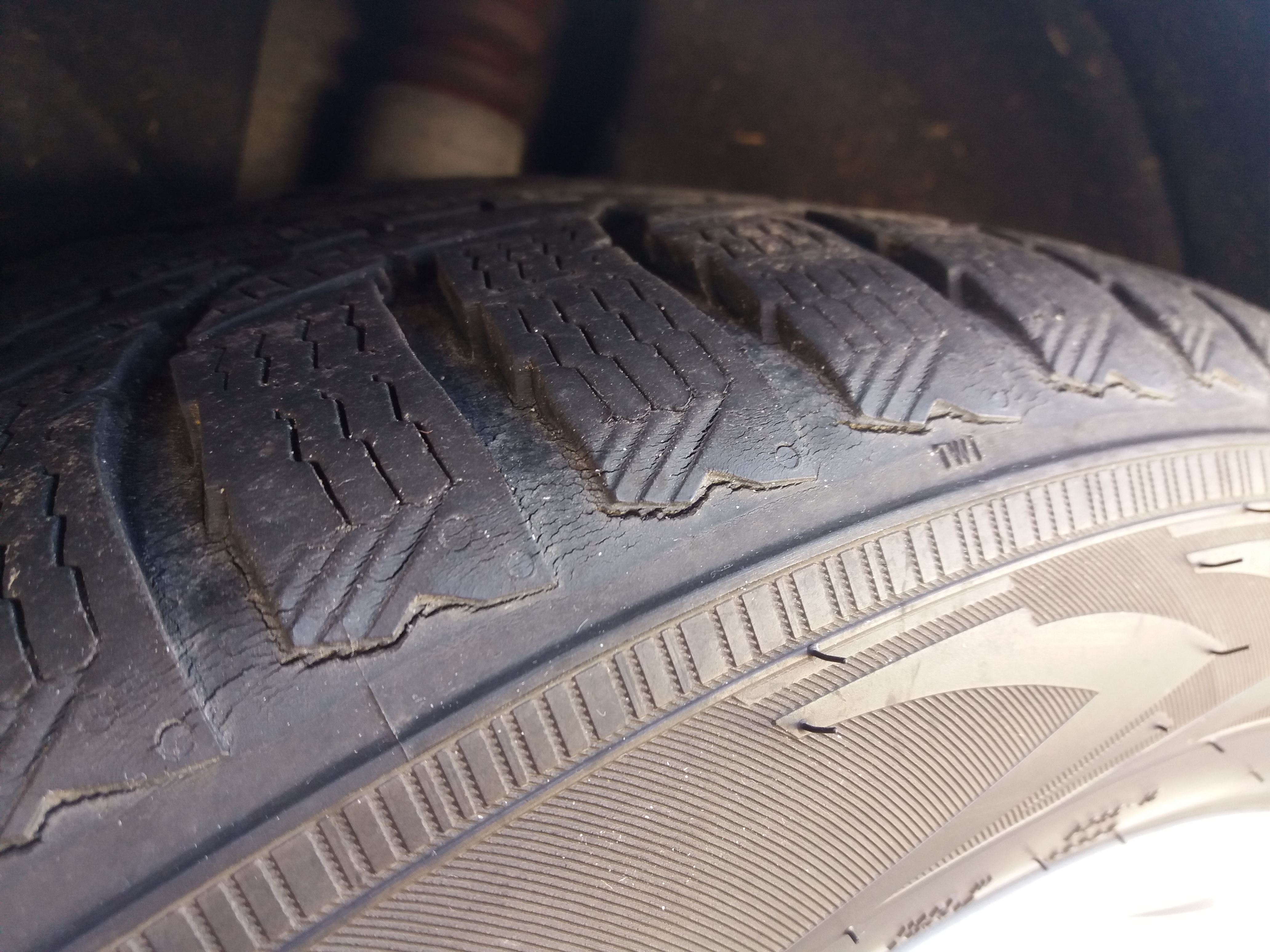

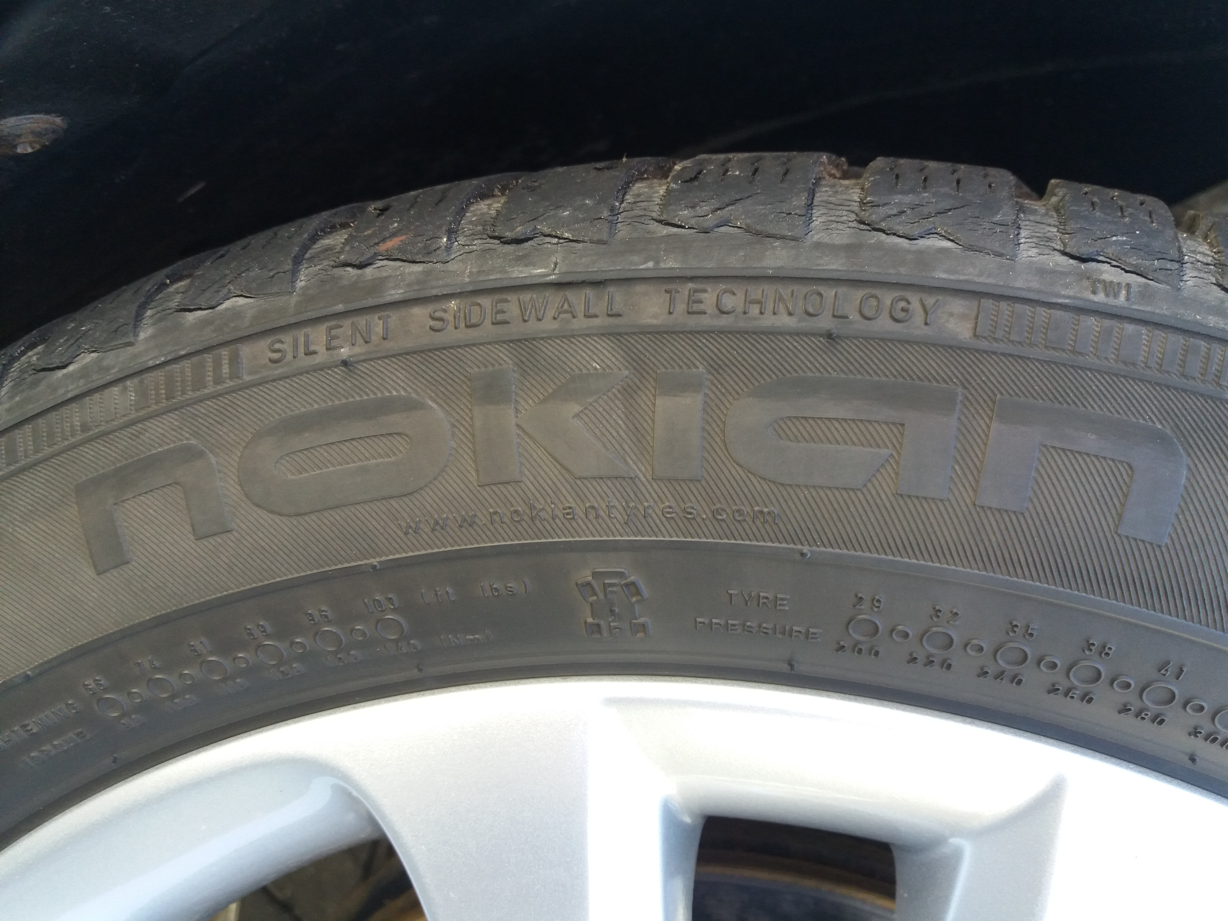

Whilst washing the car today I noticed that my two year old Nokian WR D4 winter tyres seems to be showing some worrying signs of decay.
Now they've done two seasons my plan was to keep them on the car into the spring / summer until they're closer to the wear bars before disposing of them.
Are these cracks dangerous, would it be worth contacting Nokian or could this be classed as fair wear and tear?

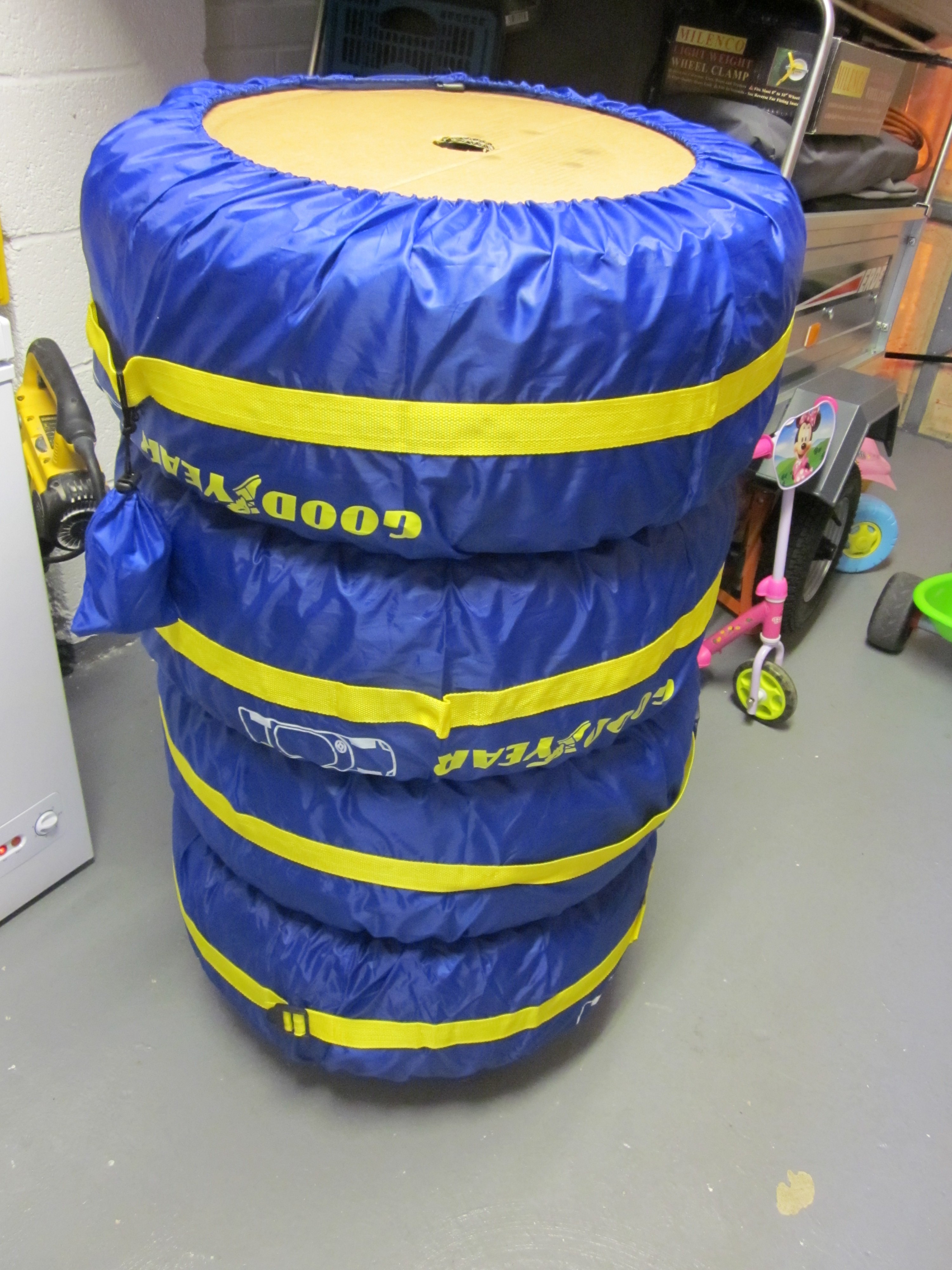

They been stored correctly during the summer months, with covers in a cool, dry garage on a tyre tree...
Edited by silver1011

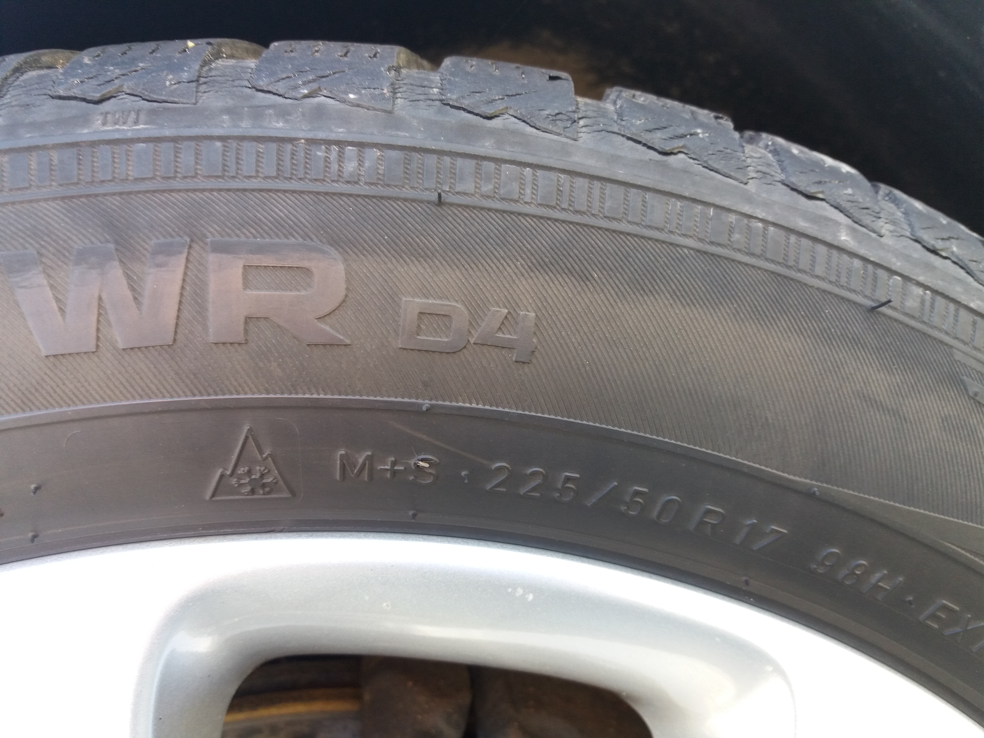

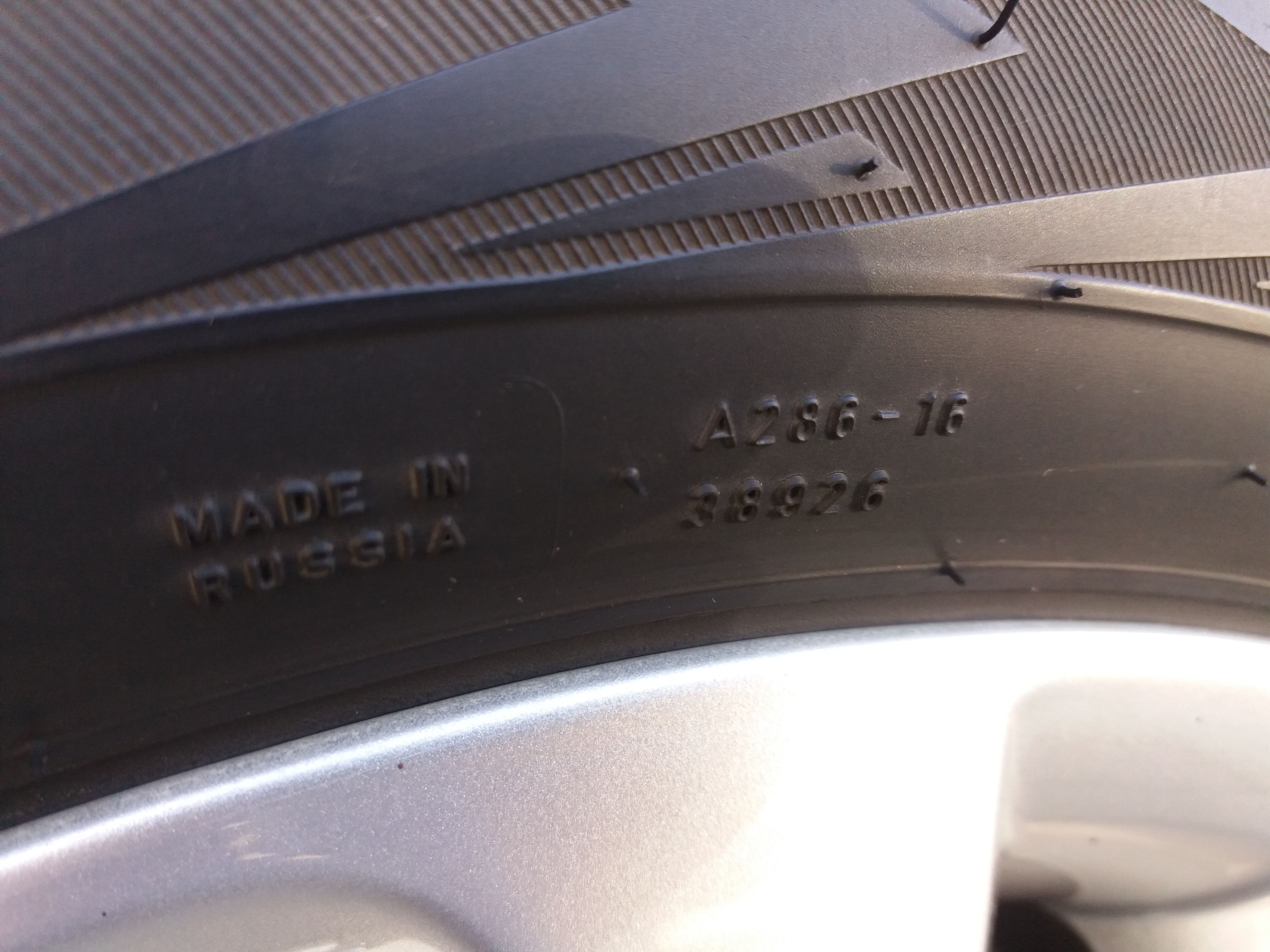

What's the date stamp on the tyres?
Made in Russia? ... :D ... that doesn't seem to me as regular wear and tear, you're not driving on that part of the tyre (usually) .. .and the cracks are far too precise on each vertical section

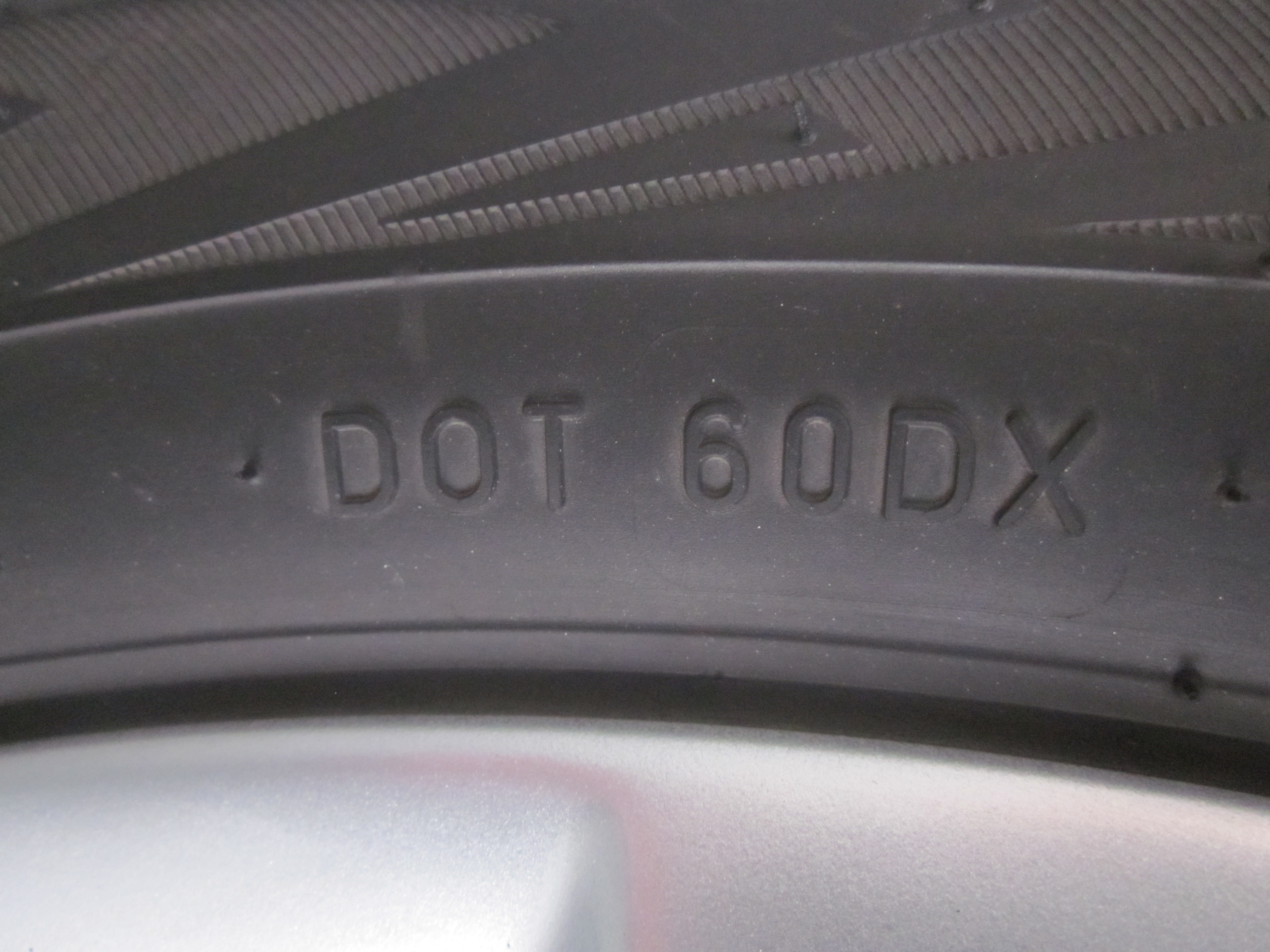

Hmm, is this the date code?
The first two digits after 'DOT' are supposed to be the week, the second two the year...

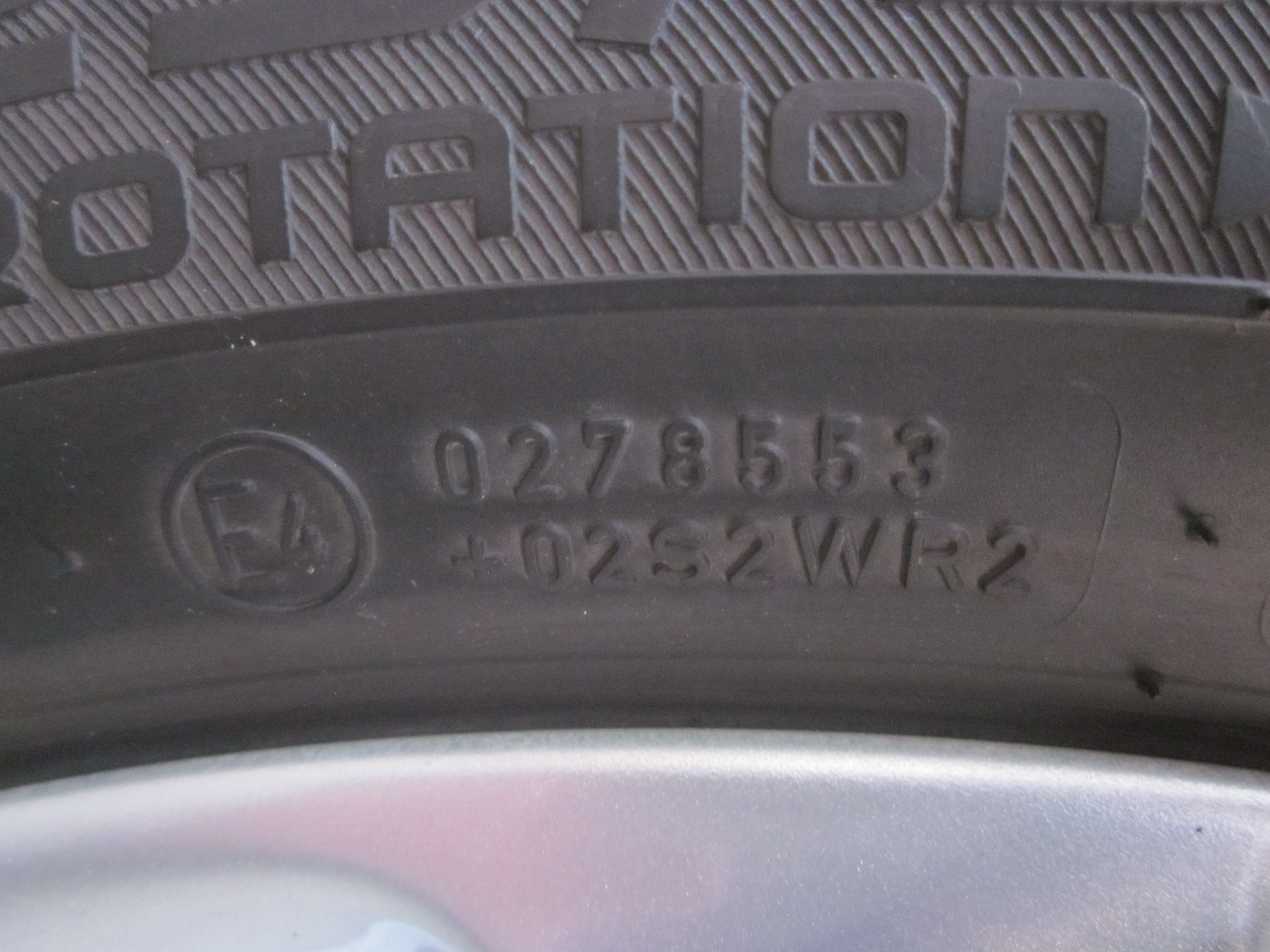

Aside from the numbers next to 'Made in Russia' pictured earlier, these are the only other numbers on the sidewall...
Confused :speechless:
Found it, weirdly, it isn't on every tyre, they're rotational so perhaps its on the inside sidewall on the first two tyres I checked!
3215, so week 32 of 2015, or August 3rd 2015.
That makes them 2 and a half years old.
Mine are 3315, Nokian WR D4, same as yours. No signs of any cracking on mine. And yes, only date stamp showing on the tyres on the passenger side.
Well, I'm no expert on Winter Tyres but I wouldn't use any tyre with those cracks.
Life is too short and your contributions here are far too useful to risk having you wrapped around a pole or anything similiar.  Well, a dance pole might be OK but that is a private matter and I don't need that picture in my head on a Sunday night... :happy:

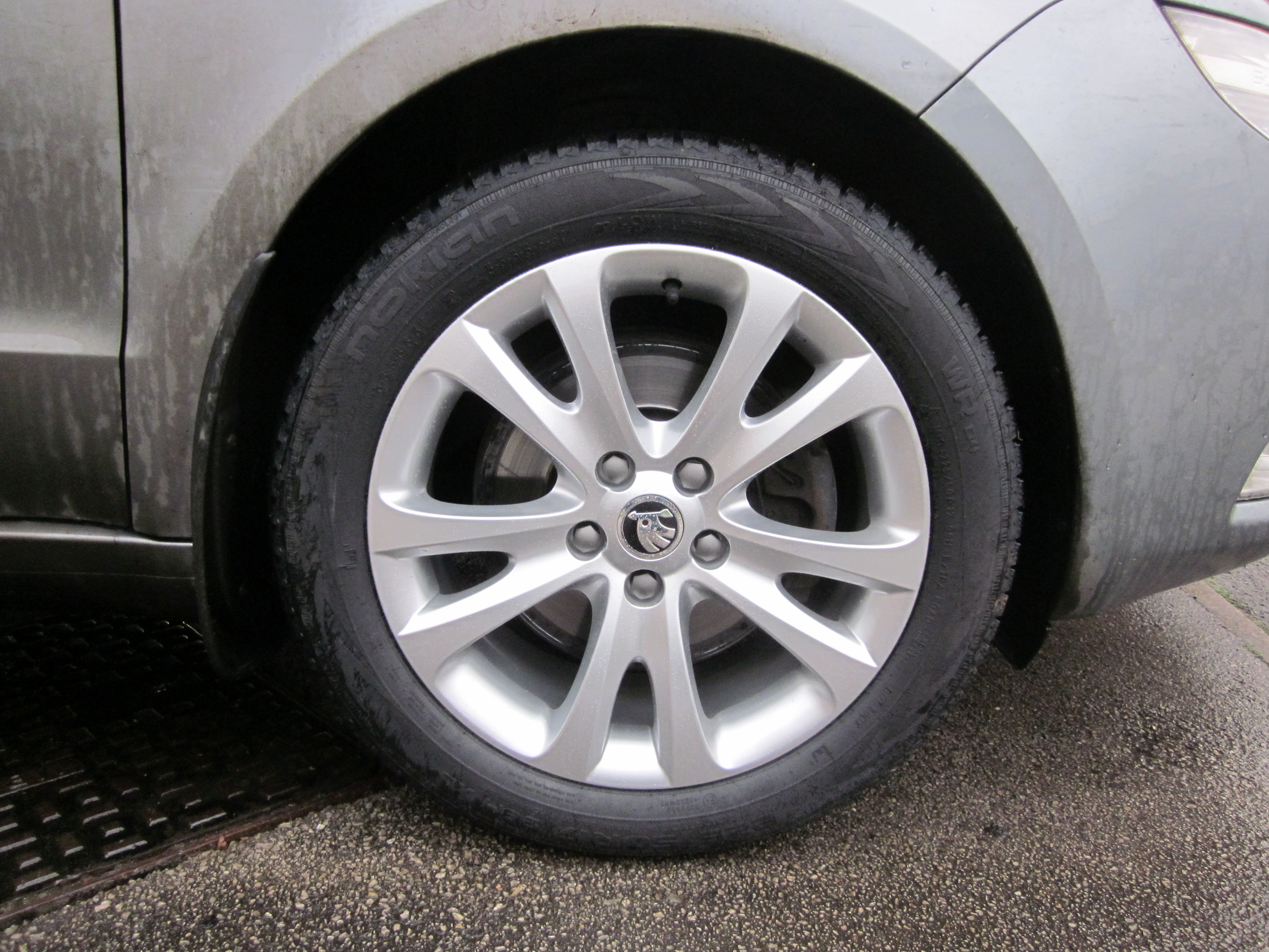

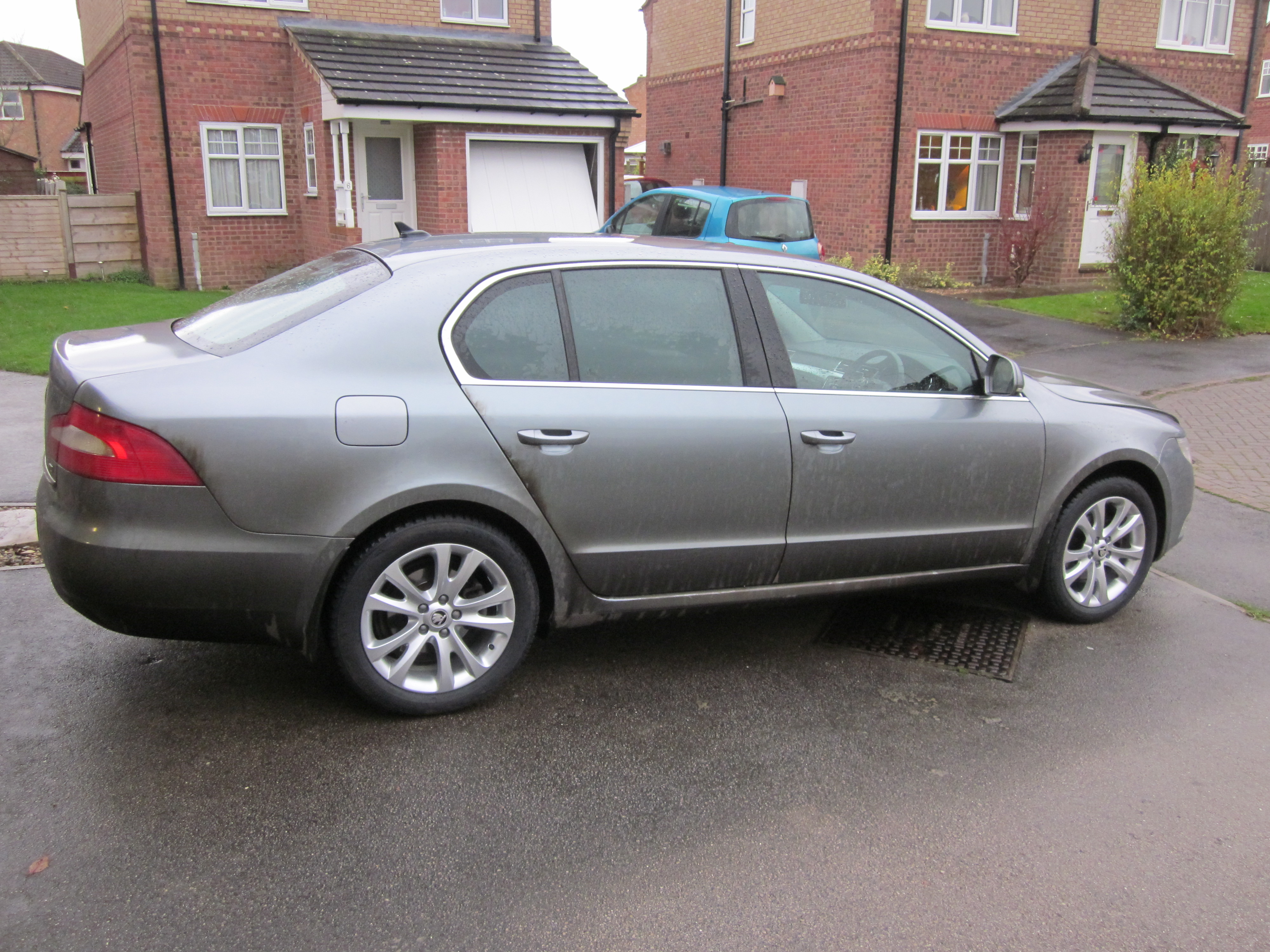

The bonnet is not fully closed on the first pic or is the bodywork damaged? By the way, I don't understand how you folks can drive on the wrong side of the car ... :D

They look awful for that age. I've seen ten years old tyres on some cars that look similar, but more irregular. My guess is it's either the design of the tyres that leads to that, or perhaps a manufacturing fault but whatever it is they don't inspire confidence do they. It'll be interesting to see what the manufacturer says.

Took the car in on my way home tonight, the guy confirmed that the tyres had failed due to them drying out. A quite common problem with winter tyres he says.
He's unsure of the process for logging the issue with Nokian though so will need to make some enquiries.

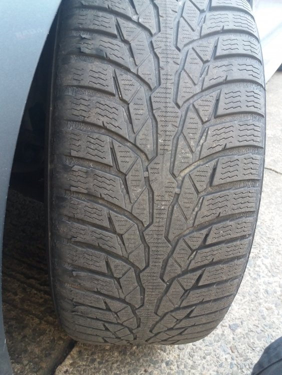

Saying that though, the fronts are about dead anyway, only a few millimetres off the wear bars, they're more worn than I'd realised. The rears have quite a bit more tread on them but are becoming excessively worn on the inner edge, my suspension alignment appears to be out and will need sorting.
Either way the tyres are dangerous and have to come off ASAP. Looks like the summers will be going back on earlier than hoped.
The guy got me to turn the wheels to full lock to get a better look at the full tyre which revealed that the inner edge is starting to deteriorate and separate :o
I'll still pursue Nokian though, the guy confirmed that this hasn't happened overnight, it is likely the failure of the tyre began well before I noticed.

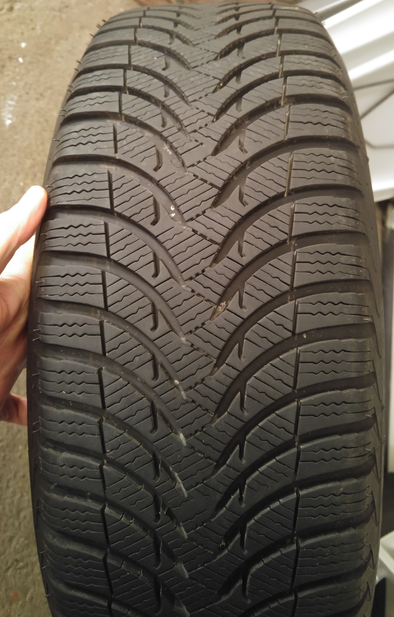

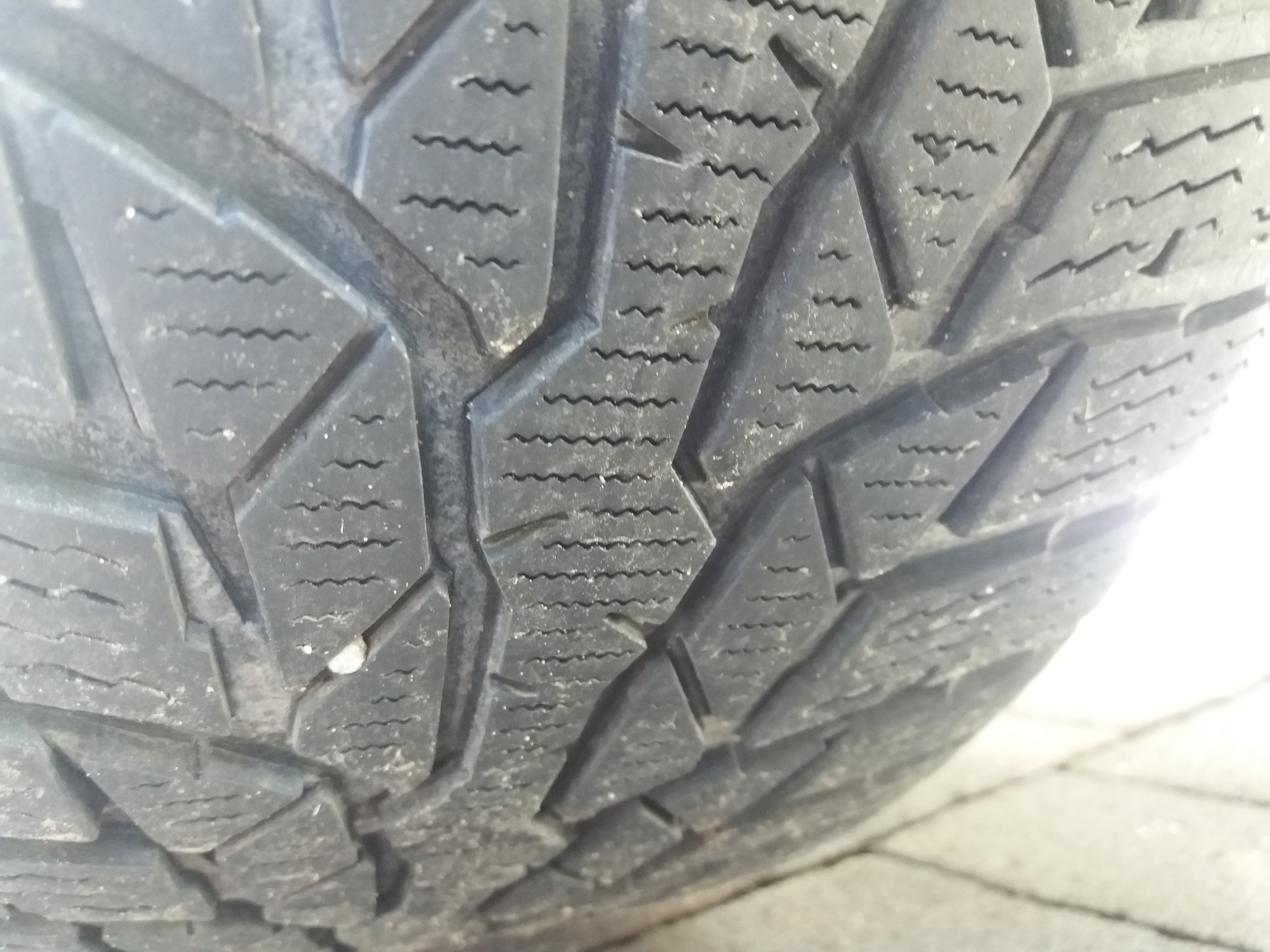

@Silver1011: Your tires look awful, surely not what you expect from tires only two years old. For comparison: This is what my Michelins Alpin A4 (produced in week 16 - 2011, so 7 years old) look like. Still look like new, no cracks at all!
