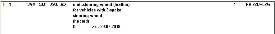

3V0 091 491 AD
Thank you for your feedback, I will look for heated steering wheel with DSG paddles and View multimedia buttons.

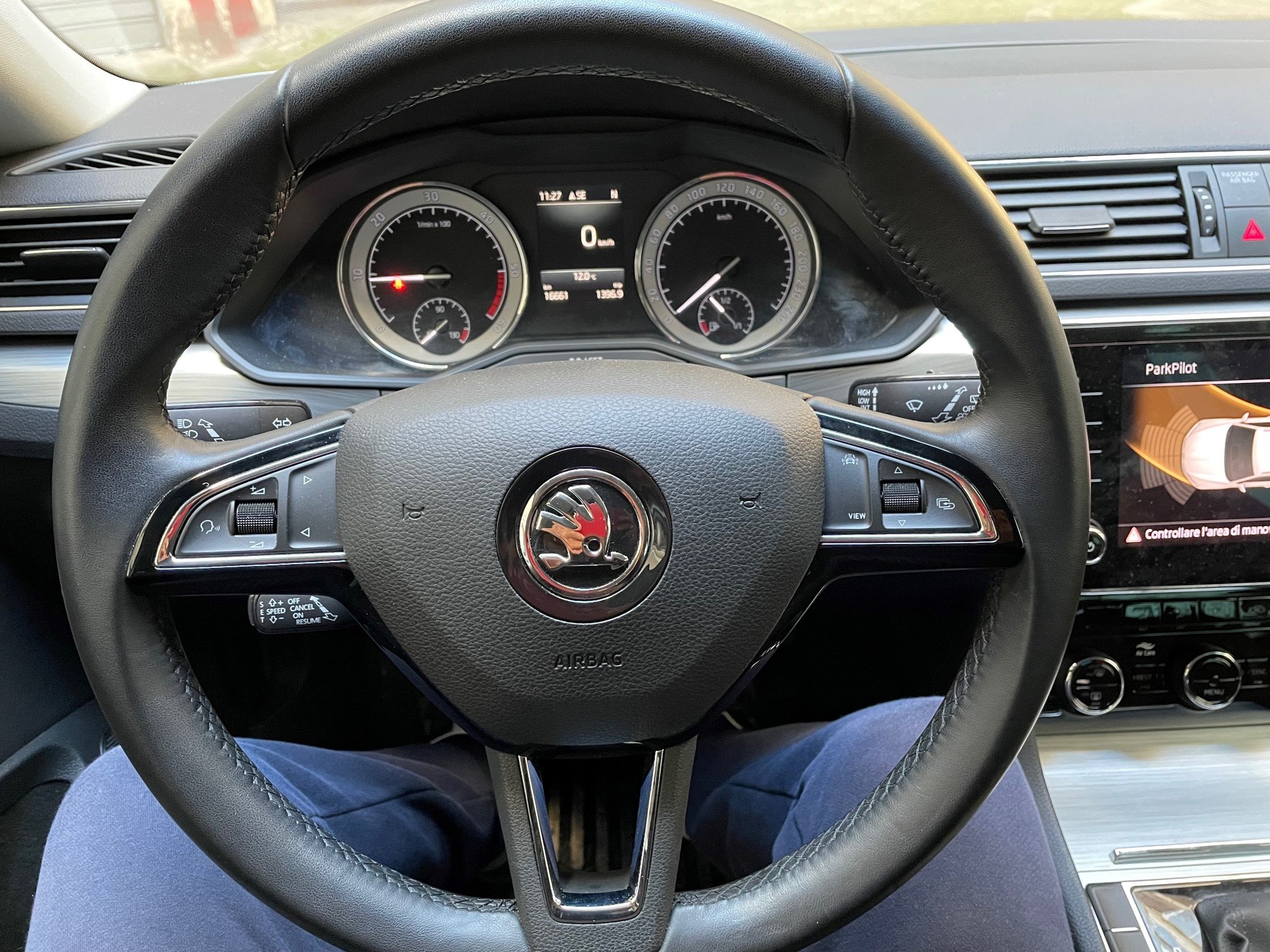

Dear Negko,
thank you very much for your help.
Finally I got a person able to give me the right info.
About button  view I think you are right. Today I did some checks and it allow me to move into the menu, so i think i have to buy also the buttons.
My car is the executive model, do you think the upgrade will be plug&play as per your car? Because this morning i went to a skoda official dealer with a friend and i ask info about this upgrade. They said it is not feasible because it is required to change the control unit etc.
