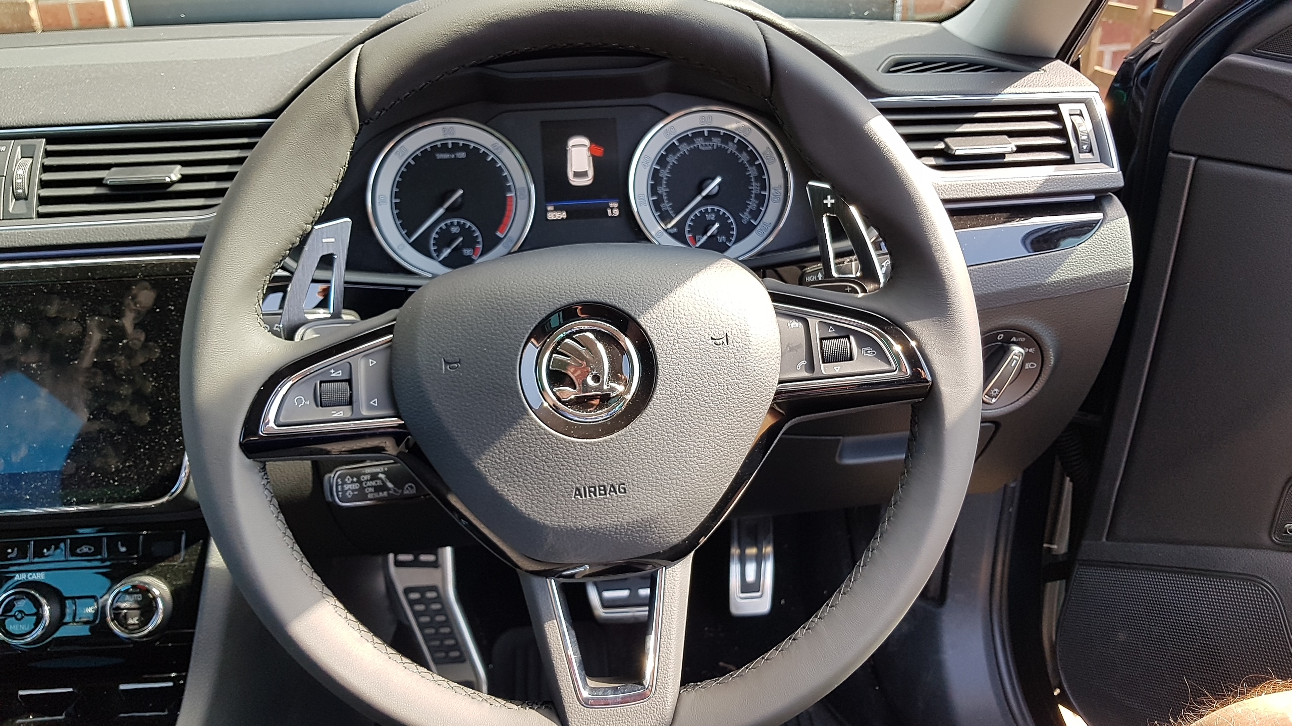

Just fitted mine, works a treat, fastest upgrade ever, no coding, just all the warning lights on after reconnecting the battery, quick whizz round the block, switch off and back on and all cleared! also fitted the Paddle extensions from ebay!

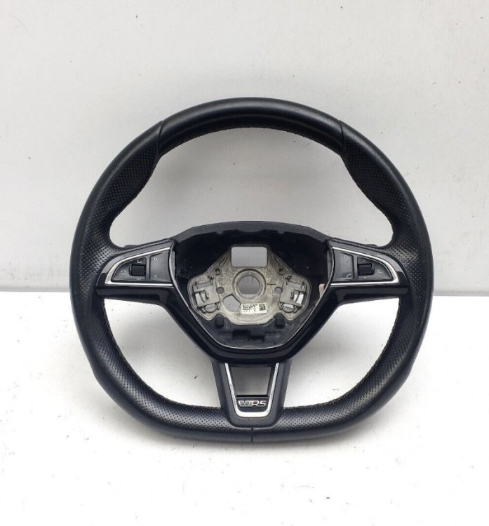

  • But the buttons will not work in the Superb, the buttons are very easily swapped over though (I have a vRS / Sportline wheel in my L&K) personally I prefer the perforated leather used on the FBSW:
  • Not correct! If you have MF st.wheel without paddles, your MF buttons on the st.wheel are not compatible with the paddles, as the car was not configurated with paddles and as the paddles are connected
I am ordering a new wheel soon to get this done to my L&K, are those extensions pretty solid feeling when you change gear? Do you have a link please? I keep coming across those pinalloy ones which look brill but far too much money/hassle imo

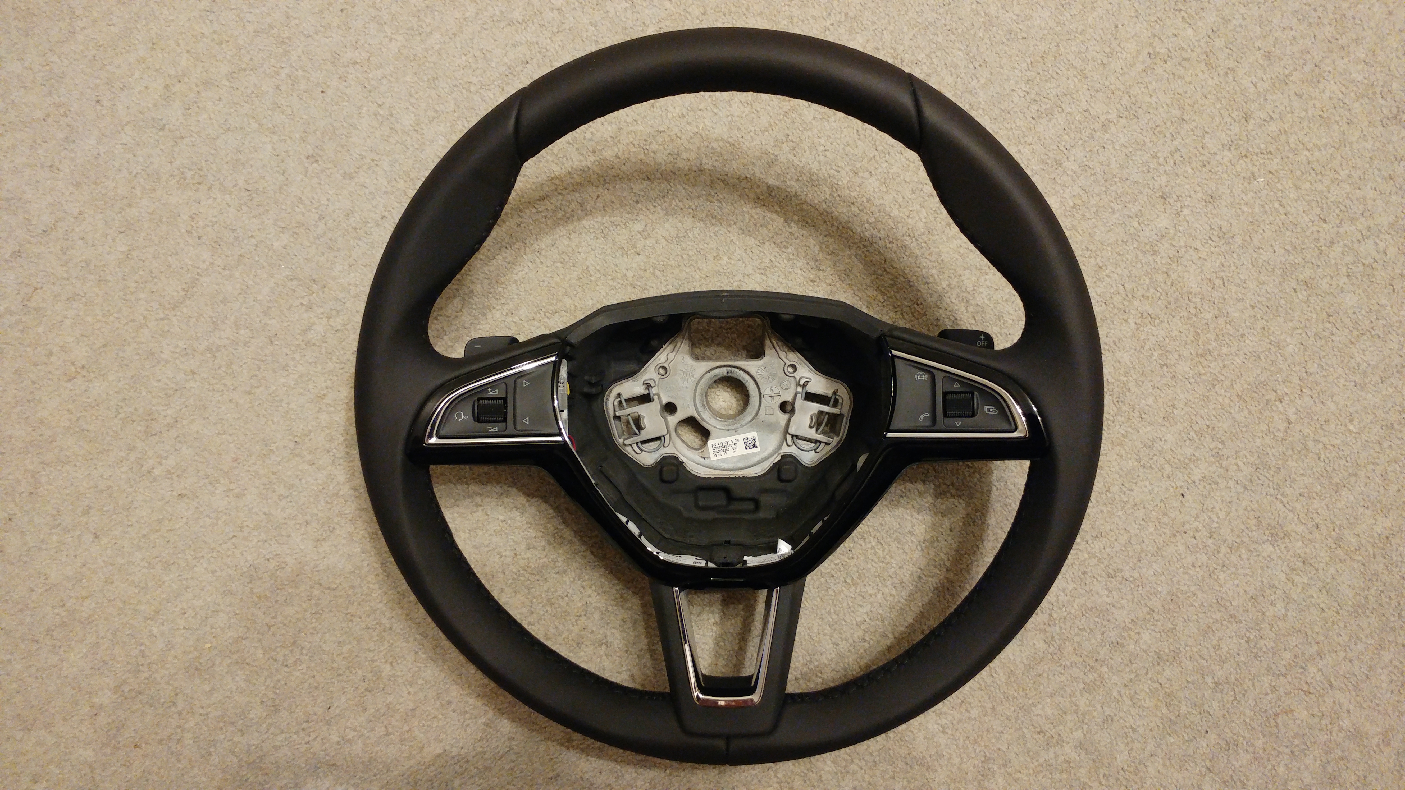

On 27/03/2018 at 05:37, Brimma said:
I've had my L&K for over a year now, and love it to bits, but I've always been a bit disappointed that it didn't have paddles on the steering wheel for the DSG, so after a hunt on eBay I sourced one from a 1000km Superb in Germany, and got it delivered for 159 Eu
I didn't want a vRS flat-bottom, so it is literally a paddle version of my own wheel
Yesterday I finally got around to having a go at fitting it myself, after the usual contact with my dealer said it couldn't be done
I did it by the book, using a scredriver at the back of the wheel to release the airbag, then disconnecting the battery and waiting about 20 minutes before removing it, then a M12 spline bit on the nut to remove the wheel itself
Lining the wheel up was pretty straightforward, as there are marks on the wheel and the spindle to assist
Then plug the airbag back in, reconnect the battery, and the job's done, no coding required
If I can do it, anyone can :)

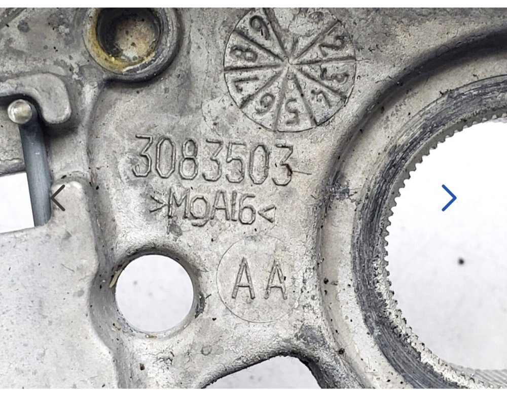

Could you please send me the steering wheel number? I can't see in the pictures.
Thak you! :)
Thak you! :)
They will all fit, I fitted mine in 2015 when they were only available from an Octavia vRS, I did swap the buttons over though (2 minute job).

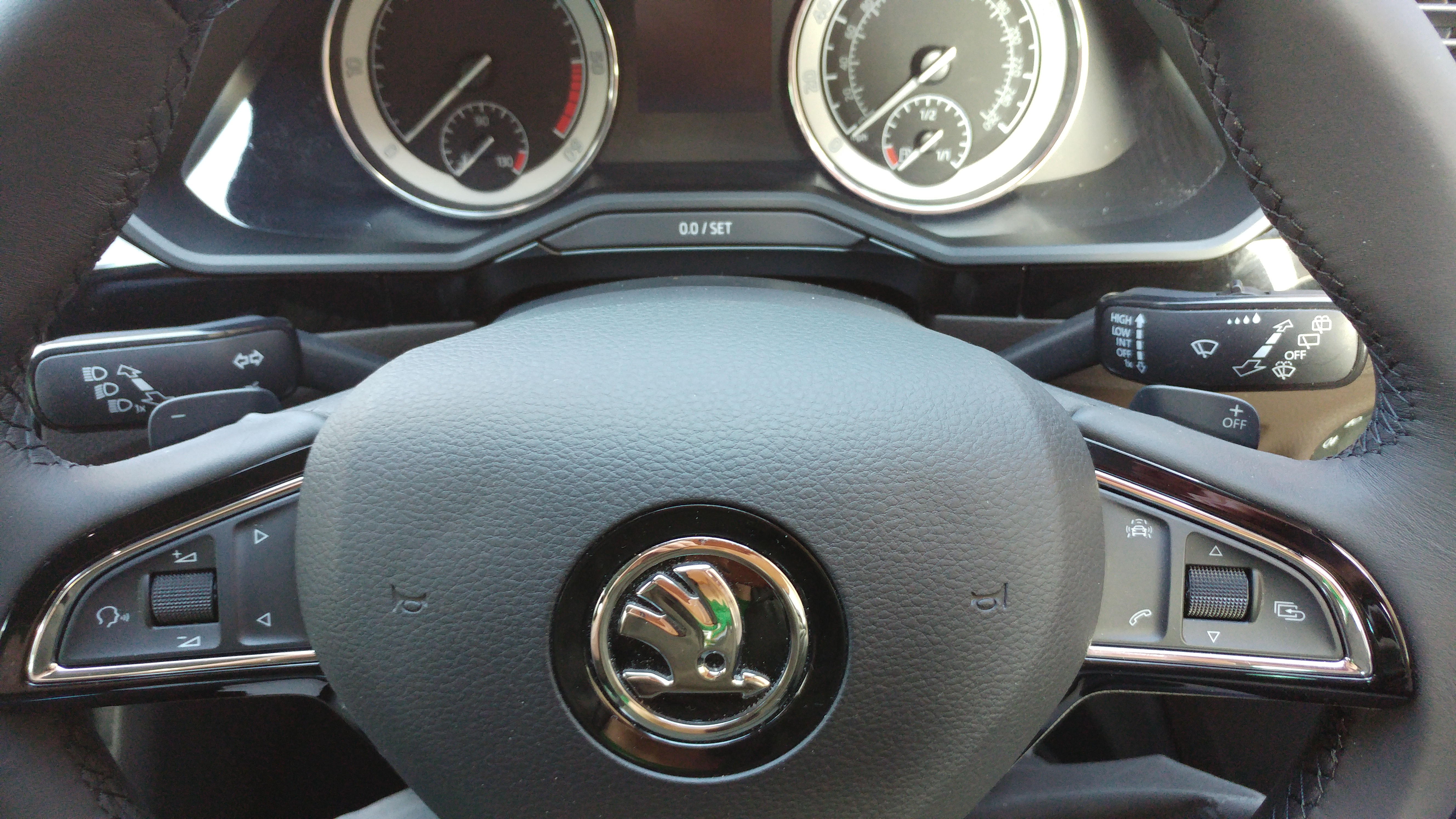

On 18/05/2018 at 21:06, Rizmod said:
I recently got a 2017 L&K 220 from Skoda stock but without paddle shifters.  Living out in the country with lots of windy roads, the DSG either selects too high a gear or, if in Sport mode, is too revy. Based on your posts, I bought a used steering wheel with shifters and did a straight swap, with no coding necessary.  The German dealer accepted a bid at 140 Euro + postage and I fitted it tonight.  The condition is as new.
https://www.ebay.co.uk/sch/i.html?_from=R40&_trksid=p4712.m570.l1313.TR0.TRC0.H0.XOrig.+Lederlenkrad+MFL+Schaltwippen+Skoda+Superb+DSG+Lenkrad+Leder+3V0419091S.TRS0&_nkw=Orig.+Lederlenkrad+MFL+Schaltwippen+Skoda+Superb+DSG+Lenkrad+Leder+3V0419091S&_sacat=0
i've never fitted any upgrade easier in my motoring life.
Together with the Motorsport 034 dogbone bush and Racechip XLR pedal box, it's like having my previous vRS back.  Just now I had a big grin on my face on the backroads!!:biggrin:

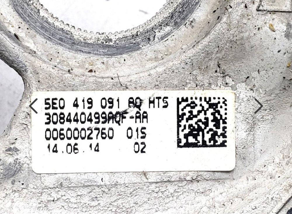

Hi. Do you know what is the oem code/number for this steering wheel? Or does it exist with flat bottom version? Does the Octavia and the Superb steering wheel have any size or installation differences?

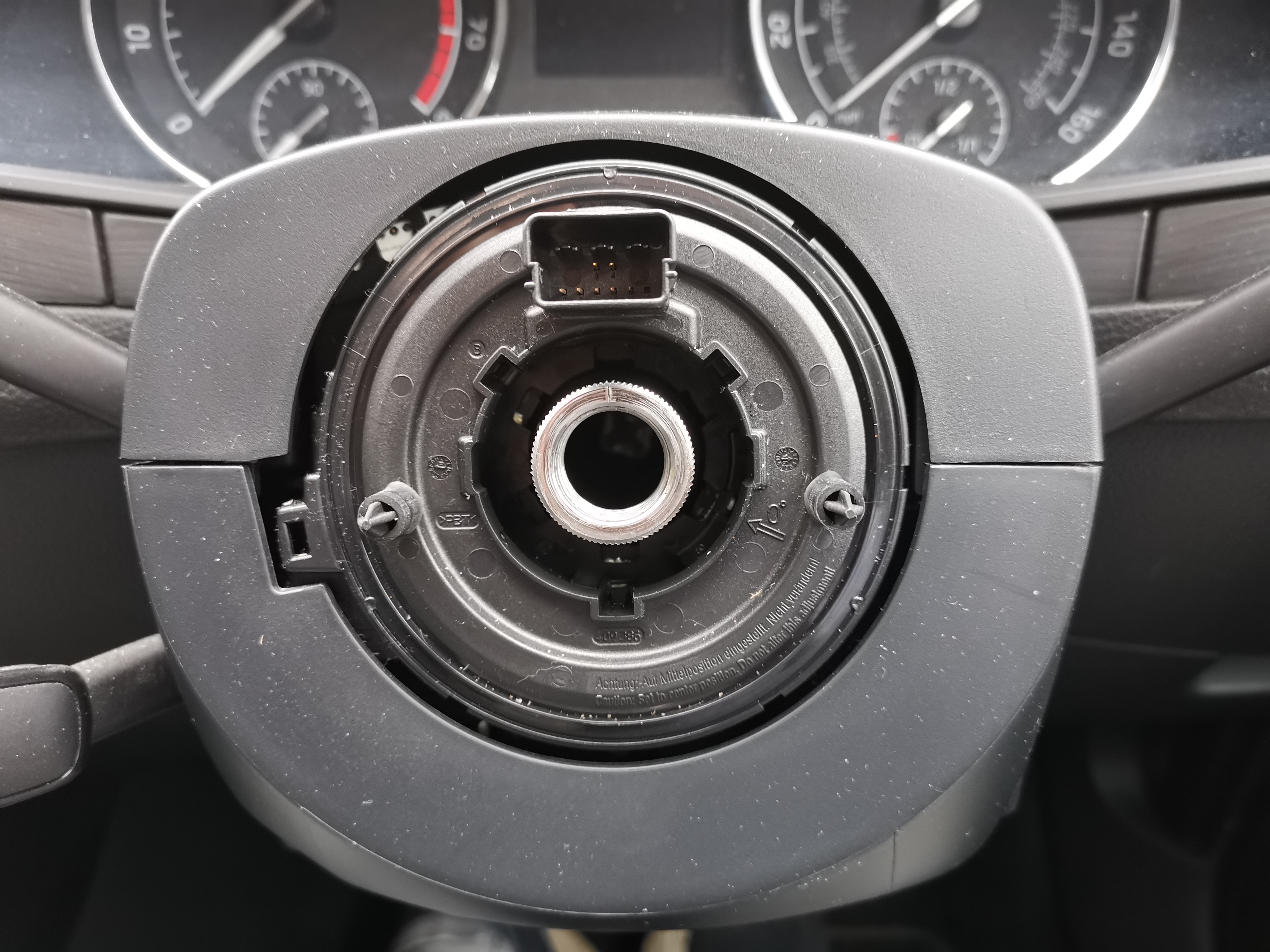

I'm thinking of purchasing a paddle shift wheel with heater element. Is the airbag identical between the variants or do I have to purchase a new airbag? How about the center piece which transfers the electrical connections to the wheel, which is the correct part? Any part numbers?
I think you'll need a new clock spring mechanism (in the steering column), in addition to the new wheel with heated element. I think the airbag itself will be standard across both heated and non heated variants.
Does anyone have part numbers for the clock spring mechanism? Any additional wirings for the heated wheel or changing completely to a different wiring?
I think, with a heated steering wheel you also need a new airco panel. The steering wheel wiring needs to connect to that panel. I looked into it once, but concluded it was a too high investment.

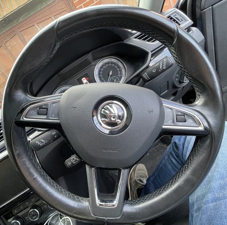

You are correct, I just swapped mine for a heated version, airbag was same, however the new wheel has an extra wire for heating, and the 'clock spring' black round plastic bit on the hub that houses the connector for the airbag doesn't cater for it. Let me dive into etka 8.3 and find out what the correct part is, and then I guess I also have to figure out what retrofit wiring I need to run from the hub to (the aircon panel?)
