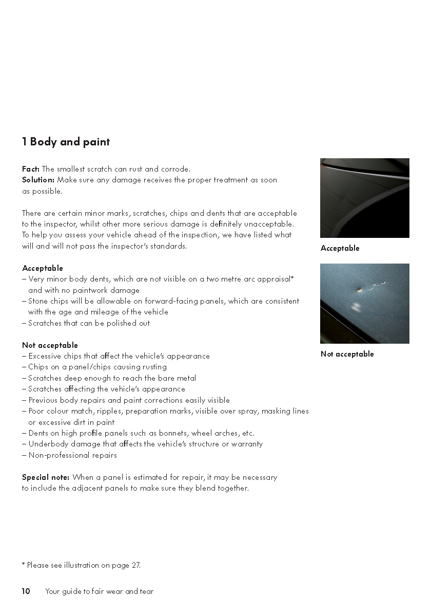

If on PCP be very careful what is the accepted outcome & have a good read of this. Its VW Fair Wear & Tear.
Peeling Paint is not mentioned - this would come under manufacturing fault.
Excessive stone chips would be liable as customer responsibility.
When we Voluntarily Terminated (VT) our Citigo it was treated to full wash, luckily no scratches. Vacuum it inside & out. Took plenty of Photo's before handing it back to dealership.
If PCP VW finance? so it will fall under this guide. If trading for another car dealership might be 'more lenient' to you maybe, tell you its ok etc...
But ultimately someone from VW finance will try bill you further down the line, once the car fails the inspection.....
VW_Fair_Wear_Tear_Guide_v3.pdf
