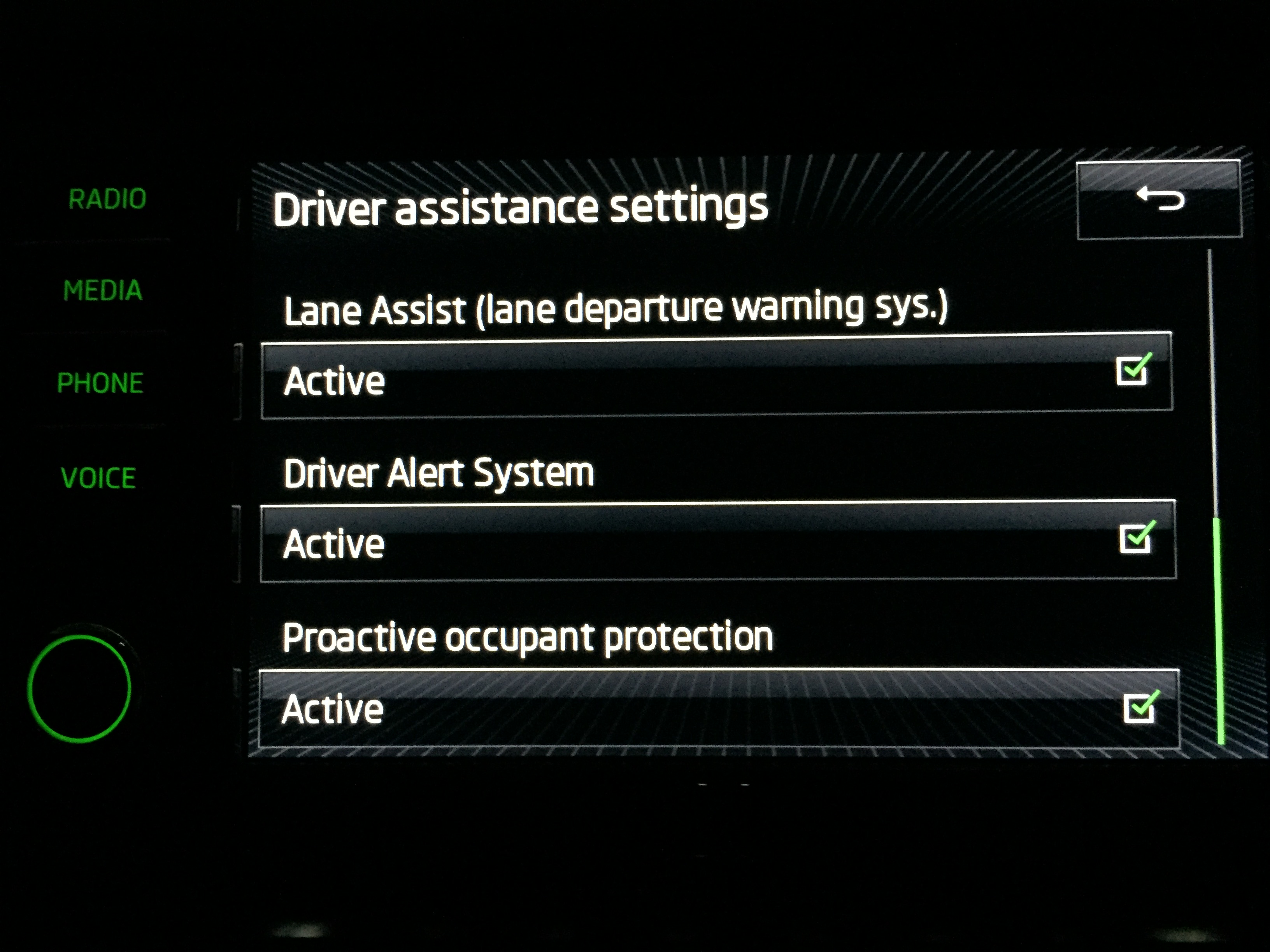

If I go into Car-Set Up - Driver Assistance, this is what I get (see photo). Am I missing something?
Excuse the dusty screen - it's in direct sunlight (rare for NW UK!)
I have two options under lane assist; Active and Adaptive Lane Guidance. Looks like you might not have the ALG which does the bits I described that you expected yours to do.

That’s very interesting ahenners. Mine is a newer model (2016, I’m pretty sure) but it seems it may not have the functionality of yours. If ‘Adaptive Lane Guidance’ is what causes your steering wheel to react when you forget to use your indicators, what exactly does ‘Lane Assist’ do?
Yeah, that’s not how it appears on mine. Mine is like ahenners car with adaptive lane guideance seperate to lane assist. You should feel the wheel resist you when you try to pull out of lane without indicating. You can change the sensitivity on VCDS or OBDEleven.
Thanks SachaGrace, but I have to ask you to elaborate ... VCDS or OBDEleven? I have no idea what they are. [As an aside, Im pretty sure I don’t have Adaptive Lane Guidance because it’s not permitted by Australian vehicle design rules. ]
