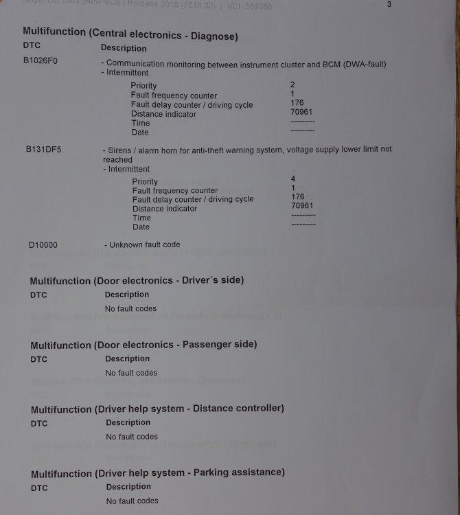

I had a diagnostics done yesterday to see what it would pick up re-this overheating and was 'disappointed' that nothing showed up. So at the moment all I have is that is that a warning was screeming at me and no evidence of it . I would have expected the diagnostics to have a record of this - but nothing is there.
What would have happened had I carried on driving, as I did, and then caused damage by doing so.
Would there be no evidence of of the ignored warning?

I don't want to confuse things but the point I was making in the previous post was - given that there is no record of the warning, If I had driven on to cause damage how would it have been shown that I did so negligently. DSC04559.thumb.JPG.4677373bc2e3d9567d3bcc5a99cc7f2a.JPG

I get what you are saying completely. Technician will not be able to confirm the fault other than if it happens at time of workshop visit or through experience/brand knowledge. The slider is activated by a solenoid valve and my guess is because the solenoid valve still is activating/working(it’s the seals inside the pump that deform causing the problem) the ECU won’t recognise an electrical malfunction and won’t bring the EML on. Thats the only way it makes sense to me! There may be a particular measured value block that can read last engine time engine temp went over 90c but I wouldn’t know without looking.
