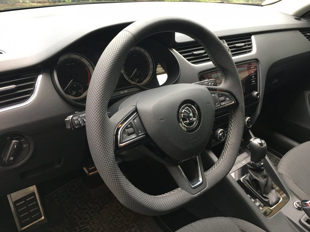

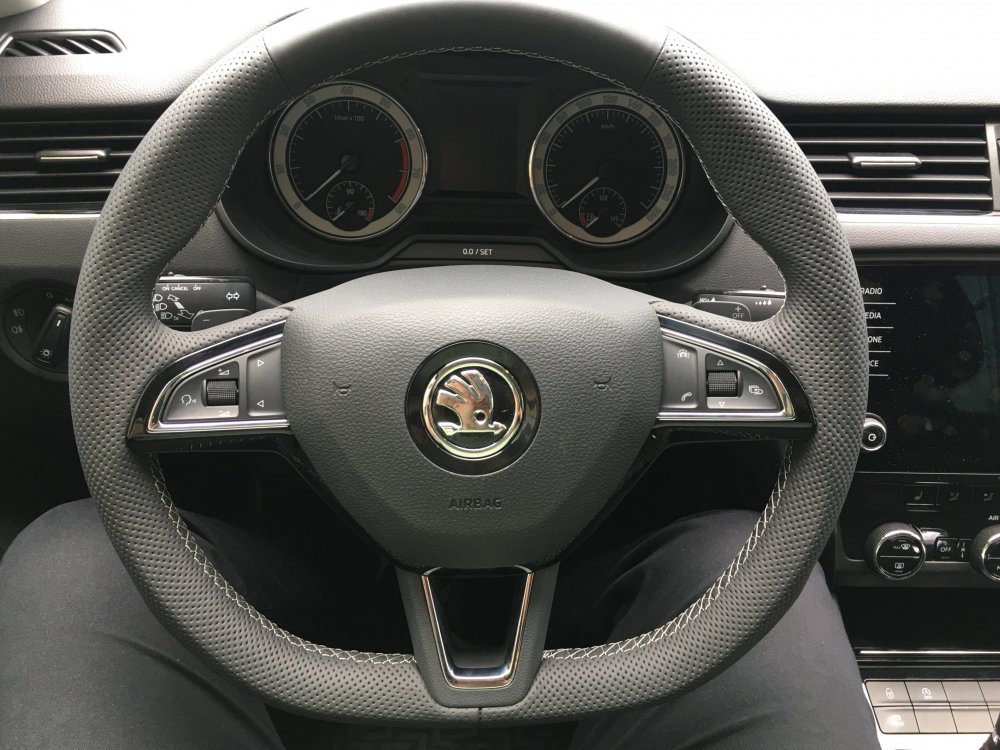

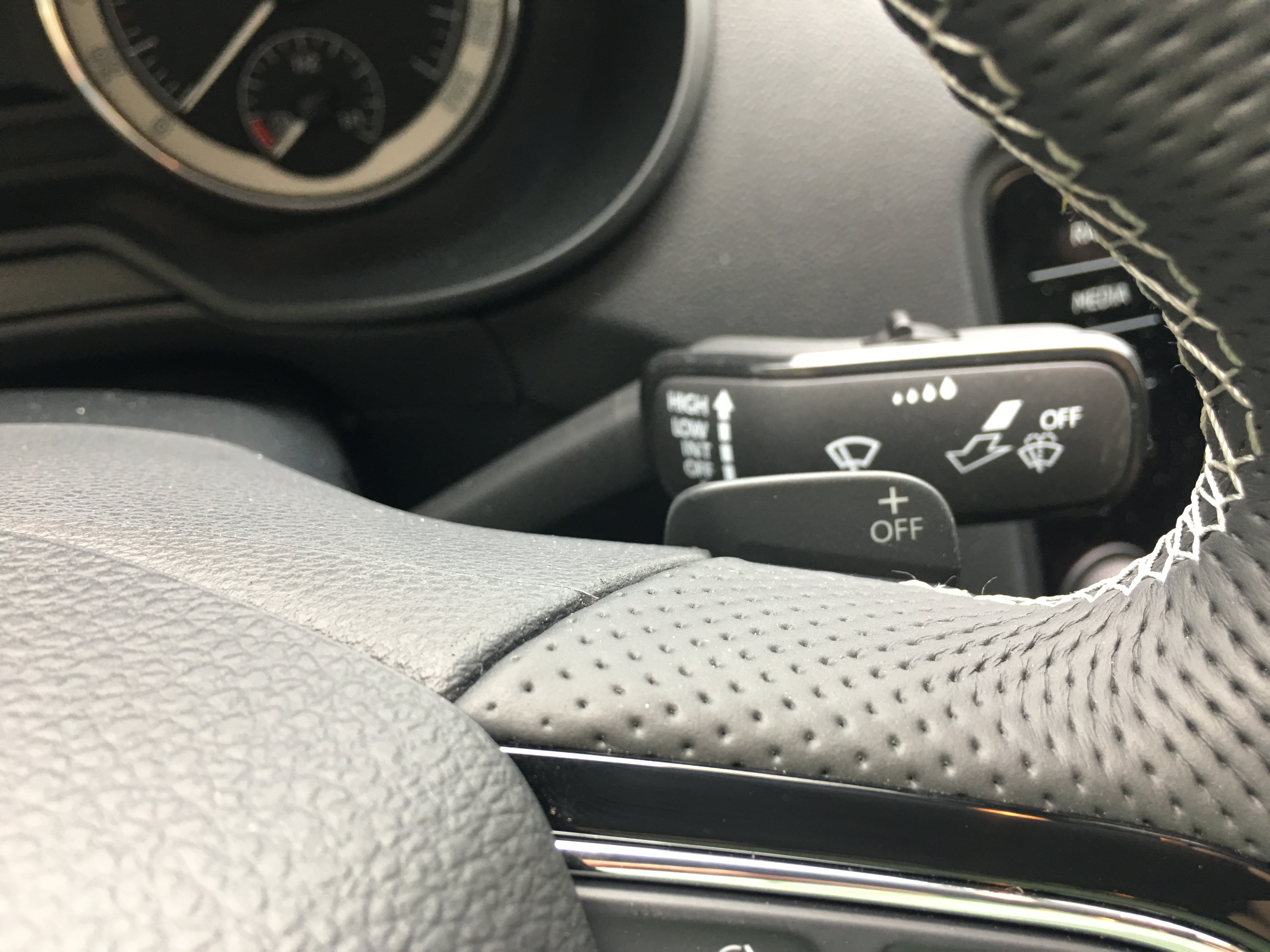

Had no patience, so order placed :)
I'm thinking that the worst case scenario, the paddles will not work. The rest (airbag, multimedia buttons) hopefully will match.
