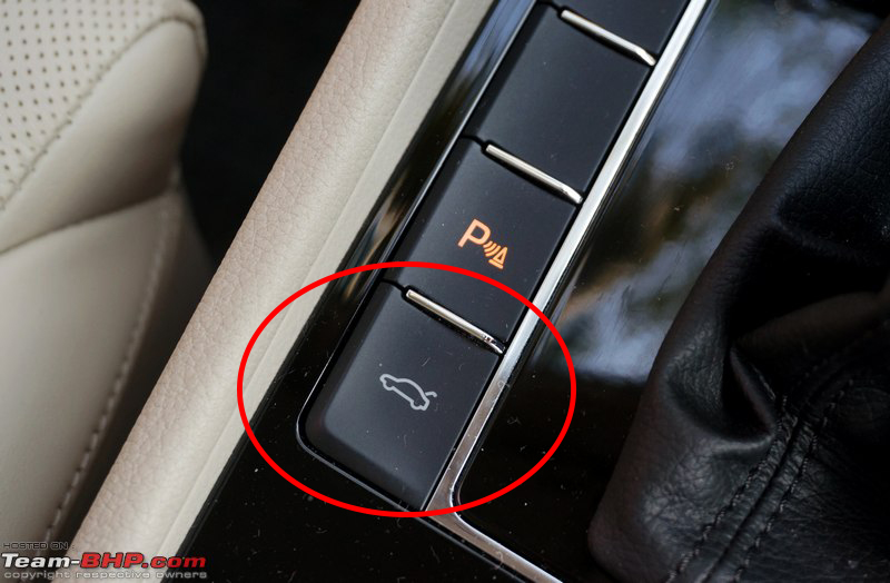

@Superbstu But do the boot opening button next to gear knob work? And how about virtual pedal?
Thanks for you reply, my car doesn't have either of these buttons.
You dont have a button like this?
Do you mind if I ask, what country do you live? I thought that tailgate opening from inside comes as a standard.
I have Kessy Estate car and I can open tailgate with virtual pedal and from centre console in cabin but not with my key fob. Figure that one out.
I'm in the UK, and no I don't have a button like that but mines a manual opening tailgate.

lol.....that would explain why @Superbstu doesn't have the console button, as per the pics in the previous posts!!!
unless Superbs without power tailgates don't have this centre console button either!  then u can scratch my comment above :)
I have a hatch with kessy, without power tailgate and there is no such button in the console or anywhere else. Actually, you cannot release the mechanism that holds the tailgate with any way other than pressing the button that is on the tailgate itself. You can lock it or unlock it but not open it. If you are outside with the keyfob you unlock it the moment you push the button to open it. If you are inside and the tailgate is locked (like if you were moving and stopped) you have to press the button that unlocks the doors for someone else to open it or you can get out with the keyfob on you.
