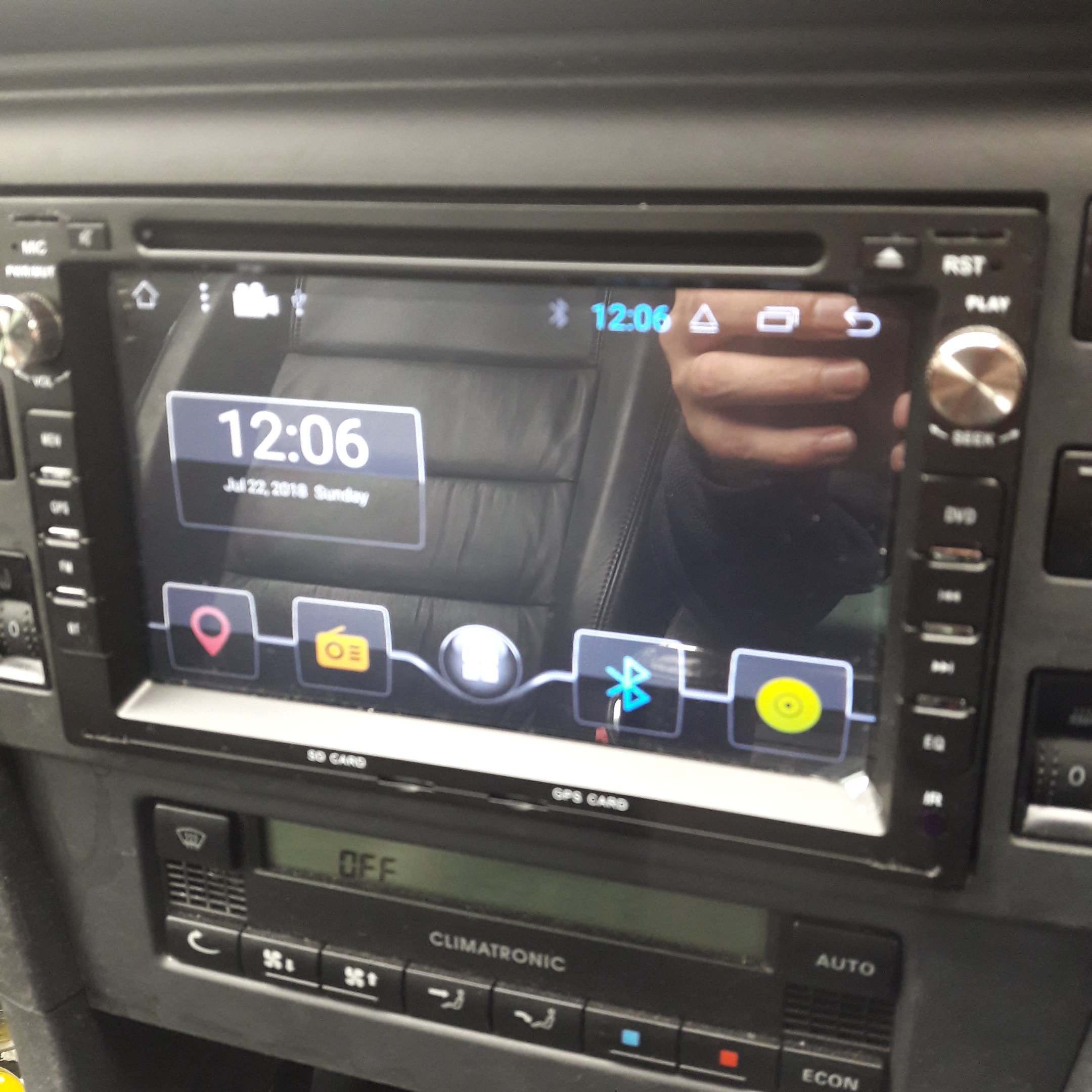

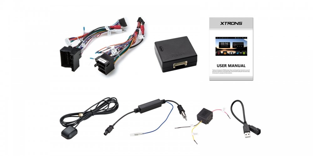

This is the unit I bought, wires that came with the unit and back of the unit.
pcd77mtw-300.thumb.jpg.2e3c36db90041d1e8b1eea123331c2be.jpgpcd77mtw-8.thumb.jpg.09e1f8733885a49629616ca3e0864e30.jpgB0835386424.jpg.0b94ed7d6573aaf4e586b97c8154b6a6.jpg

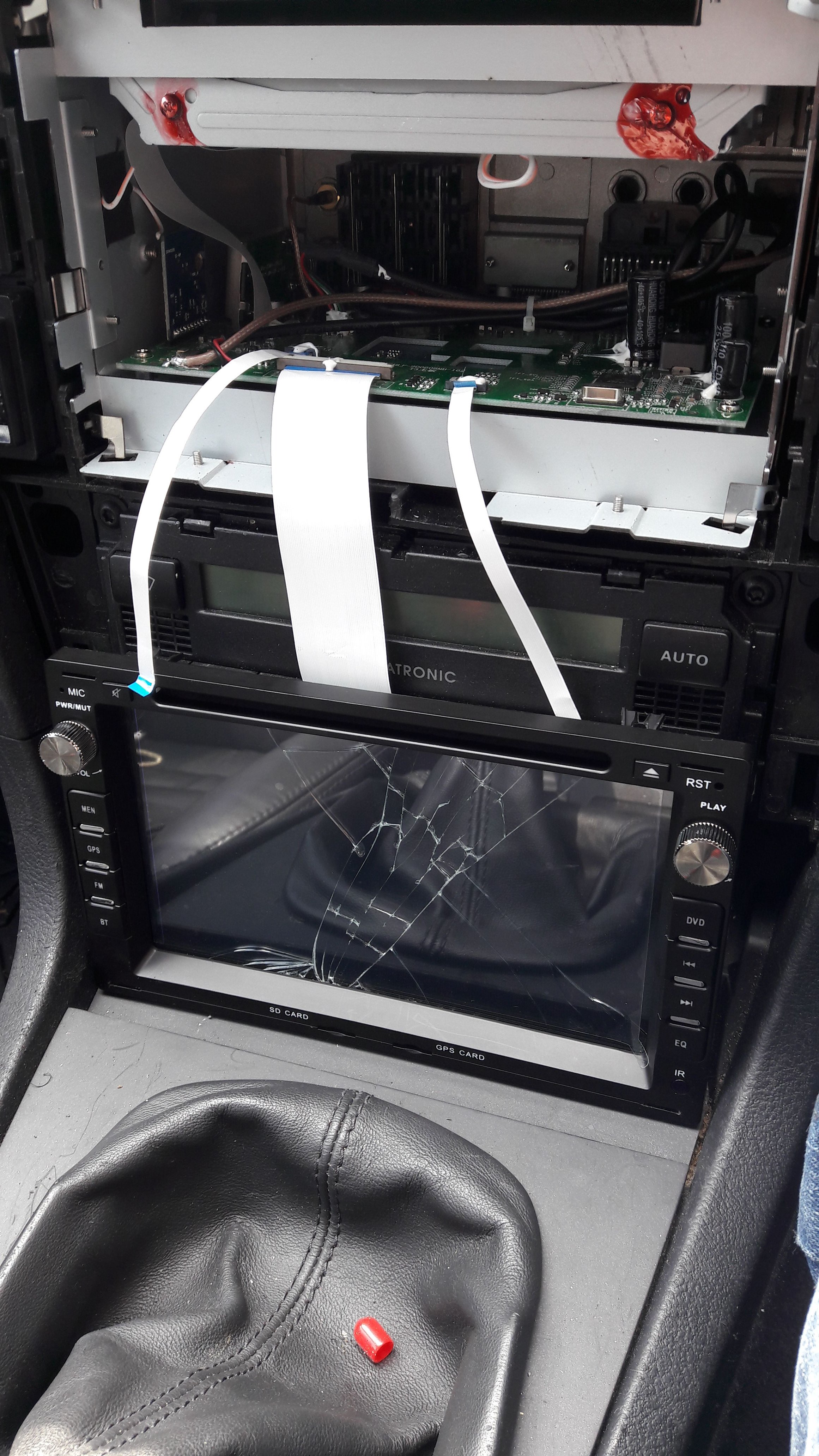

Bit of an update. This is what happened when I forgot to earth the unit.
I pulled the unit when I thought it was released from the console. It wasn't and the screen hit my gear stick and cracked.
I have sent audio visual tech an e-mail asking if I can replace the front screen on buy a new unit.

Ouch, hope they can sort you out.

That will be the one you want to use, the other one is for cars which come with the newer quadlock connector. This allows the radio to be plug and play with a greater range of vehicles, especially when a model got upgraded from one to the other half-way through the models lifetime.

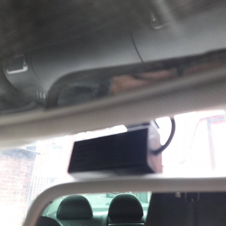

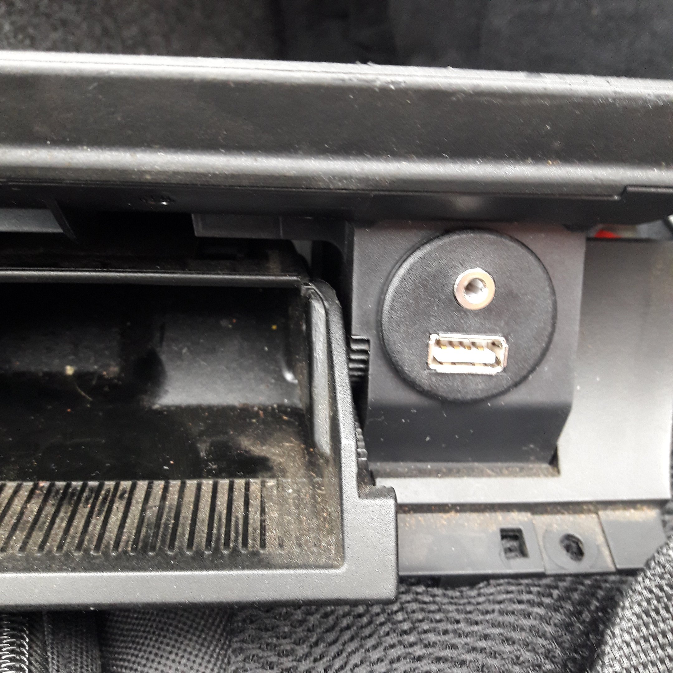

Few pics of bits of progress here folks

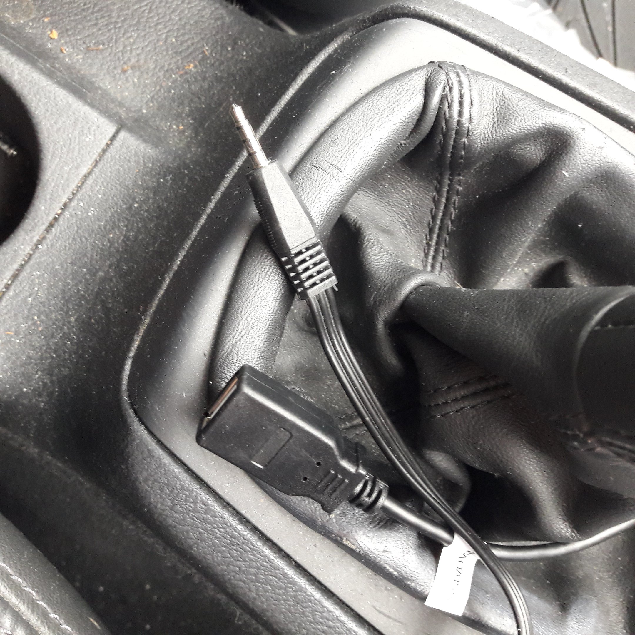

Unit installed, dash cam installed, AUX and DAB Radio USB cable (this is the one that I am going to put the splitter on for a double USB cable), AUX and USB (Charging only) in the 12v lighter socket.

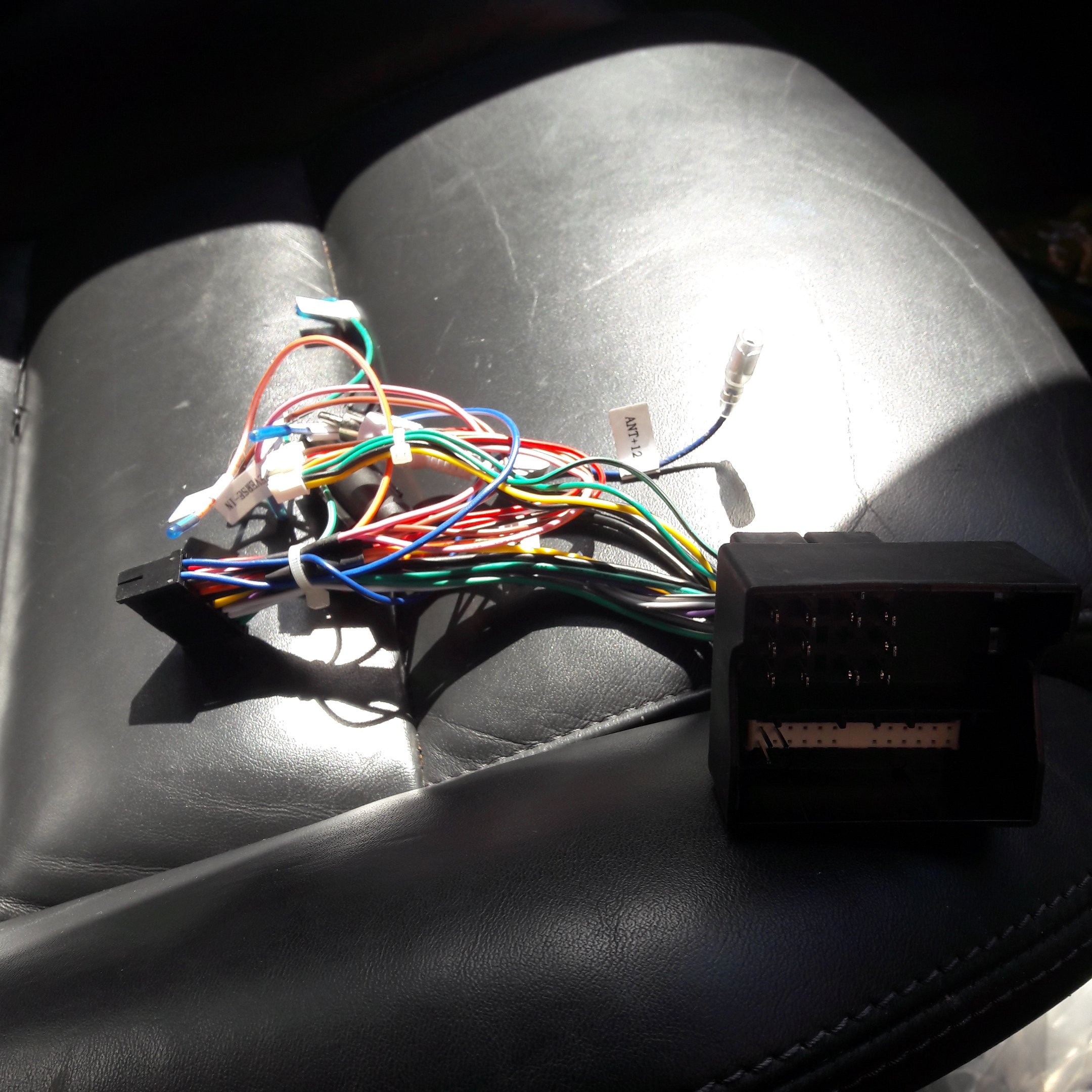

Pic 1 is the second wiring loom that came with the unit (don't know if it is any use to hook up the multi function steering wheel controls)20180728_125730.thumb.jpg.4c36d39363a5dcc3b5bac734ea468587.jpg

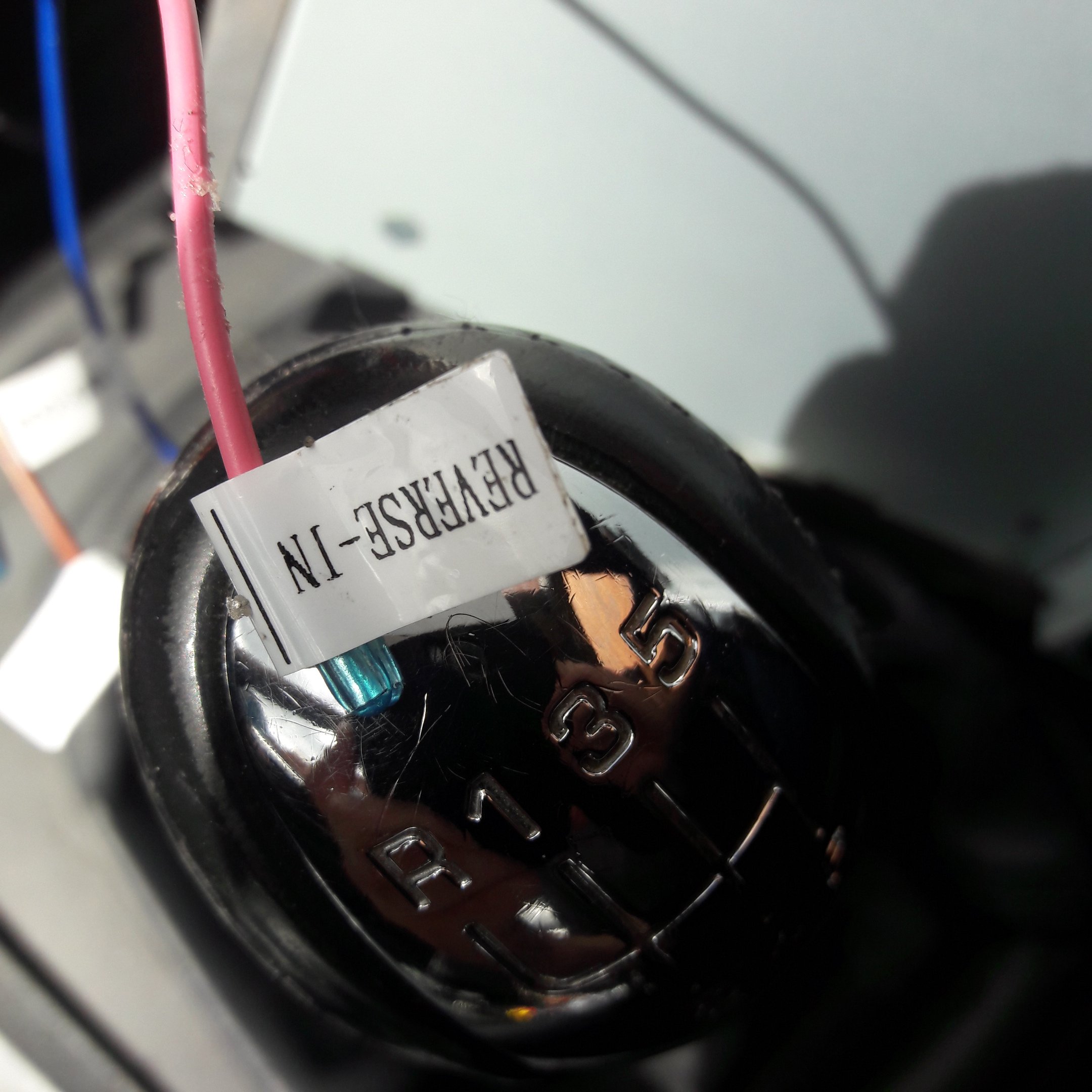

Pic 2 is labelled reverse in (reversing camera power???)20180728_125049.thumb.jpg.57a2d0f2a8a4d53dbfe0b084e8cdadfc.jpg

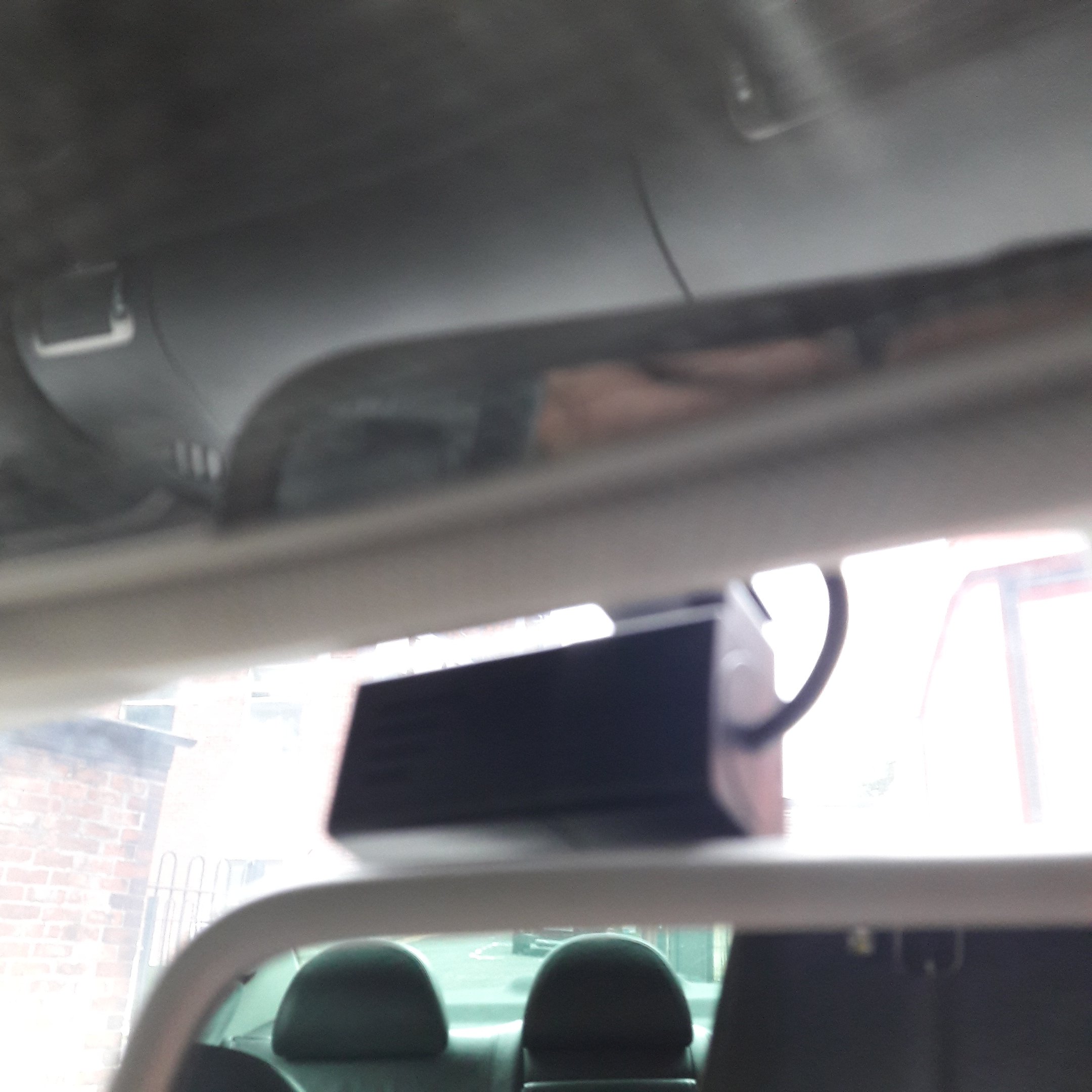

Pic 3 is the reverse camera wire that has been run through the car hidden in the cars trim into the boot. (The other end of the wire has the same yellow plug and red power wire) The one in the boot needs to be connected to the reverse lights. I'm guessing the other end of the red wire needs to connect to the reverse in wire in pic 2. The other end of the yellow wire is already plugged into CAM in the back of the stereo unit.20180818_084532.thumb.jpg.99084d0976f72ac41f70eee860d1edd0.jpg

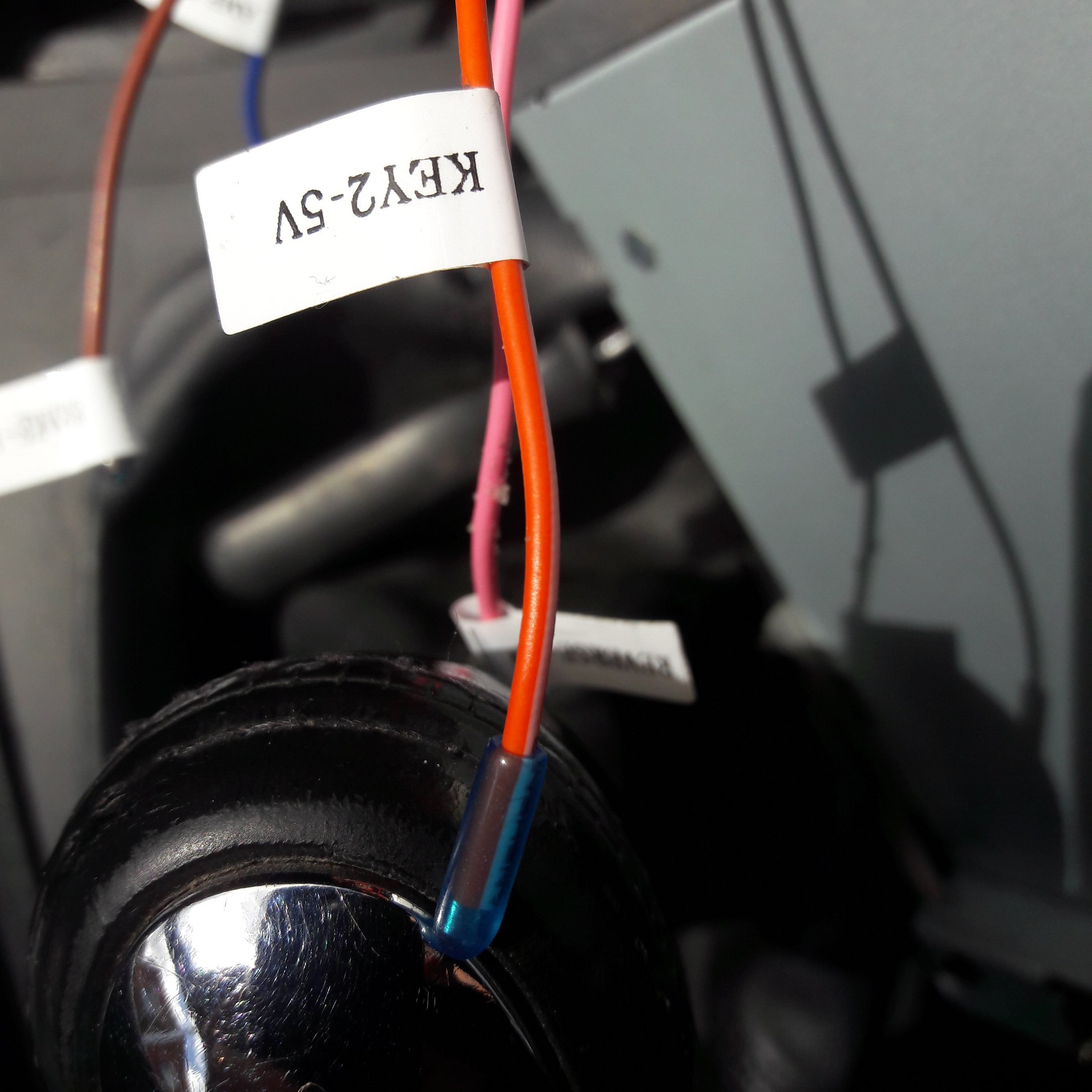

Pic 4 is KEY2-5V.  I don't know what this is for20180728_125036.thumb.jpg.2a8275fd1b73d5b80057d3f839c1f98c.jpg

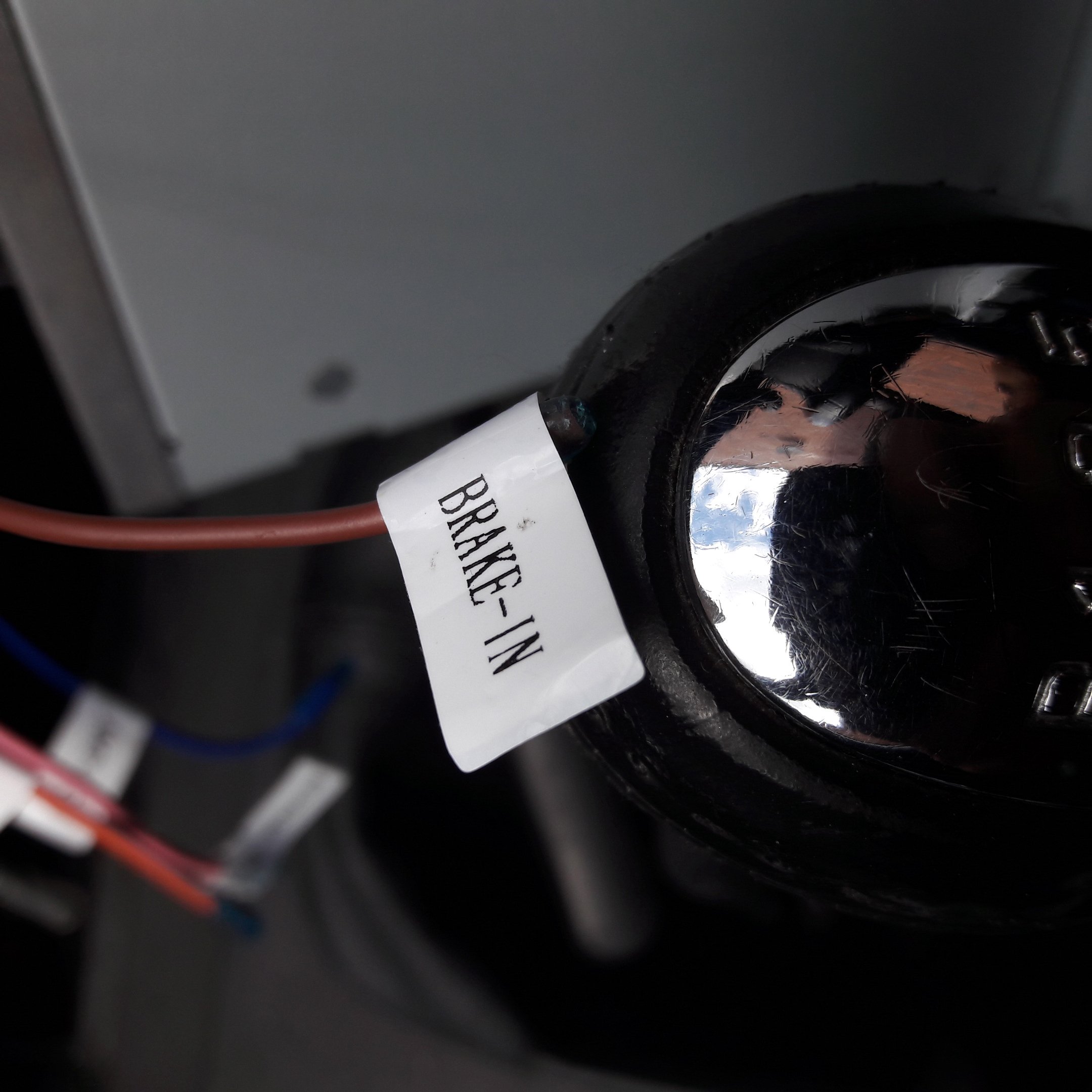

Pic 5 is BRAKE-IN. Again don't know what this is for.20180728_125006.thumb.jpg.358b27929f15a7983756a8eacdb63c7f.jpg

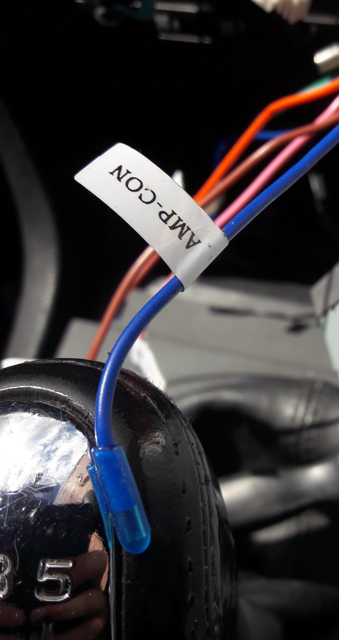

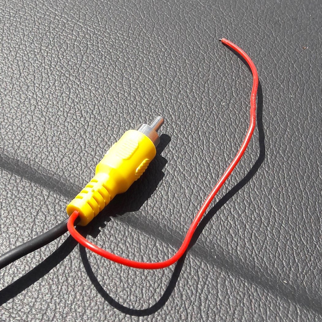

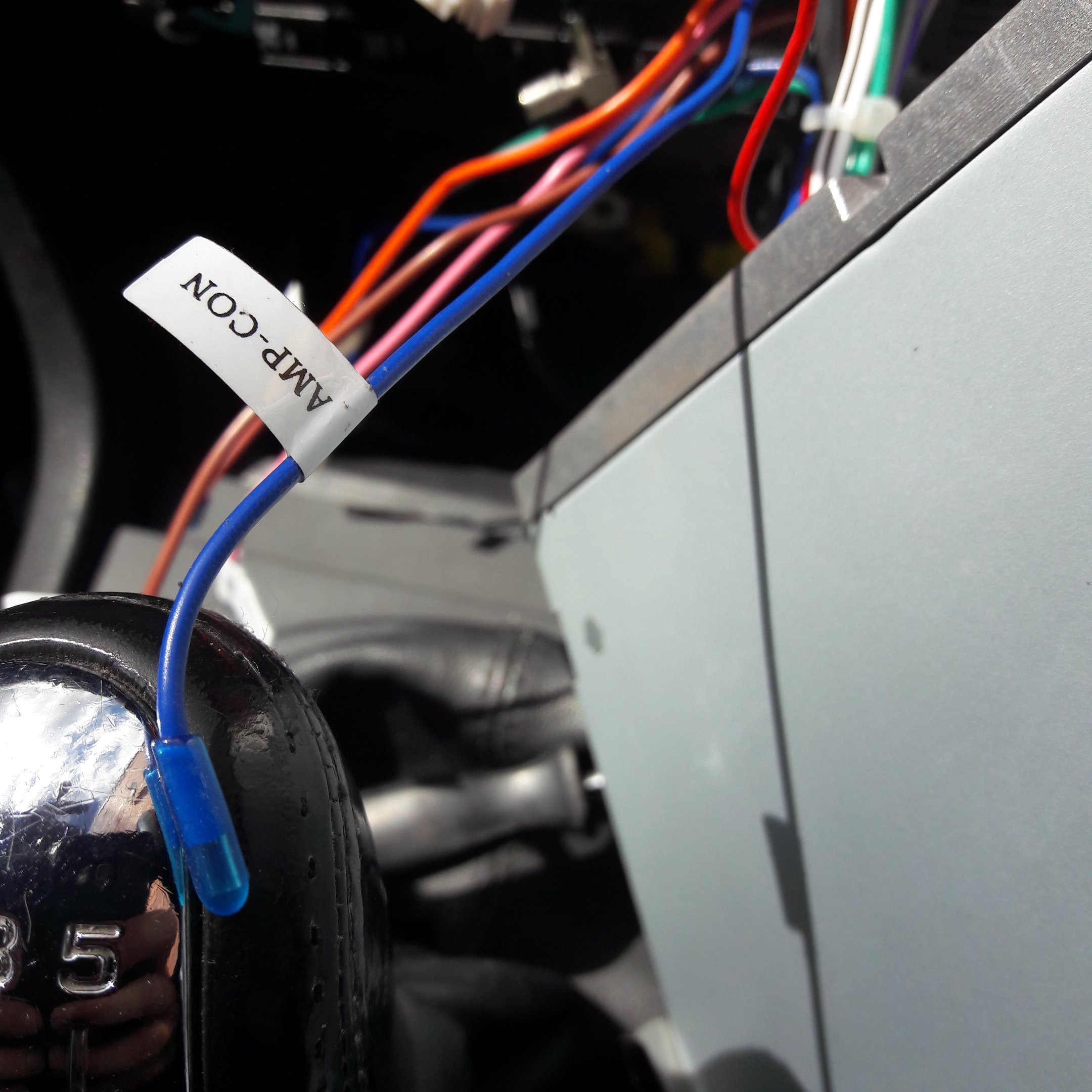

Pic 6 is AMP-CON (Don't know what this is for)20180818_100209.thumb.jpg.05104ce411513294e3d3477d26350c89.jpg

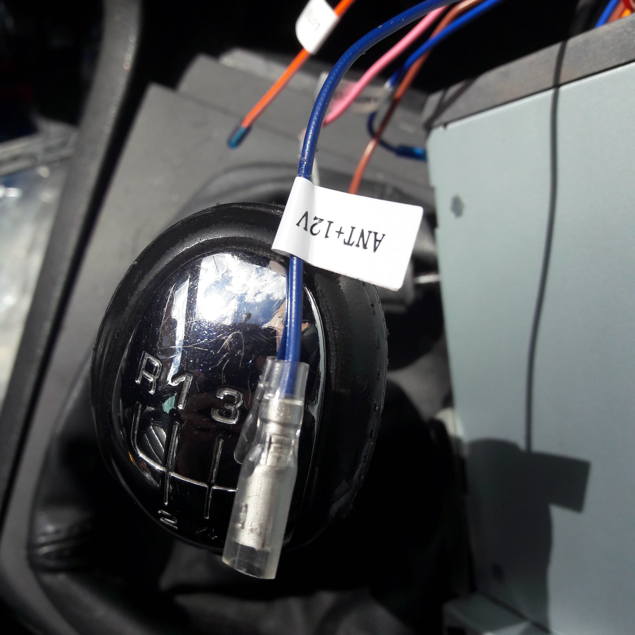

Pic 7 is ANT+12V (I don't think I need this as I have bought a new ariel which I can also connect the DAB USB stick to)20180728_124849.thumb.jpg.c531434e00ee392df40f71fc8bc7db7f.jpg

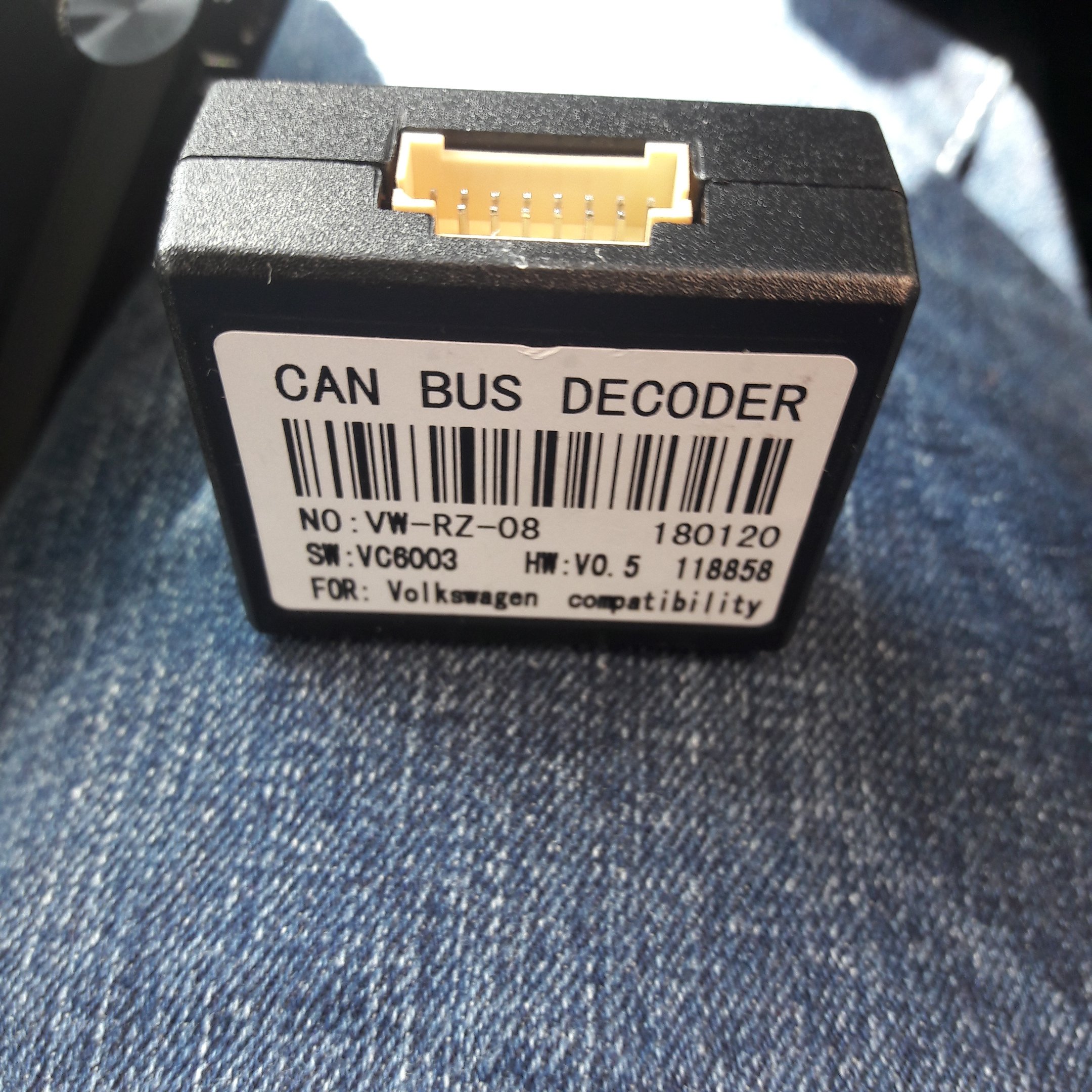

Pic 8 is CAN BUS DECODER

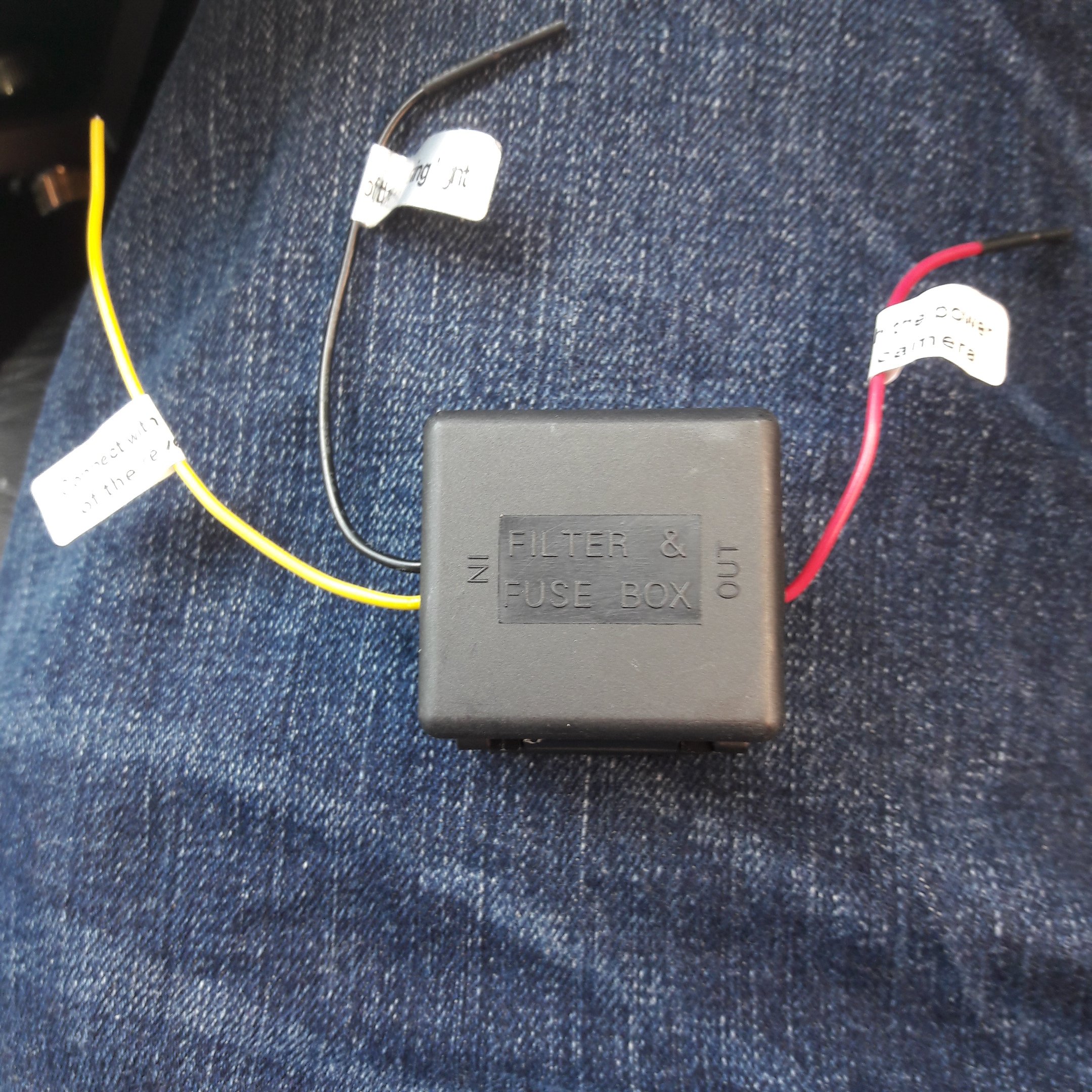

Pic 9 final pic is CAN BUS BOX (I think???)

Pic 1 is an alternative loom with a quadlock/fakra connector. It is to be used if you were installing this in a newer car which uses this instead of the iso connections that are present in your car.
Brake-In: Can be ignored, but intended to receive  a signal that the handbrake is on. Useful if you want certain actions disabled unless the car is stationary with the handbrake on.
Reverse-in: run a wire to the reversing light, it'll let the unit know the car is in reverse and enables the rear view cam. Personally I'd run a dedicated wire, and use the wire with the yellow rca plugs (pic 3) only for the camera signal. ignore the red wiry bits. The camera itself can always be powered from for instance the reversing sensors or the lighter socket in the boot.
ANT+12v: For powered arials, your car won't have on of those, can be ignored.
Amp-con (amplifier control): you wont need this unless you have an amplifier in your car somewhere
Canbus decoder: connects to a plug in the loom, this takes care of steering wheel controls and some other info (dependent on whether your car has canbus and to what extent it does)
Last pic, not sure. Looks like the rectifier-filter from the ebay listing. Definitely nothing to do with canbus
Not sure what key2-5v is for, might be one of the 3 steering wheel key wires. is there any key1/key2/key ground wires? these might be needed if your car turns out not to have canbus. Before you try anything with these, try to see if you can get the canbus working. I shall see if I can dig up the relevant page which can tell us how steering wheel controls get sent to the dx headunit.

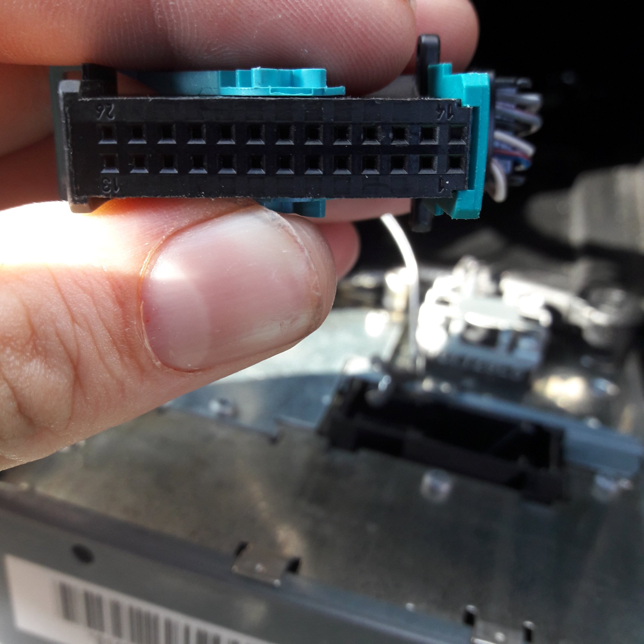

Ok, ive found the pages I need. looks like your oem headunit does have canbus, but it isnt used for steering wheel controls.
This plug is for the navigation. It does come with can-bus wires, but it is unlikely to carry steering wheel controls. unfortunately this means the included can-bus box is superfluous to your car, just leave it disconnected.
Steering wheel controls come in through an analog wire in the tri-colour plug. Luckily there is a connects2 lead for this. Look for CTSSK001.2 and be sure to select the CHINA or UNIVERSAL patch lead. Like this one: eBay link
Installation instructions are included, but in short:
1: Hook up main connects2 lead between the cars connectors and the xtrons lead.
2: the connects2 box connects to dedicated plug in the lead
3: patch lead plus into connects2 box on one end, the other end will have 2 wires (or 3 if ground is included, cant remember off hand). These need to be wired up to KEY1, KEY2 (and potentially GROUND) in the xtrons lead.
Once this is done you will need to go into settings on the headunit, and set up the keys, and that should be you. It might be best to simply twist the wires together, and make sure everything works as intended before making the connection permanent by way of soldering or crimping.
