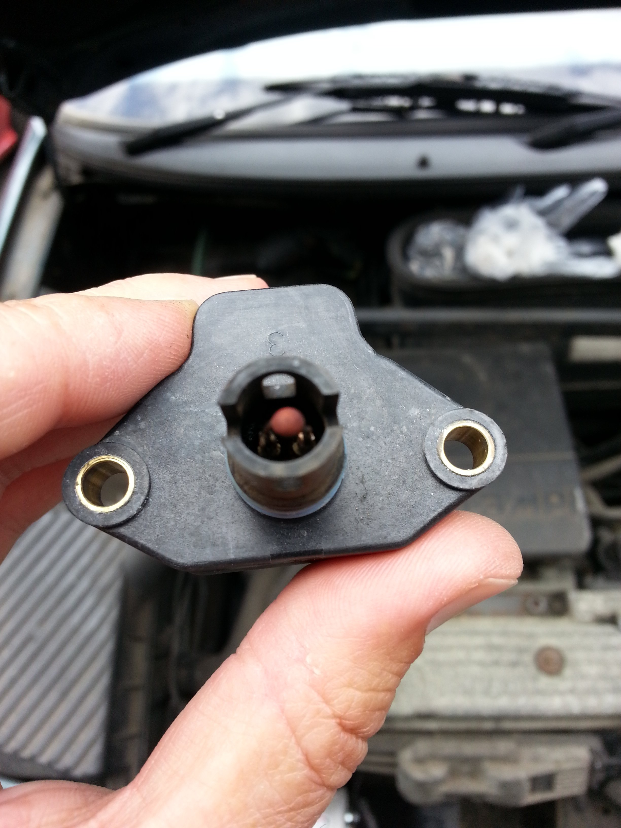

We cleaned the MAP sensor – though having removed and inspected it, it did look relatively clean when we took it off (see photo 1). We used a cotton wool bud and some cleaning spray solution (tetrachloride type) to clean around the sensor.  It was a very small space to insert the bud fully around the sensor but we gently cleaned the inner areas we could access without forcing it.

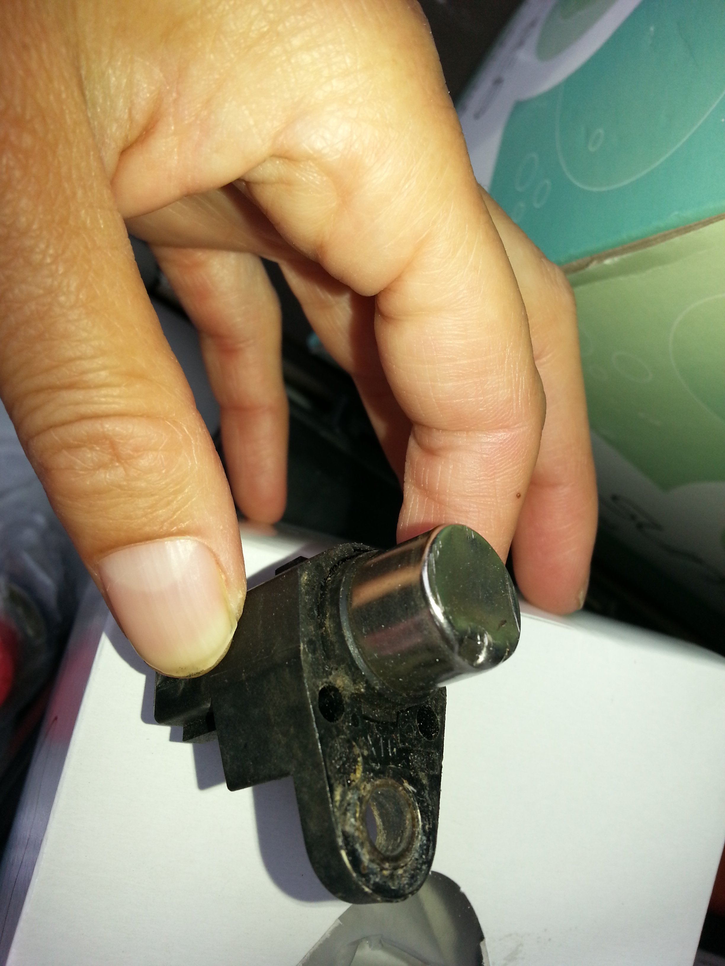

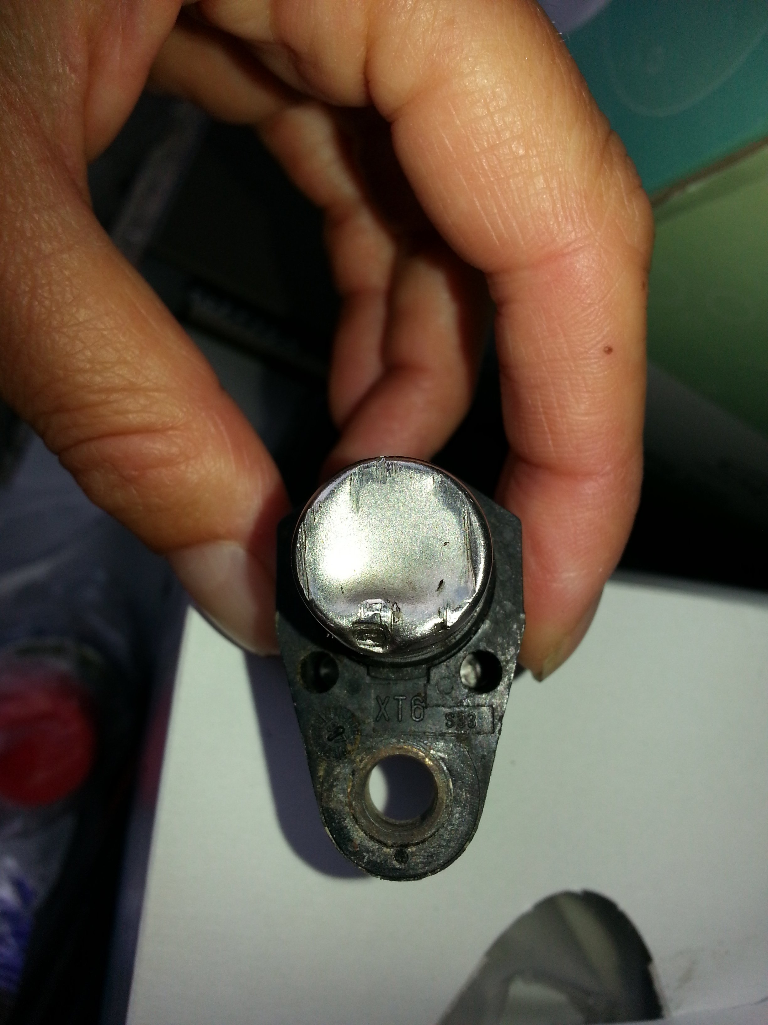

We also put back the crankshaft sensor that the AA man had removed and cleaned.  Again, this looked pretty clean, however we did notice that there appeared to  be a little bit of damage to the magnetic(?) – see attached photo 2 & 3.

1) Does the crankshaft sensor look like the culprit now that we’ve posted the photo?

Well, I think the MAP sensor cleaning went well.
The CPS should not look damaged at all. What we see on it are marks from hitting the flywheel. That is an issue and the sensor should be replaced with the best/original one you can find.
That may or may not solve the engine stall issue. Go for cleaning the throttle body.
