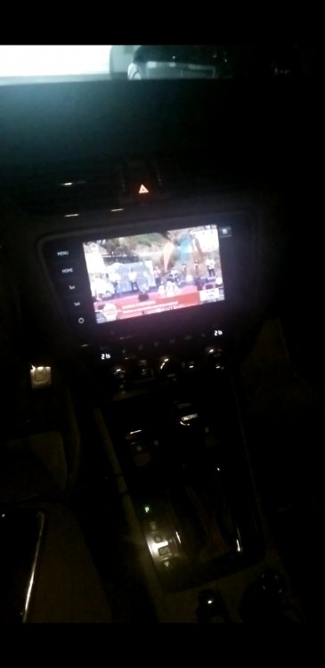

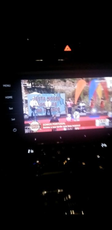

Done!!
Mirrored my S9, by cable.
The photo i'm watching my  cable TV APP
13 hours ago, BlackOctaviaRS said:
Done!!
Can you explain exactly how?
I CANNOT get my S8 to connect via mirrorlink correctly.
Don't get me wrong.. it connects, but ONLY the "accepted" mirrorlink apps are available for use.
I want to connect my fone, so it's a true MIRROR connection..... so I can sit in traffic and read my facebook feed, etc, etc
(there is a degree of facetiousness in that comment..... but the premise is still correct. There are apps I want to access on the car info screen, while parked)
Don't worry, I wanted that mainly for TV apps and Brazzers ahahahah
Its pretty easy! Its a Glitch i guess, but it works, not 100% HD tough...
First you need to remove android auto and Samsung car mode, unsintall all those, you can only keep rockscout, LG mirrordrive ver. 1.2.1.2 ONLY and easy Touch (short cut button).
First you need to Run easy Touch on your phone. Configure the button your own way and adjust the apps, because you Will need it on the car. Open the APP and leave it running (ir should appear a round button on your screen)
1- connect to the car mirror mode and after connecting, it should appear the available apps. first close all apps on the car.
2-open rockscout (you should notice already the easy button) and chose YouTube
3-you get a message saying there arent any media available. Great. Click the button bsck to menu on top right (leaving the APP Open)
4-open LG mirror. It Will load and give you an error message! Great again! Algo click on the same bsck to menu button.
5-now click 1-1 button.
6- it Will Open back the rock Scout APP where you left on the YouTube "no media" folder
7-now select < and < and < on the top left untill appears your phone mirror.
Enjoy your porn!!!!!
If you don't get it to work i can make a video but I should sound like José Mourinho talking English lolololol
