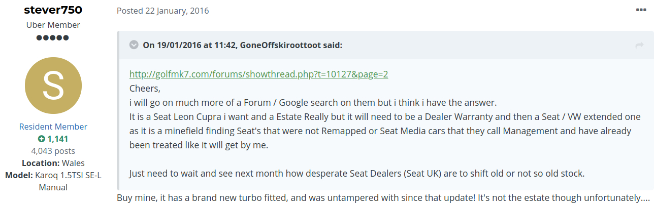

In my case, as the owner of the Leon, I declared the remap with both seat UK finance and with the UK tech department. I also didn't try to hide it from the local dealer.
@stever750I remember you telling me 'to keep up at the back',  i just remember that there was not much said about the car after it needed a turbo and then it was gone.
Did the Dealership put the ECU back to the Factory map after fitting the new turbo and then sell as a SEAT Approved Used Car?

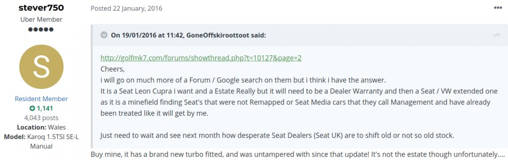

No, I put it back to standard before it was repaired. I decided to sell it not long afterwards because of the depreciation and a looming financial black hole. With hindsight, I wish I'd kept it.
Seat UK told me it was OK to remap it, but that I must return to standard when / if I returned it to the dealer network. I had that in writing.

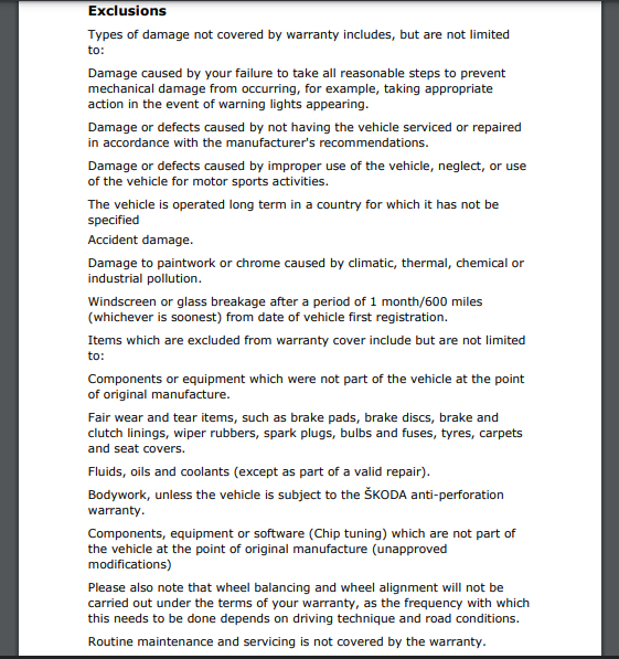

The T&C's for the Manufacturers Warranty is very clear on factory software and hardware in the Warranty Exclusions as is the Skoda, VW & Audi T&C's.
It is different invalidating a warranty when someone owns a car and it is not on Finance or Leased and if the Warranty does not cover a failure it is their own responsibility to pay the bills.
When others own the car then making the Manufacturers Warranty invalid can be an issue.
