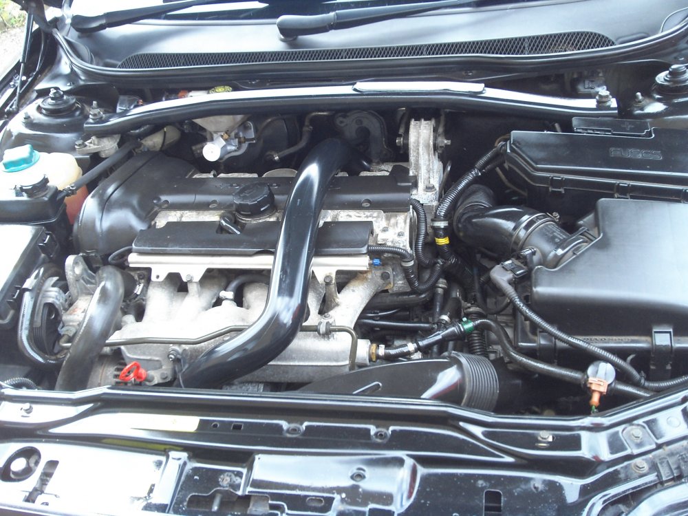

My 2003 Volvo had an engine replaced early in life, the Auto box when 12 years old. the master cylinder @ 13 years old and various other stuff,
brake calipers and suspension parts and it had only done 87,000 miles in 2016.
