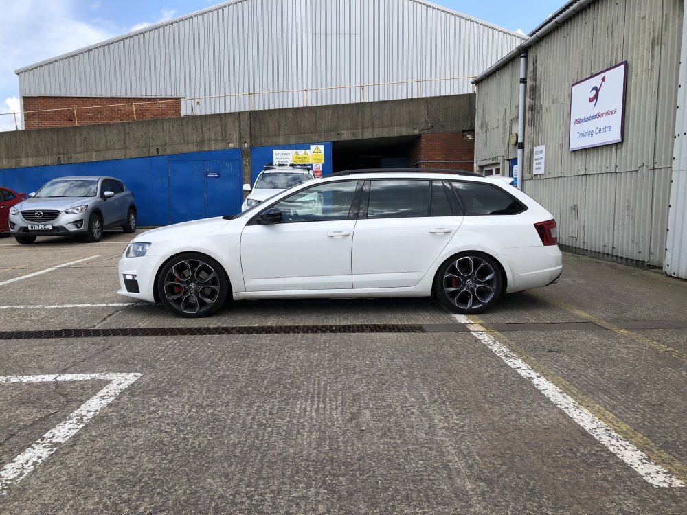

H&R all day long. This is mine on h&r with 12mm spacers.
How much lower is that?
Looking great, mate :-D
H&R is 40/40 from standard height so 25mm front 25mm rear on VRS. Eibach Prokit is 20mm front and 10mm rear on VRS.

That’s on H&R 40mm mate. Cheers. Looks even better clean lol

Don’t you guys think the front looks higher than the rear? This did my nut in on my last motor so did a hub mod which made the car look level. Considering doing to my new one now. Any thoughts?
There is about 50kg of weight in the back on that shot. I think the new H&R springs for the 4x4 estate are 50 front and 40 rear.
They list several springs for diff engines and rear axle set ups so make sure you get right part number. Also my tyres are 235/35/19 so slightly higher profile which fills the arches better.
Yes this annoys me also and partly why I went for the eibach which is 20mm front 10mm rear thinking it would even out the arch gap however now the front is slightly lower than the rear.

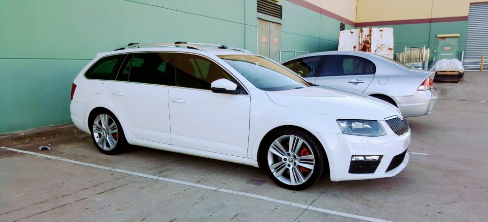

I recently installed eibach sportline & I'm quite happy with the result :)
That looks good, but how much is that?
Doesnt seem to be quite as much as the one Esseesse200 posted earlier.

Your car is just spot on. I truly love that grey color. :biggrin:
I paid $AU320 for the set
