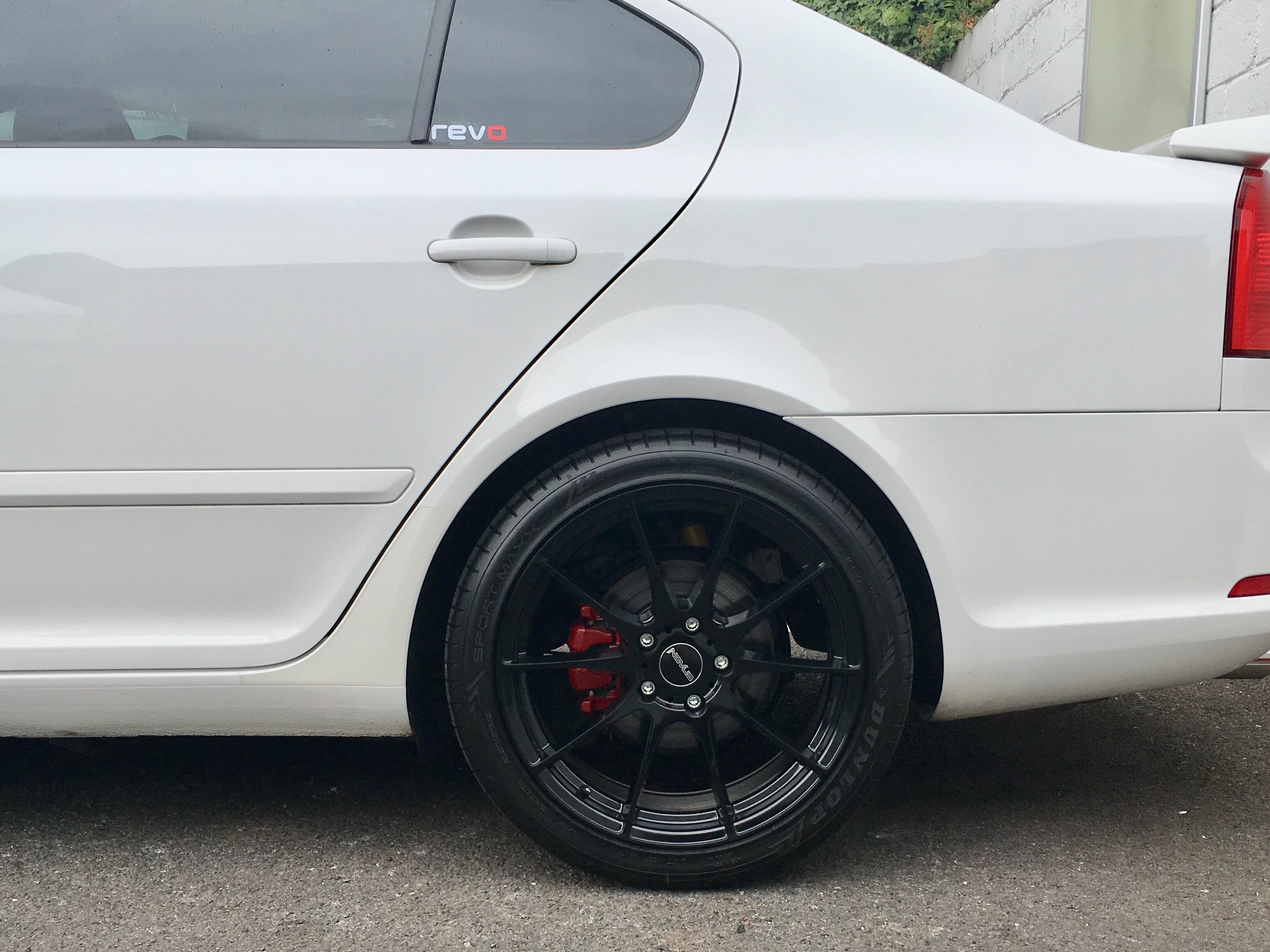

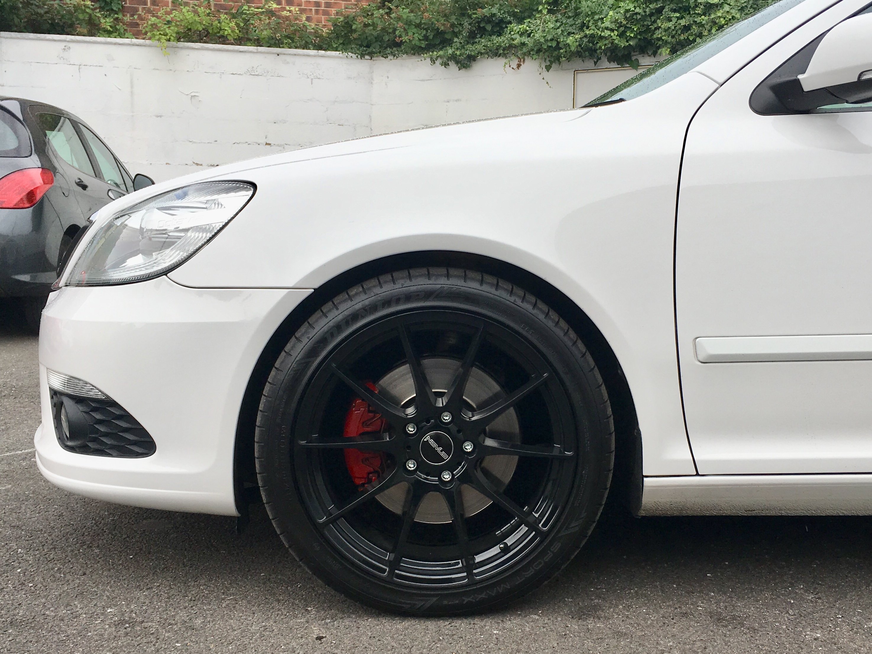

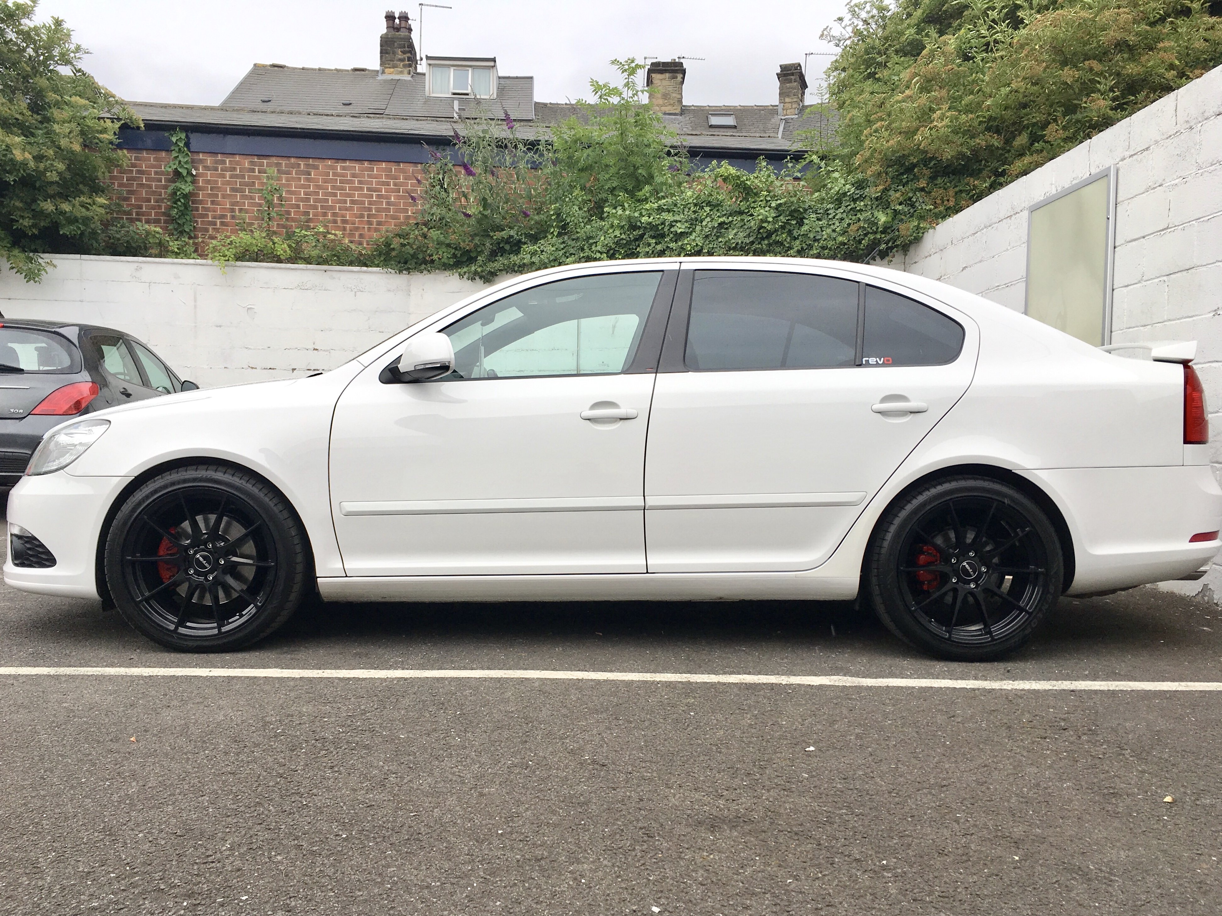

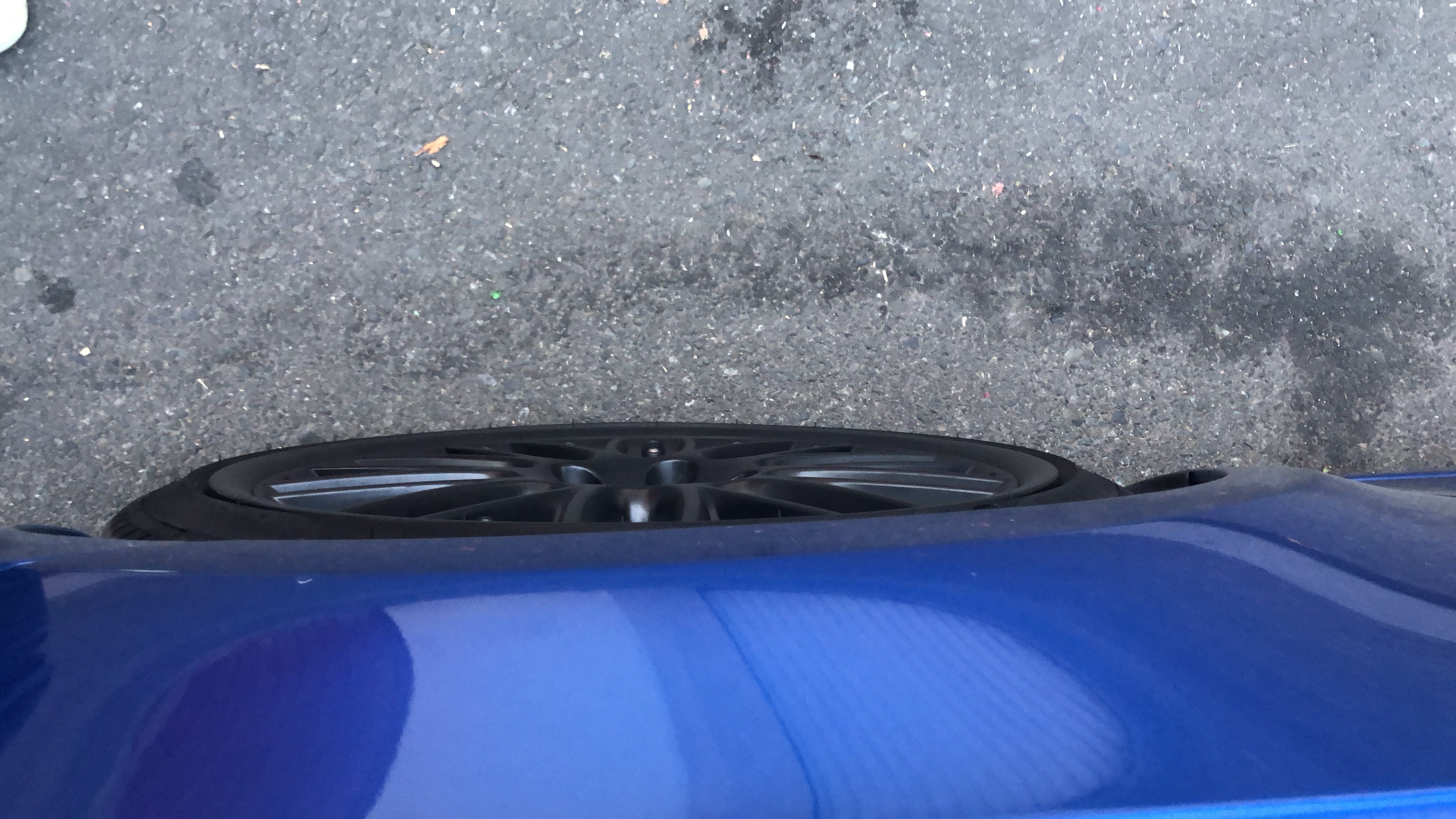

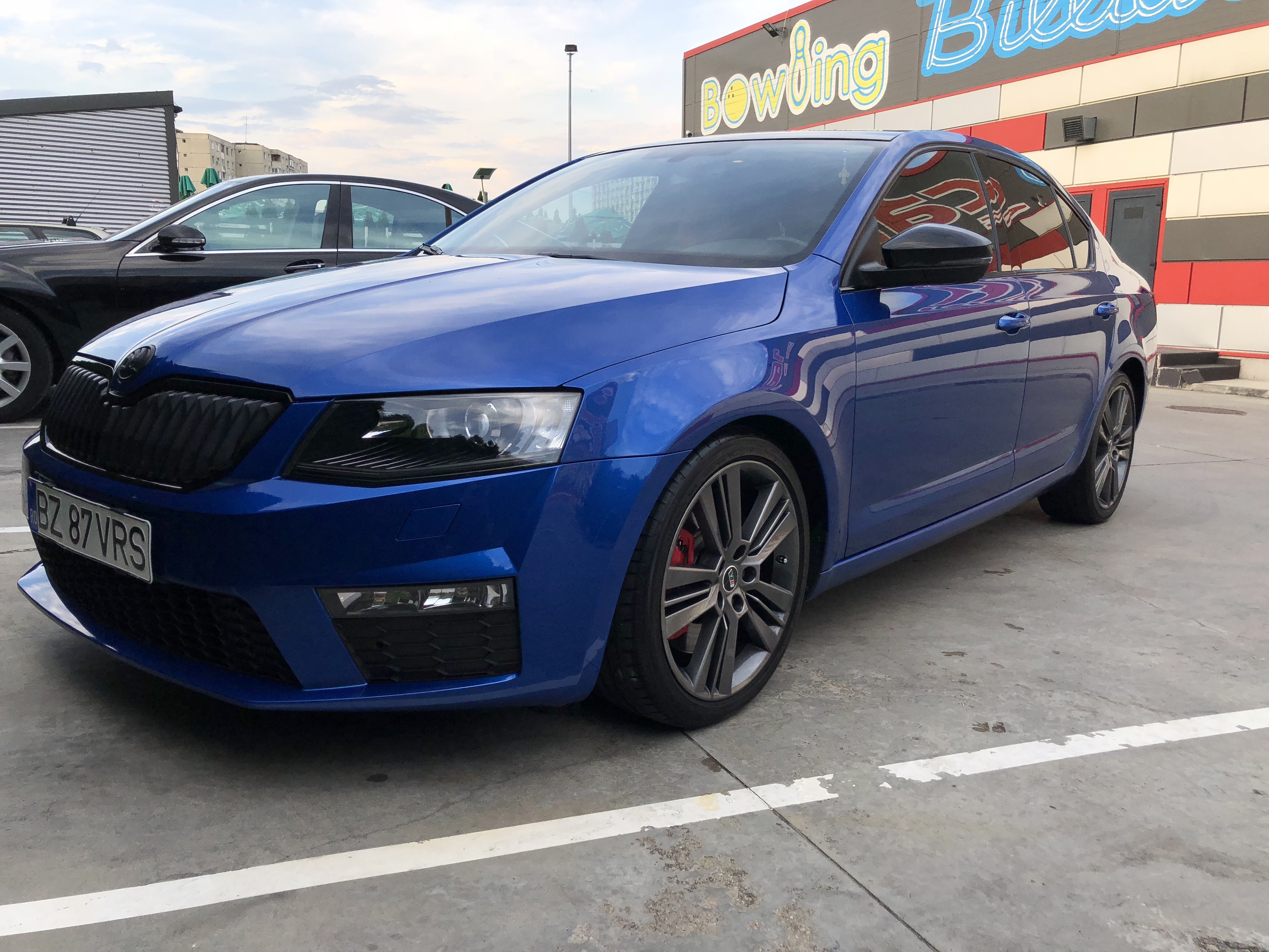

This was mine when I first had it done with no weight in. Get a proper 4whee hunter alignment done too once they are fitted
wirh 20mm spacers on back but preferred it with 12mm. Side on pic in the car park has no spacers. It’ll look lower without spacers

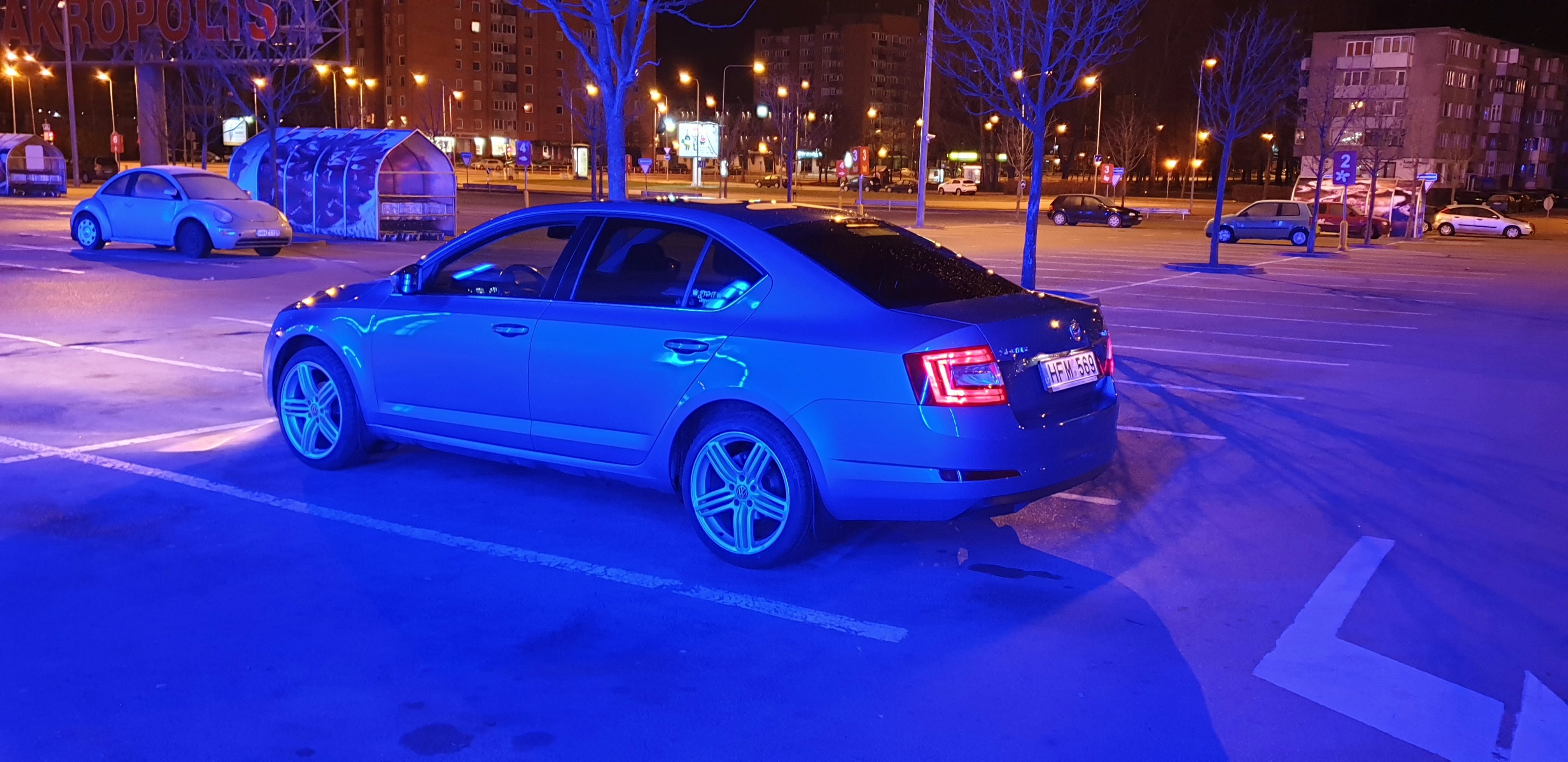

  • Here is eibach sportline with 19" wheels to. Love the stiffness, not to much and not to little. If i haven't had this car as allround and family car i might wan't some more stiffness. Nice and l

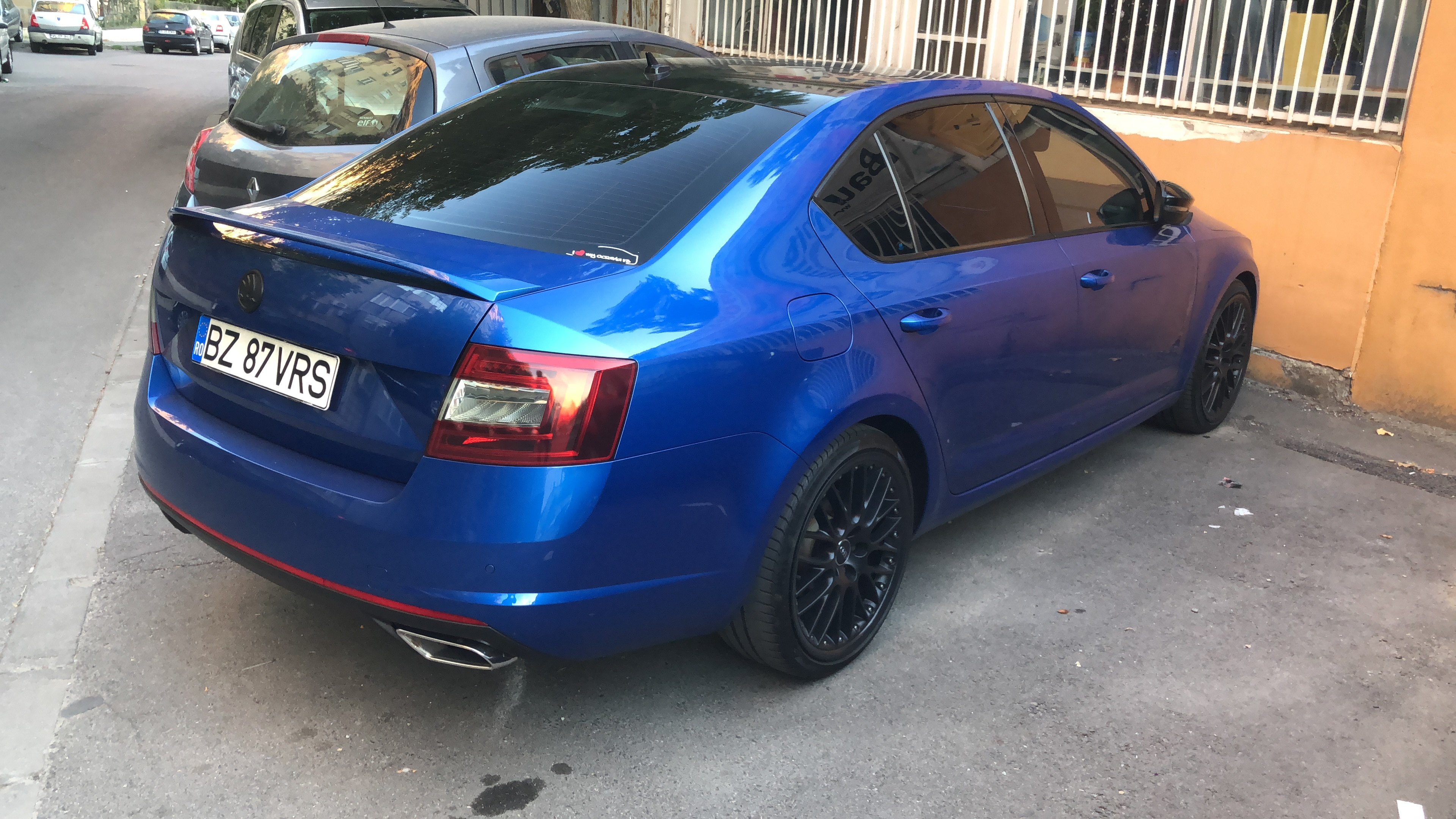

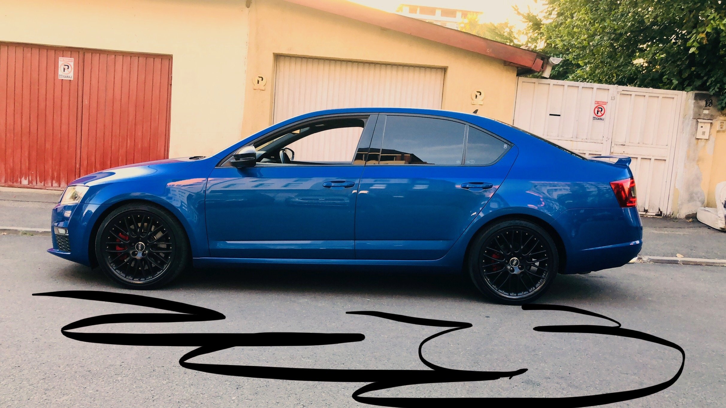

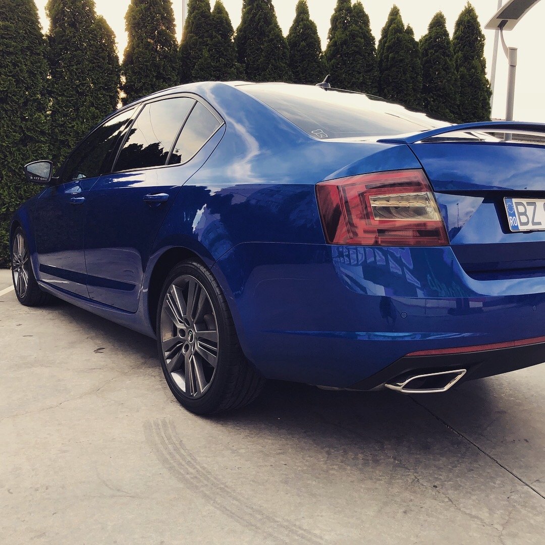

Hy guys. I've fitted Eibach Pro-kit, 20mm front, 10mm back. But i think i will go by the end of the year with H&R 40 mm drop, or Eibach Sportline 40 mm drop. Is not low enough for me.
Wheels: bbs speedline 19x8.5 et48 with 225/35/19 pirelli p zero tyres and oem pictoris 18 wheels gunmetal painted.
So, if anyone interested in buying them, i will let you know when i change them.

Looks good mate! It’s quite low if you ask me, mine is the same but I have H&r -45-50 with bilstein b8. I was expecting a 30 - 35mm drop but it didn’t happen. Front was 25-30 and back 15 -20 only, don’t know why. Maybe car was higher than yours it’s mk2 10 plate. You will do good with either choice, eibach might be more comfortable some say.

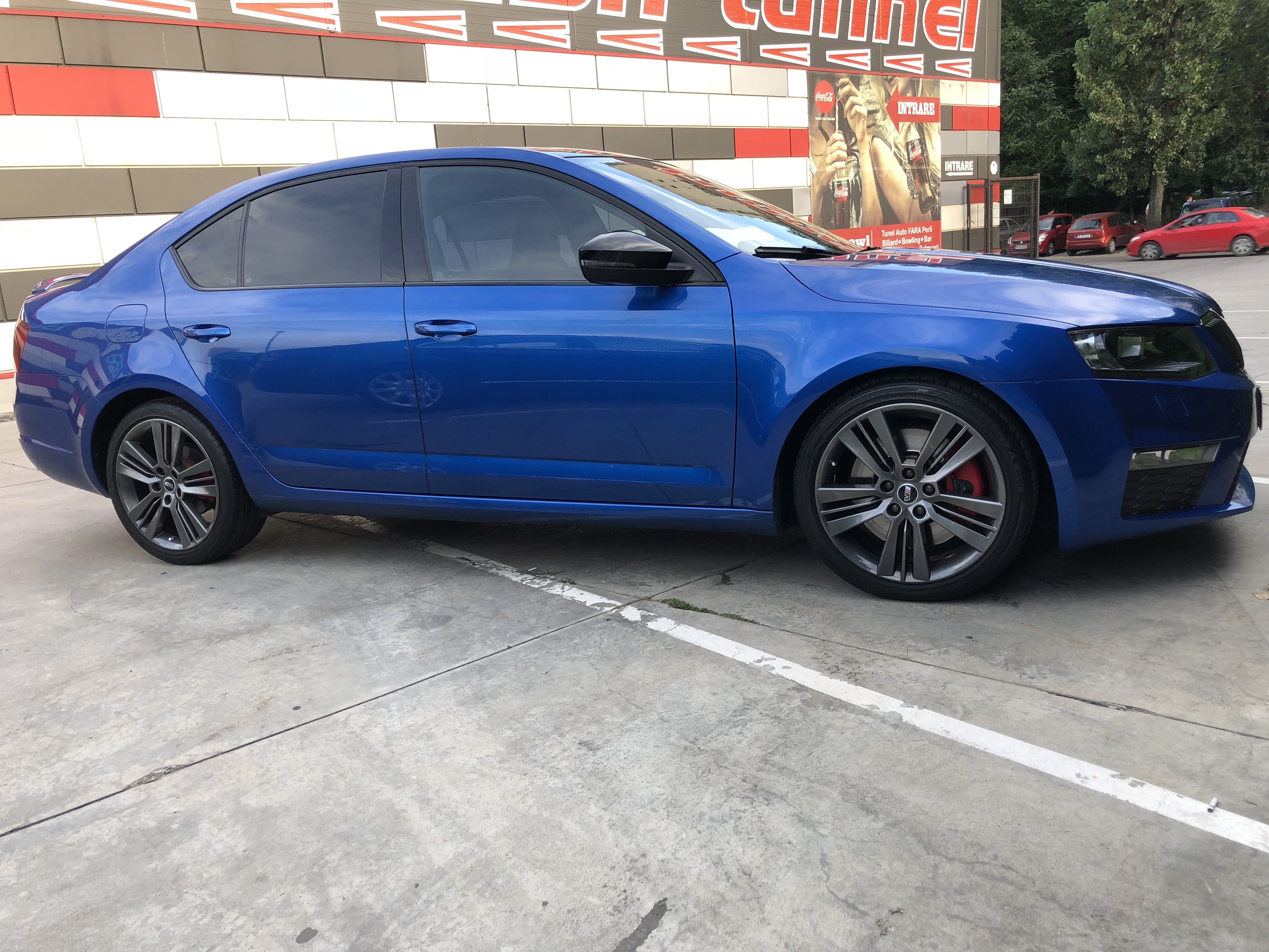

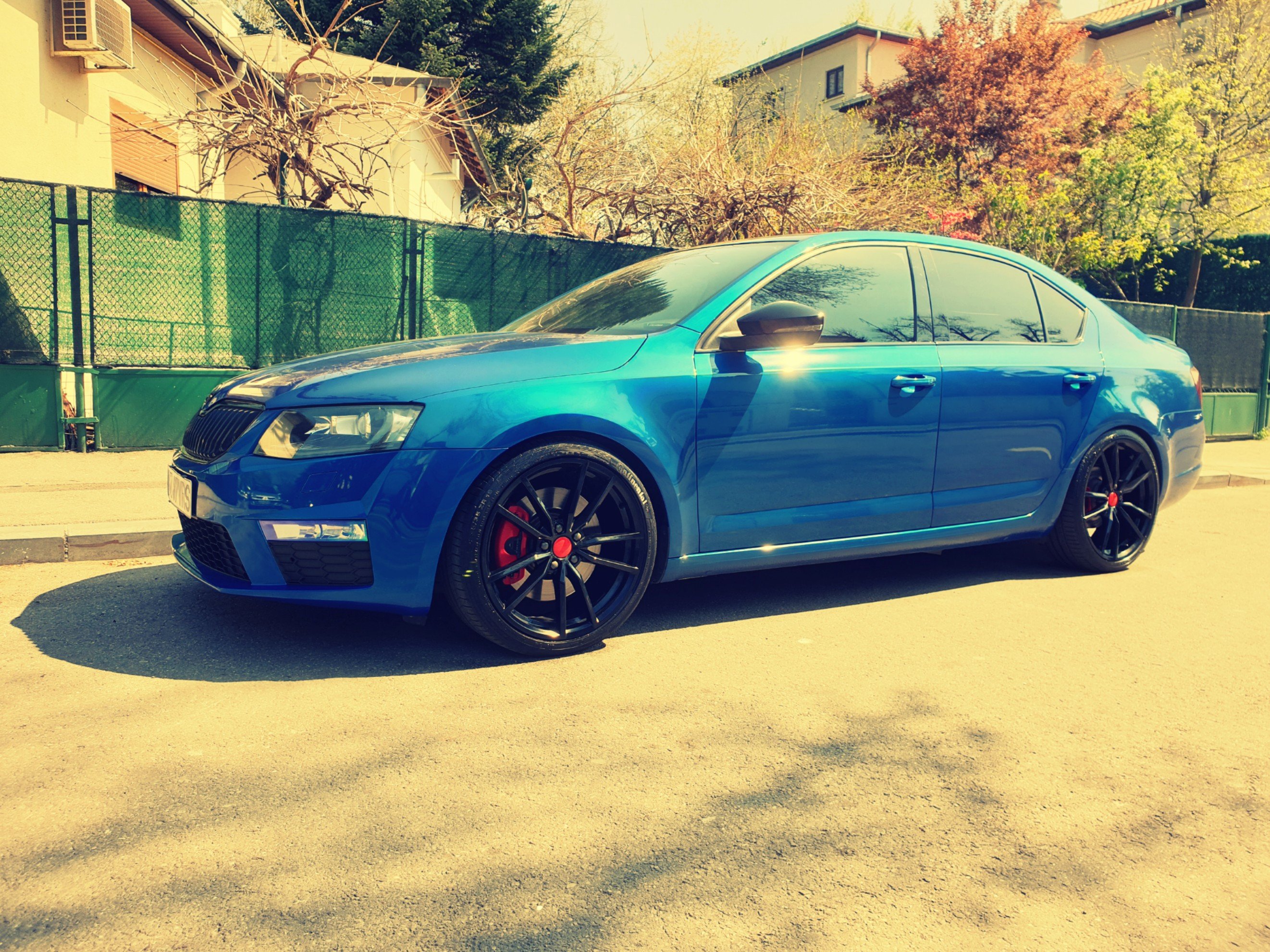

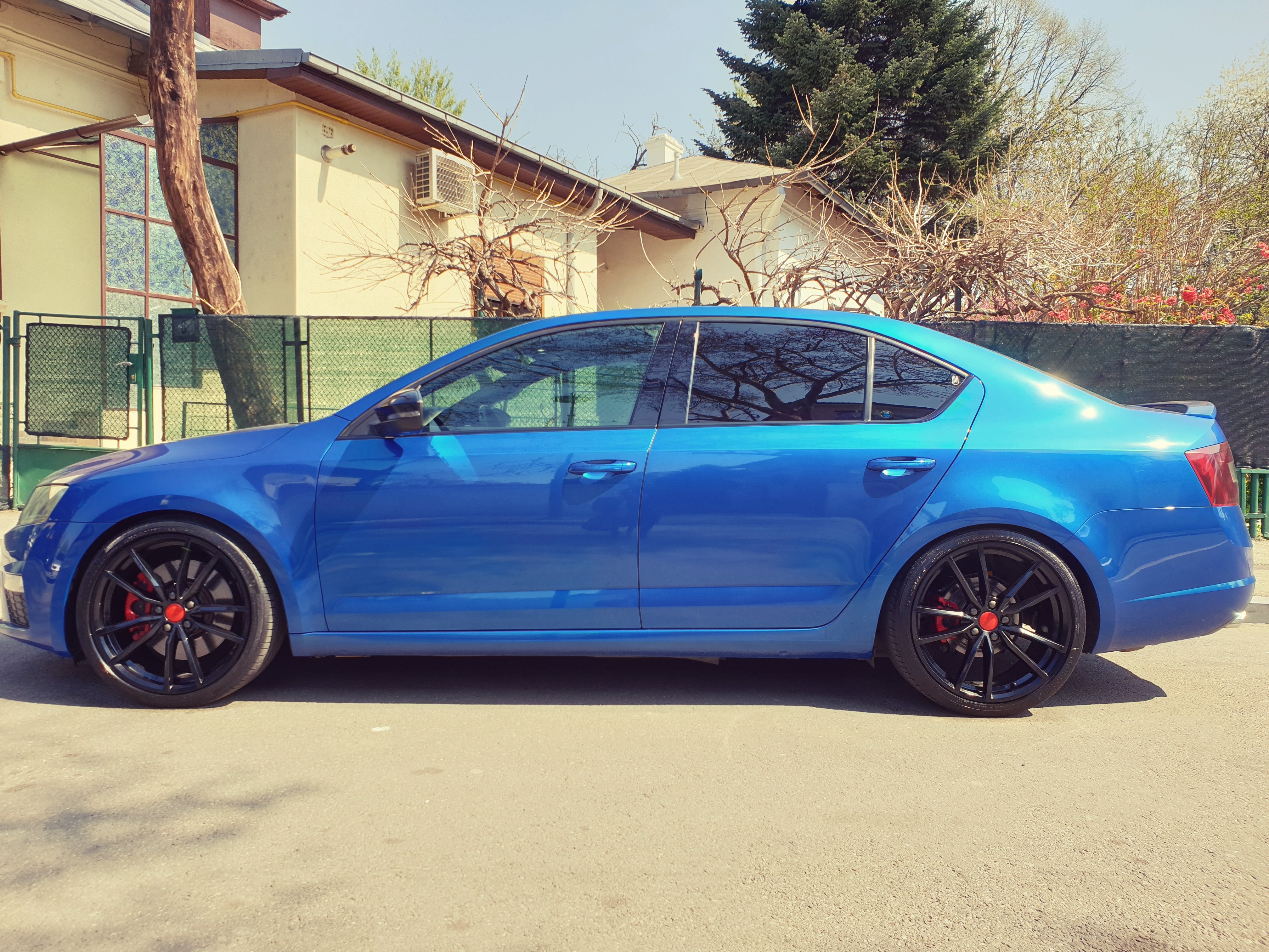

i v got 18/s x 8 with 235/40 Dunlop’s et 42 so they ve been pushed 16mm further out. I won’t change suspension anymore happy with it. Cost me about 800. Here are some pics
Edited by vrsdx57

Ride is harsher mate obviously; it’s a shorter sport damper in the end.  not very bad but I would say at the limit. You wouldn’t want harder than that.
But feels a lot safer in every day driving and like on rails in turns, lol. Looking forward for a whiteline rarb so that should finally make Octavia fast in turns not just straight line

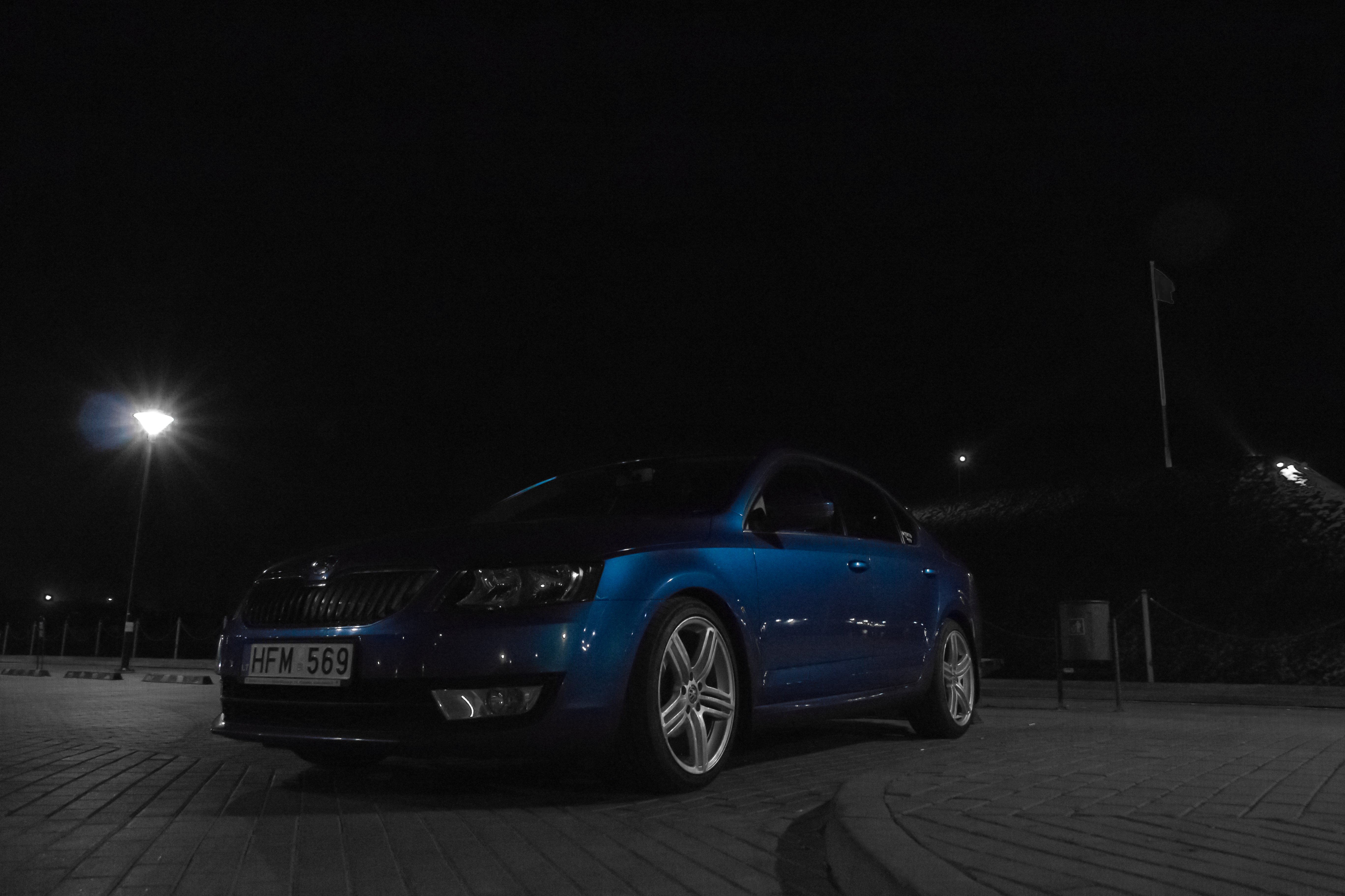

Hello guys. I have changed my suspension from stock dampers with eibach pro kit, to bilstein b14 coilovers. Changed also the wheels- vw pretoria oem wheels 19" with 235/35 continental tyres.
The bilstein b14 is better in every way possible. Ride quality improved but very bumpier. :) You can feel every bump in the road. The real diference is felt on highway, on braking, cornering and accelerating. The car doesn't move so much, it stays better on the road.
Here are some pics:

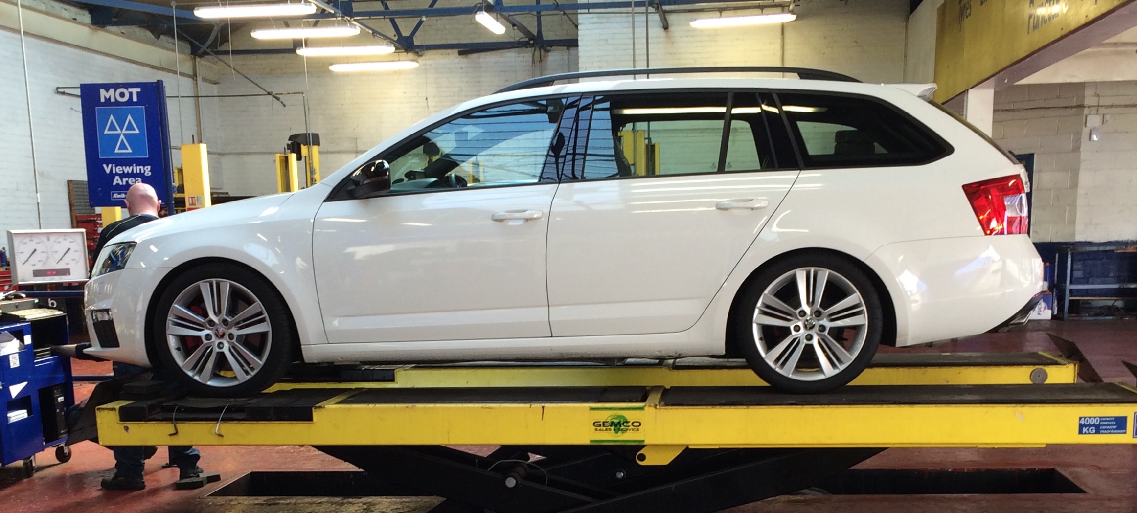

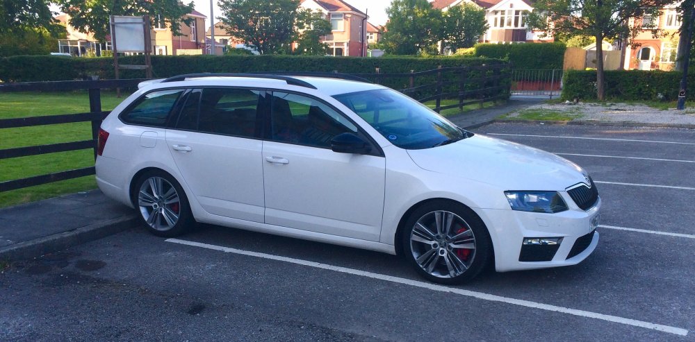

here is my skoda on eibach sportline springs and have 15mm front and 20mm rear spacers.
Before:

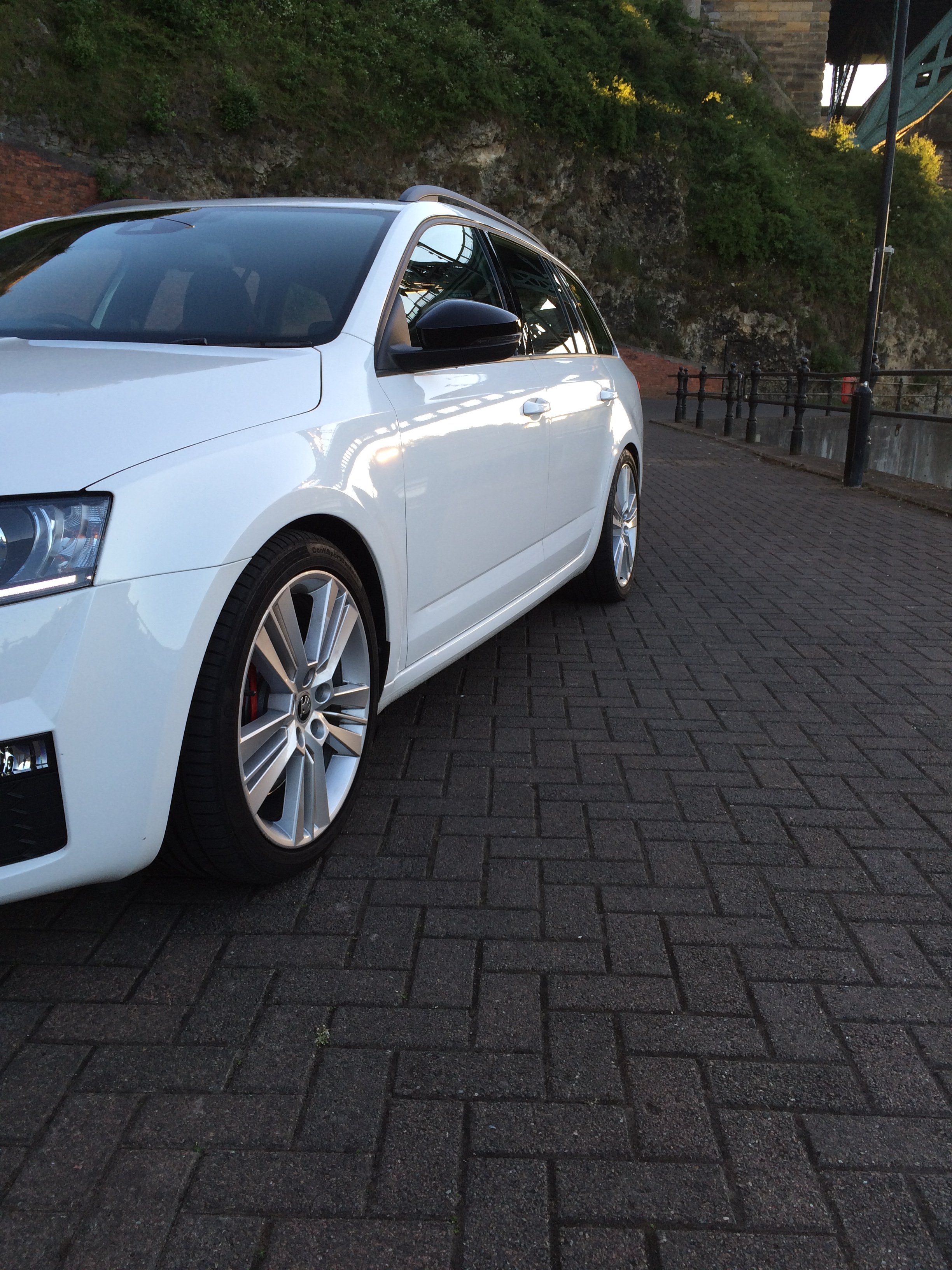

I chose to go with the Eibach Pro kit on my 1.6 tdi, turned out great. It is low enough no not look like an SUV, but the back of the car could sit a little bit lower in my mind.
After:
