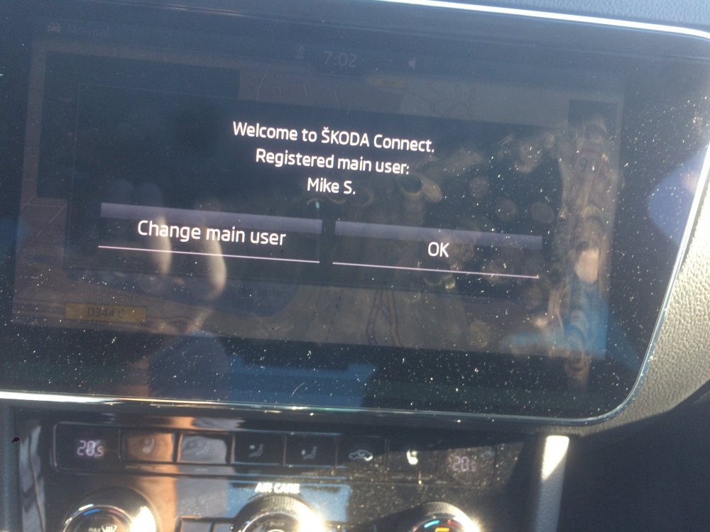

Why does my 2018 L&K with Columbus (new one with no knobs) every time I get in the car but with inconsistent time before appearing ask me to confirm who the registered user is?
I am the only user in the system
Help!

Update: didn’t make any difference, it still prompts me to “OK” as the registered main user :sadsmile:

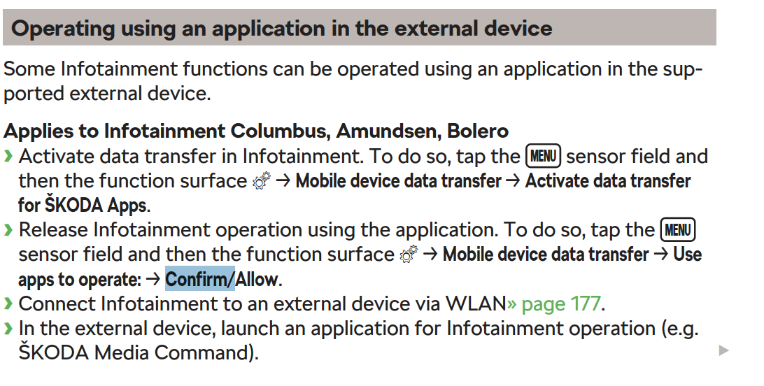

This issue has popped up quite a bit over the last few months, while each issue is the annoying message that pops up every journey, there does not seem to be a universal fix identified. I had this message and turned the mobile data from confirm to allow (see extract from manual), I also have manually assigned the keys (did this for different reasons and not sure if it matters) but I was able to get rid of the message. It only popped up once since then and that was after a software update at the dealers, it does not pop up after a different driver (different key) is used, it might for them but not for me.
Try the below and if it does not work could you list the Skoda apps you have on your phone and if its iPhone or Android.
