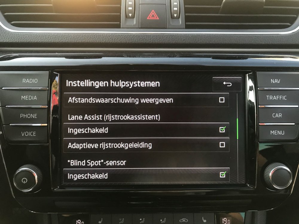

Can someone help me, i have a problem with adaptive lane guidance:
Each time when i start my car, I have to turn on "adaptive lane guidance"  on the Columbus menu.
It seems like, its not saving the settings on columbus.
I have activate the Lane assist with this VCDS code: https://www.ascoding.ch/en/activate-lane-assist/
Does someone has solution to set "adaptive lane guidance" permanent on?

@BriskodaJeff My car is from November 2016. I have now activated lane assist for a week and eacht time iam activating the "adaptive lane guidance". When i turn off my car the box for adaptive lane guidance is immediately checked-out. So i think it will not solved with trying couple of time so he can remember it...
Maybe it has to do with activating the Lane assist with this VCDS code: https://www.ascoding.ch/en/activate-lane-assist/
Another solution?
