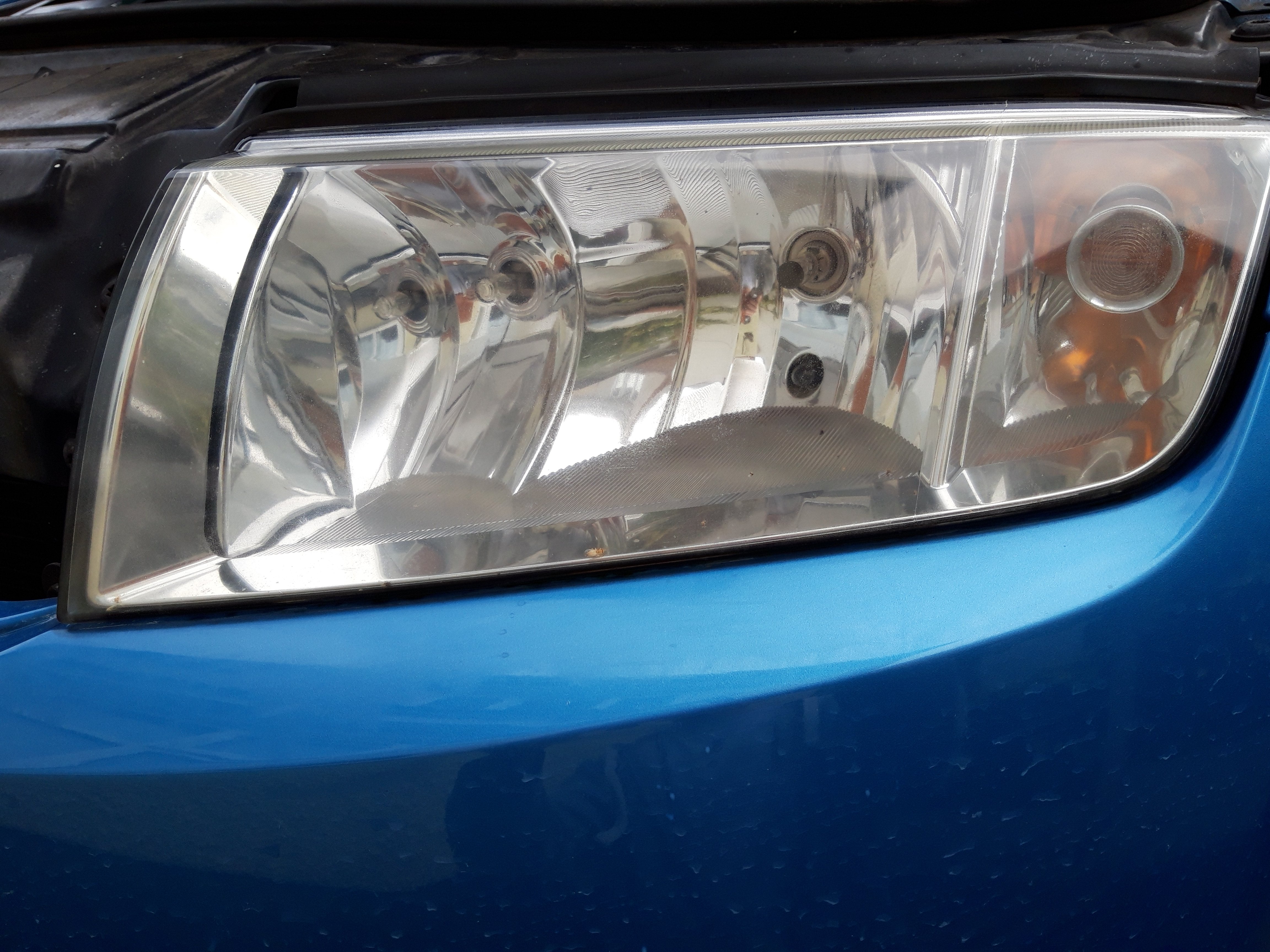

There we go all shiny.
Have a biscuit.
I used a product I found on the 'Bay" Which cost a few quid, (Maybe three) Called K2 Pro lamp doctor. It worked very well using a cordless drill and a buffing pad, I obtained from Halfords, for convenience. I did play to spray clear coat lacquer on afterwards but have not done it yet..
This was an o 2002 Toyota Yaris, which seem particularly prone to this issue so I was well pleased with the result so far!
