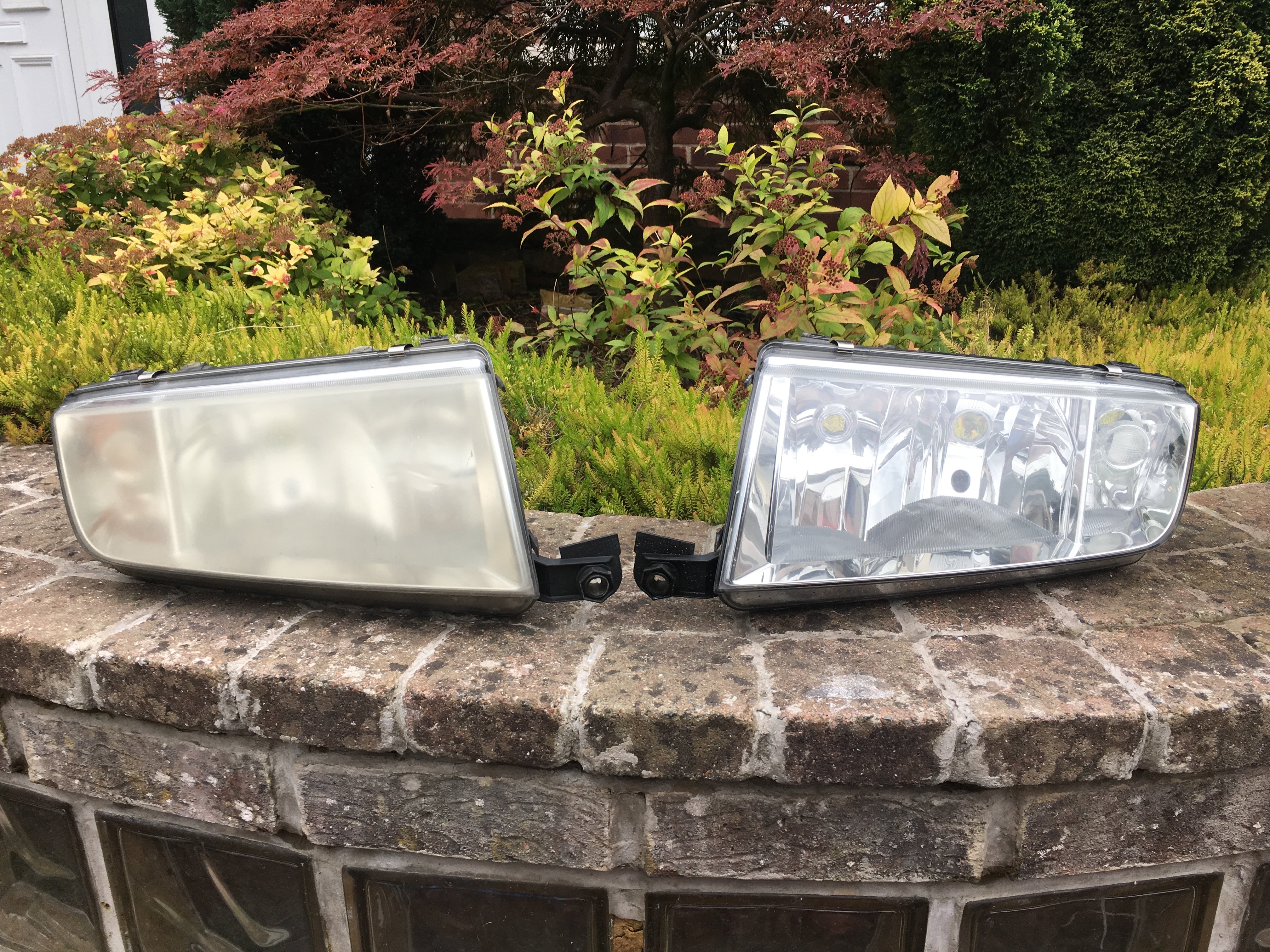

I’ve just polished my headlights recently they came up really good.
I cleaned them first using muc off which i had lying around then wet sanded them to a haze using 800 wet dry and went up in stages 1200, 1500,2000, 2500 which was the smoothest grade I could find.
I then used a compounding pad on my buffer (wet) with a small blob of compounding paste on until they were clear and a final polish with finishing polish and finishing pad on the buffer to bring them up like new.

Just done mine using 2000 then 3000 then 5000 wet sanding paper then a specialized polish cost in total £10 took about 20 mins total well worth the effort spent :)
sorry cant upload the after yet wont allow me as new member :(
You managed to get a before picture up so try again
