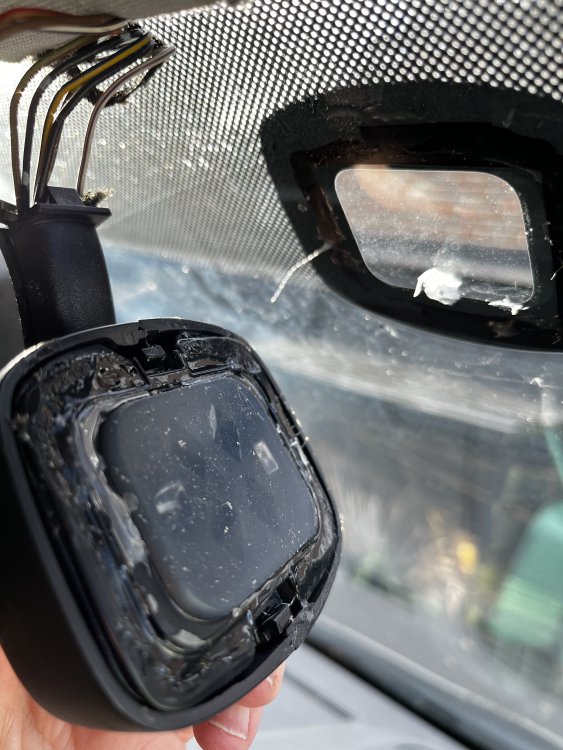

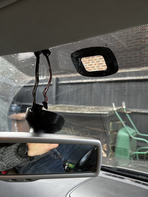

Update: Not a lot as happened as been busy with work but the time has now come to get this all sorted once and for all - compounded by the fact that Autoglass replaced the windscreen for a chip last summer and the rear view mirror was found to be hanging by its cables yesterday morning 🥵
 So as well starting to get new engine rebuilding quotes I now have find someone who can reconnect the rear view mirror
Ive disconnected the mirror from the loom but wondering who could stick it back on??
IMG_2567.thumb.jpeg.847b42a7f8b52dd8e1216b63827772e3.jpegIMG_2566.thumb.jpeg.5fc51a2610d88d05e86013f5465ca3ca.jpeg

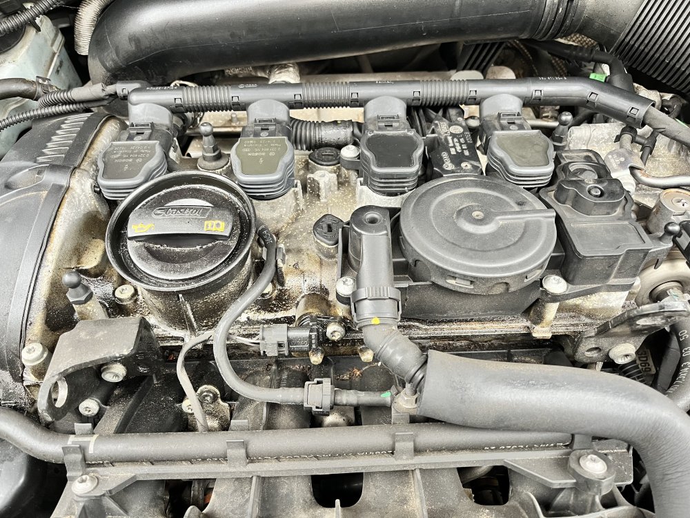

This is the current state with the cover off - looks like there's lots of oil leakage?
Edited by Yetski
Indeed it looks like a lot of oil leaking.  Where from when cleaned up?
That is not what the issue usually is with Euro 5 1.8 or 2.0 TSI,s,  They can use oil and no mess.
Possible Head gask?
