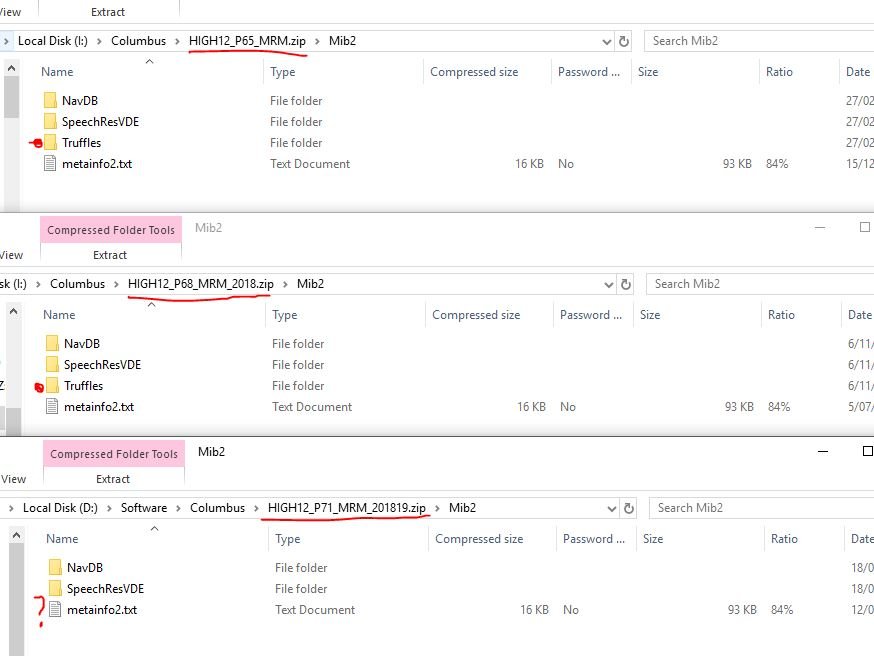

The MRM source file in the update portal is the fault here.
Not the download method.
Not the extracter.
Not the unpacker.
Not the sd-card/usb.
As per earlier my post, which no one seems to read....
The P71 MRM update is failing in the Columbus because it is missing an entire folder called "Truffles", normally inside the Mib2 folder.
The metainfo2 file in Mib2 makes reference to that folder, but it doesn't exist with the) P71 update - hence the error.
In the previous map updates, i.e. P65 and P68, this Truffles folder was present.
Who do we email/contact to say the MRM Map in the portal is incomplete, hence causing errors?
Confirmed. And it's not an easy folder to just copy in. Other than being 426meg in size, there is specific information in a sqlite database and a few binary files that are probably linked to the new content.
Fingers crossed they realise (as no one in ROW can use it) and they fix it.
Correct, sourcing the Truffles file from elsewhere will not, does not work.
I tried.
I ended up sourcing a VW 2018/2019 RoW Map, which is also P71, and it updated successfully in the Superb.
I don't know when Skoda will fix their map in the portal, which is actually missing a lot of files!!!

then again, this P71 version of the Skoda maps was broken and incomplete.
there was a couple of hundred difference short, in files, in the Skoda Maps.
the P71 Maps sourced from the VW Portal was all good.

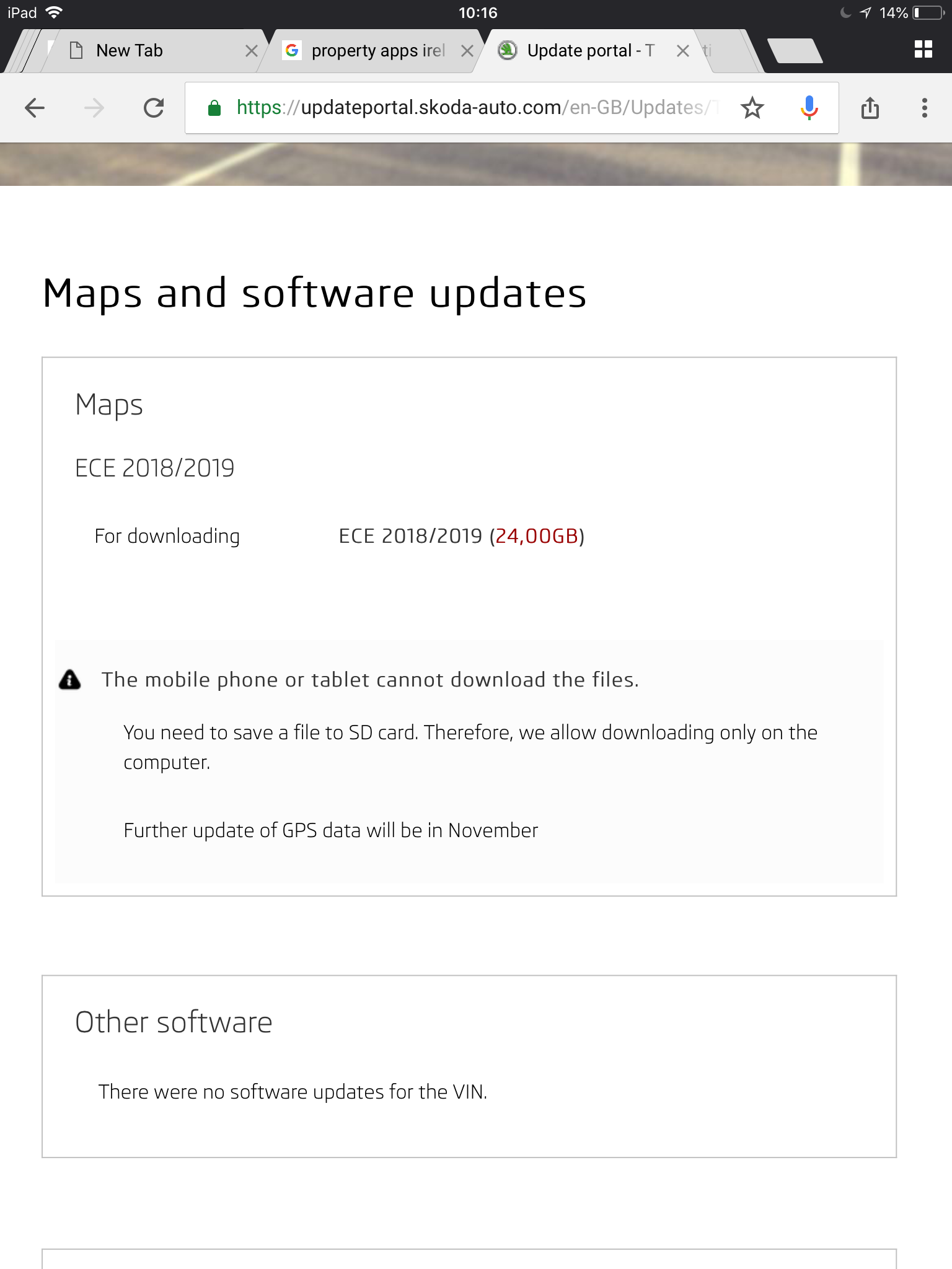

Ive just noticed on a recent trip to Holyhead via the navigation that it was offering to download a map update of around 500mb. Not really something I want to waste my mobile data allowance on.
In the update portal, I can now see this is available, so will try it on to a SD card, but 24 gig is going to take a long time on my rubbish connection speed :sadsmile:
