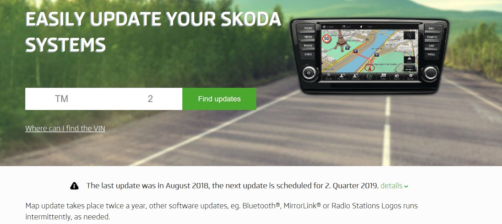

this is wat i see, based on my VIN.  mine uses the Rest of the World maps........
20 hours ago, Mik3F said:
I'm not seeing them yet on the portal, still showing the 2018/19 ones for me
on Škoda's portal update usually comes with two weeks delay
but currently even VW portal do offer previous 2018/2019 maps

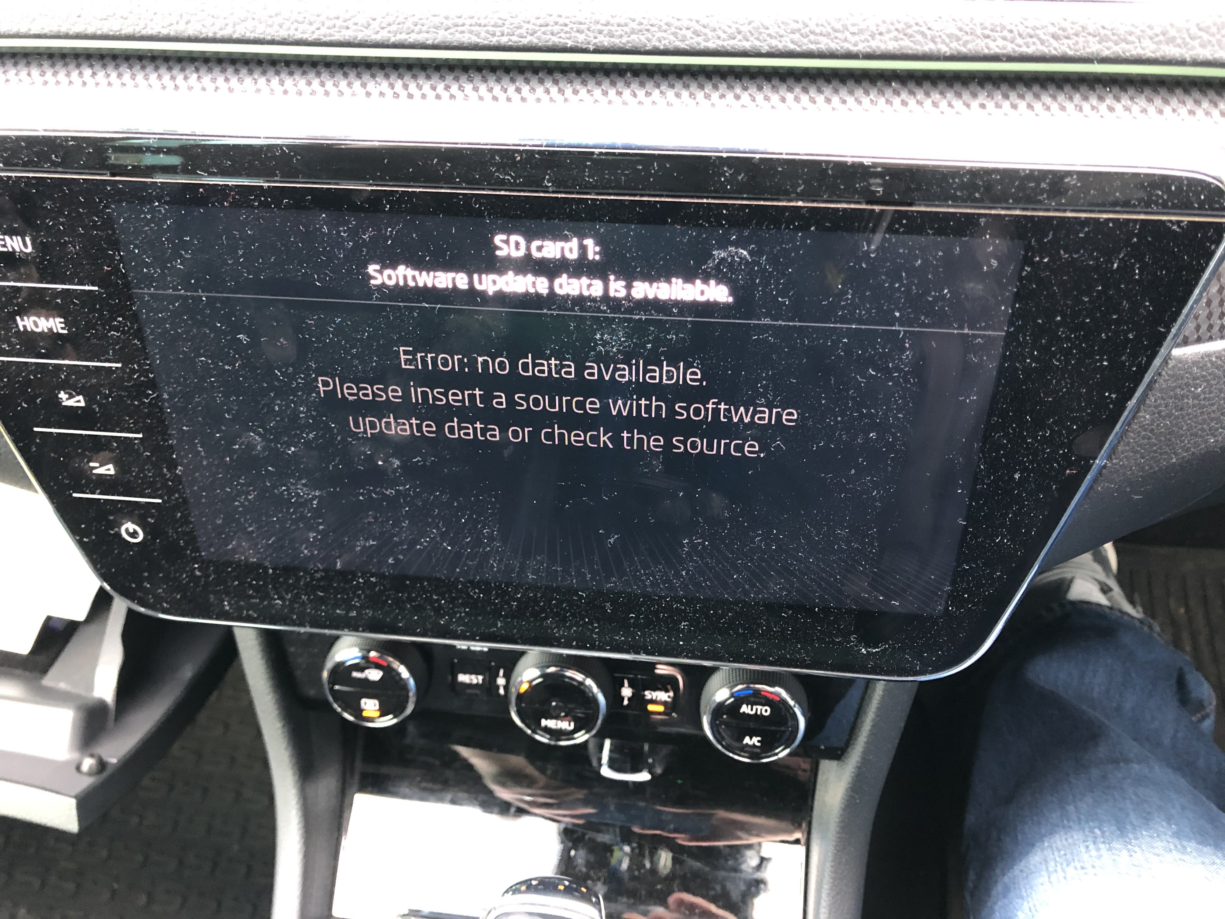

uodated through the Skoda portal.
It recognises as as soon as I put the SD card in there’s an update, but then when going to update it times out and does this.
3 minutes ago, aldouk said:
Doh
Are you on a Mac by any chance?
No windows.
I also reformatted the SD card to FAT32 before copying on to the disc. I’m not sure how good a SD card is though. It’s a 64gb class 10 but I’m using a micro one in an adapter.
Can I update via a USB stick? All the info on here mentions about SD cards, but the update menu on the infotainment states SD/USB
18 minutes ago, aldouk said:
No windows.
Which update did you do? As said, I used the link rather than the portal, but I found the 2018/19 update to be much more problematic than either the 2018 or 2019 ones in terms of stopping/failing during download to PC, and the first time I thought the download had completed it was corrupted and I got a similar message to yours (can't remember if it was exactly the same). I always save to hard drive first then copy the folders to an SD card.
Two things to try: use a USB to eliminate the SD card being at fault,  and/or try downloading again.
