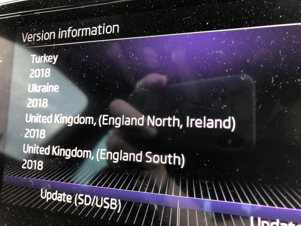

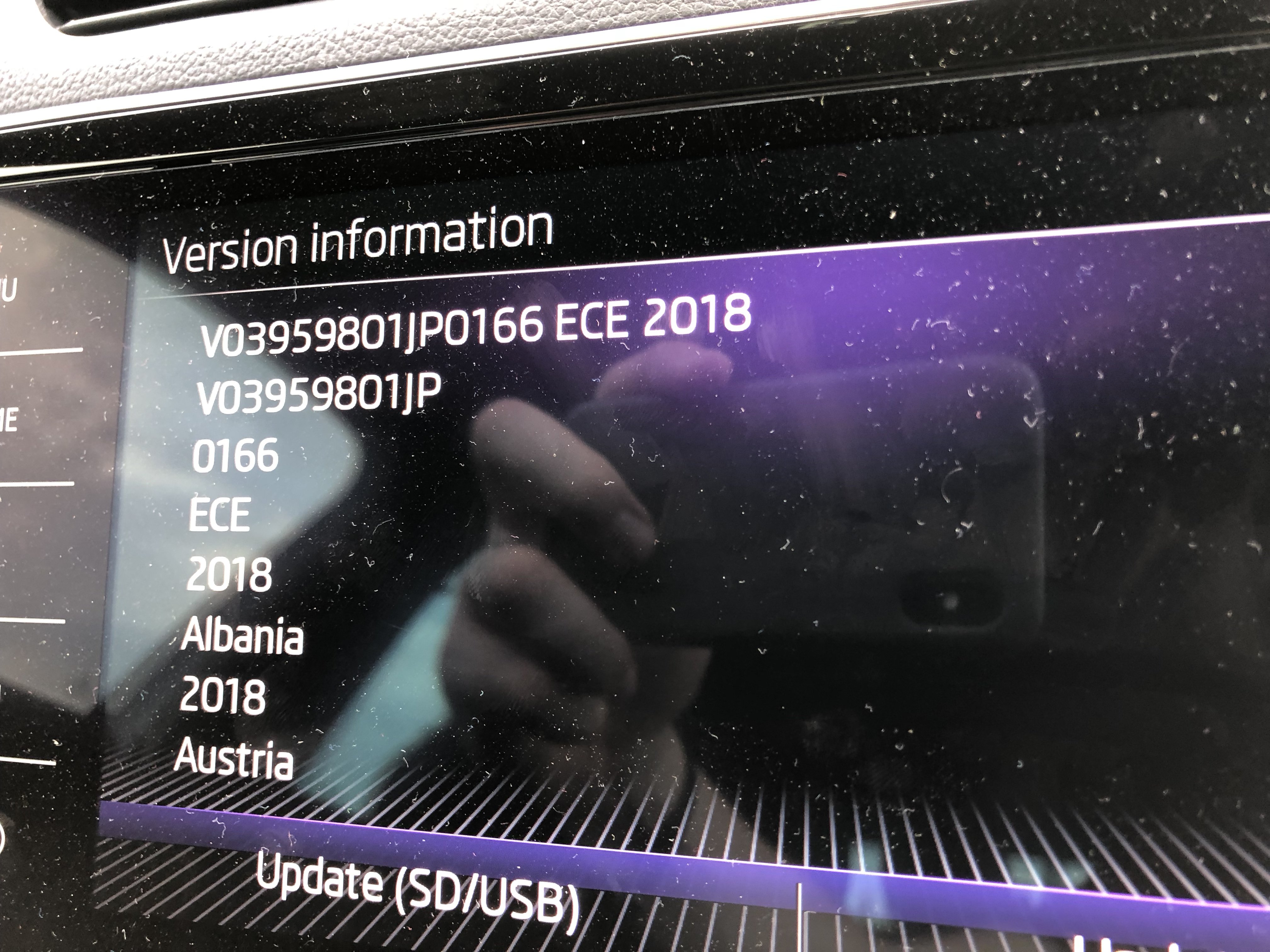

Hiya, what’s the easiest way of updating the maps in Columbus. It’s the new hard drive version.
Car was picked up January this year and shows everything 2018 for all countries.

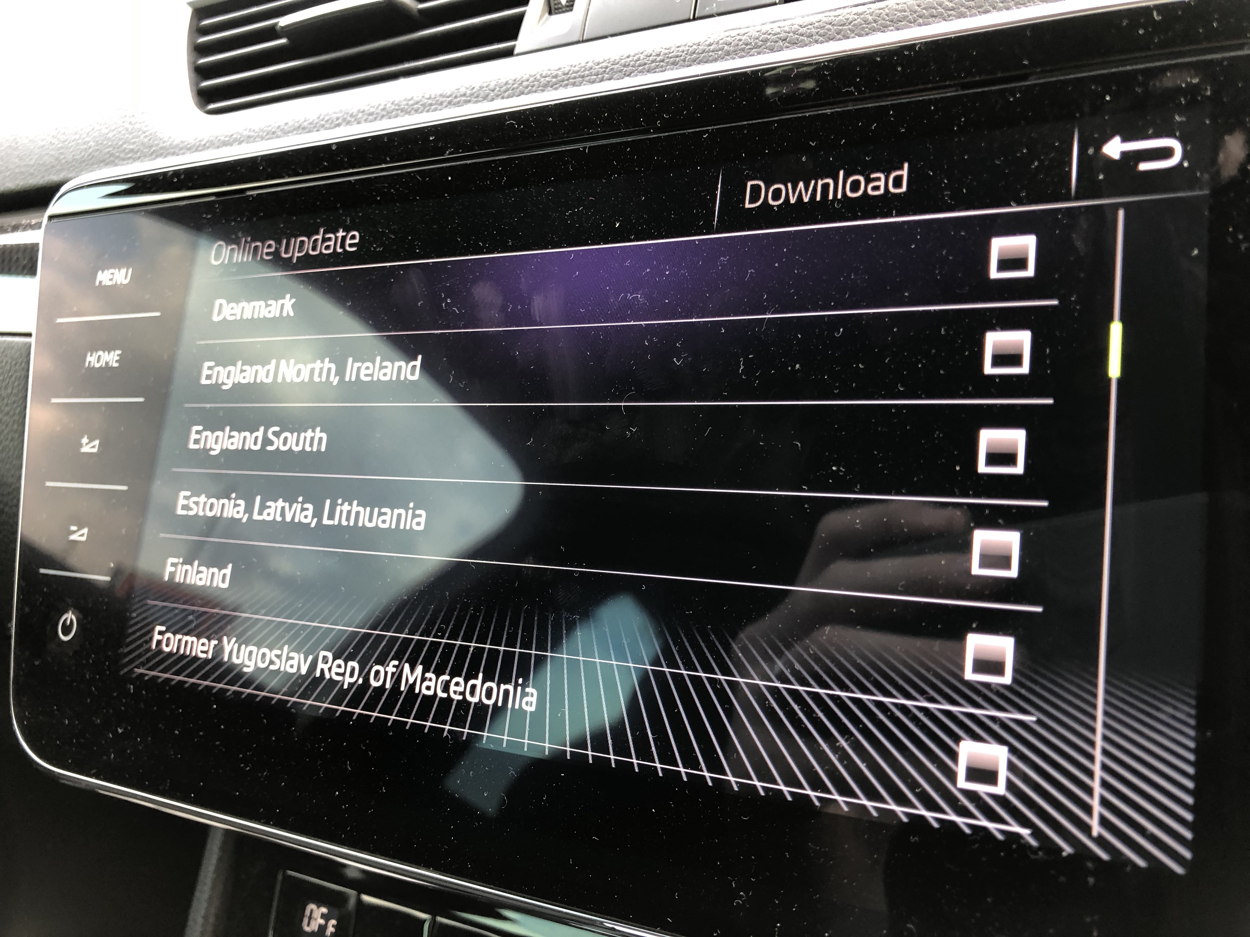

I was thinking to connect to wifi to update. Although internet connection is slow.

So the maps will show 2019 instead of 2018?
Maps will show 2018/19. Next update (November or December I believe) will be 2019.

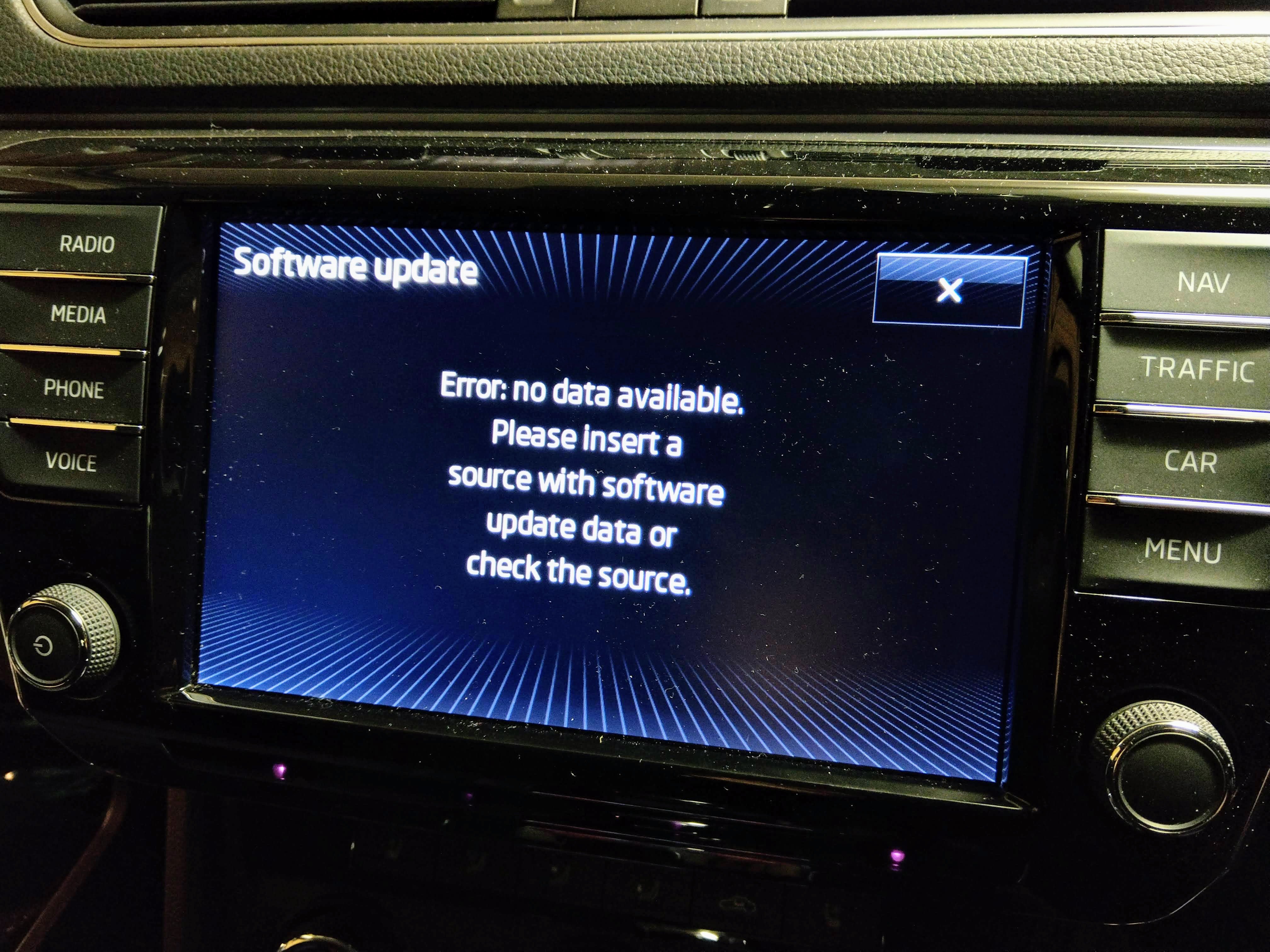

sadly I'm getting errors with the MRM 2018/2019 maps sourced from the Portal.
I've done updates in the past before with no issues.
this time the Columbus is not happy about it :(
getting the following error:-
@JR RS
did you unpack Mib1, Mib2 folders directly to flash,
without parent folder 'HIGH12_P169_EU_2018_2019'?
Hi @JR RS. I suspect a corrupt download. I had the same thing a couple of times when I downloaded using the link in the embedded thread at the top of this page. Try the download again (I know it's a pain with 25GB to do) - mine worked on the third attempt.
Just as a matter of interest, is the download from the portal just the same as the one in the embedded thread? If so, why bother waiting for the portal when it's available much earlier from other sources?
Yeah I just noticed a corrupted file when unpacking to the SD card, a file related to the russian maps.
I've downloaded from the Skoda update portal twice now, and once from a direct link I had - all no good.
That 75gb in downloads over the last 48 hrs.
Others here in Oz are getting the same errors too with the MRM 2018/2019 Maps.
I can't find a contact email for Skoda to tell them the MRM Maps in the portal is corrupt!!!
