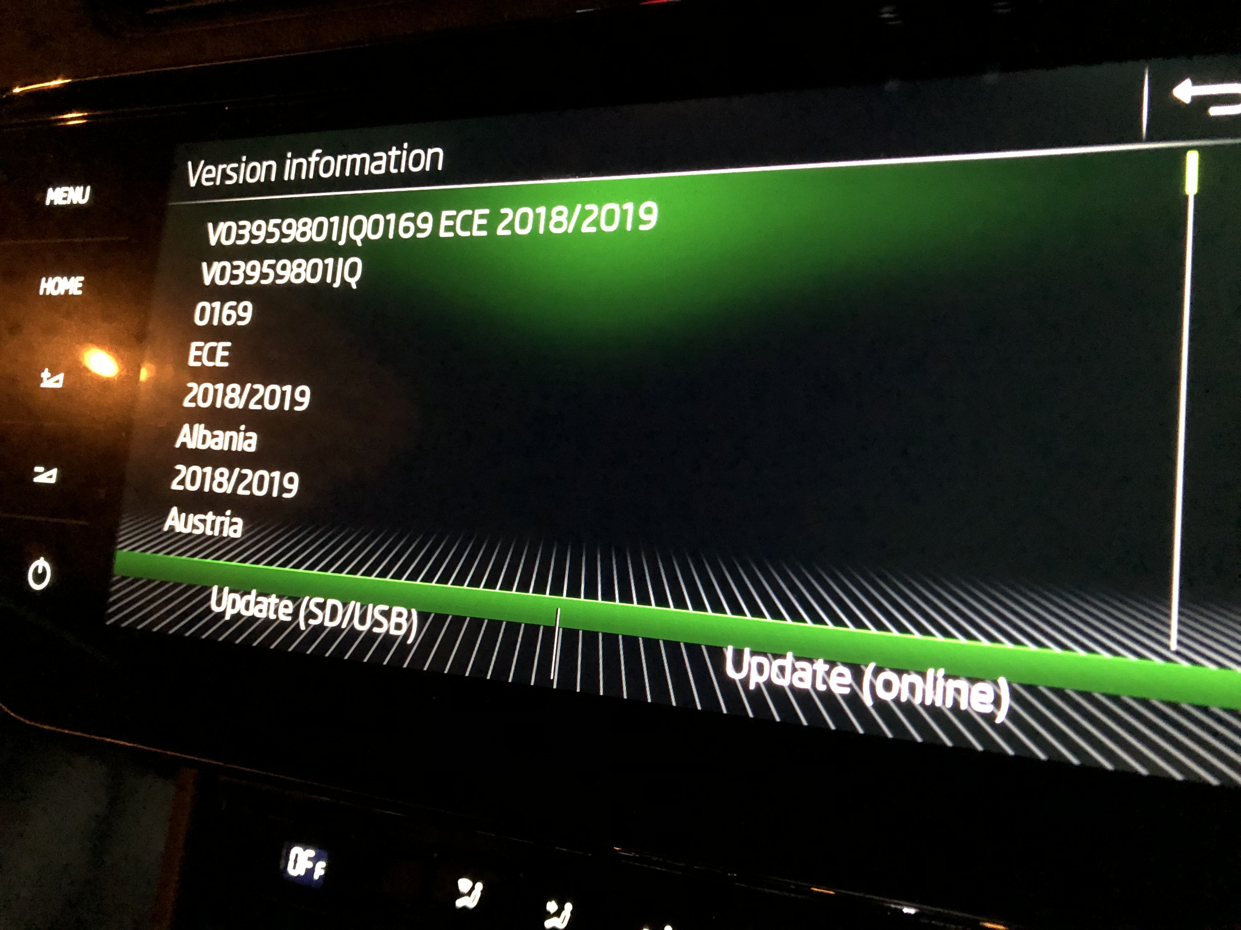

Finally got it to work via USB stick. What’s this about a 2019 update?
Is that different to what I’ve just downloaded last week?!
Yes, the 2019 update is now available
Just updated mine
Doh, I’m only on 5mbps
Leave it downloading overnight
Im on 350mbps so it took about 20 mins for me, in fact it took longer to unpack to my SD card than the downloading of the 25gb
But at least you've cleaned the screen!:D
Ha ha h la was waiting for someone to comment on the dust. I was appalled with myself!

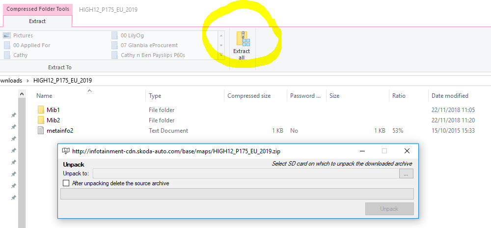

Had no large SD card so I used a small external Samsung hard drive I had. formatted it to exFAT in windows . Downloaded the 2019 update to Laptop, took over an hour for 25gigs - the little downloader utility below wouldn't unpack the zip file, to full size files and folders, to the external drive - kept saying something about it not be "portable" , so I unpacked it using the windows Extract all circled in yellow below.
Loaded up fine on the Mark III superb , columbus - but was slow took an hour to load.
