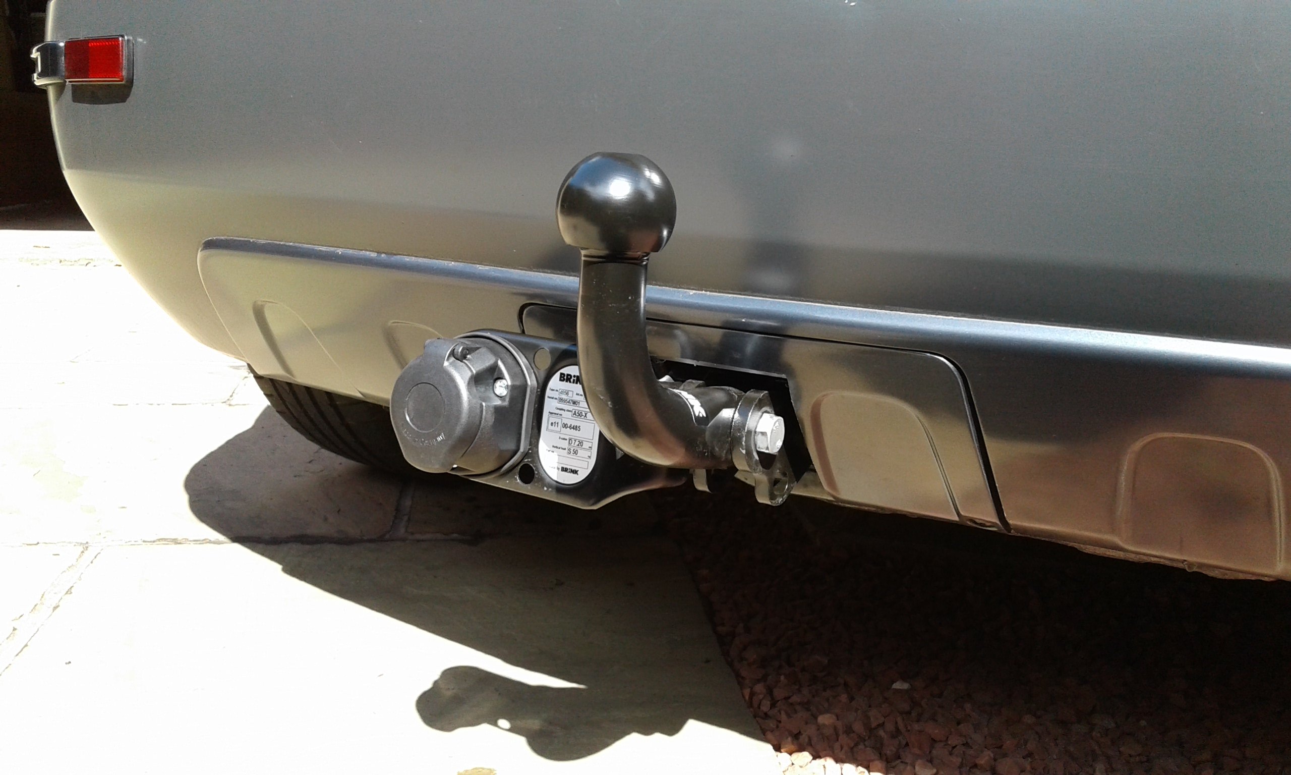

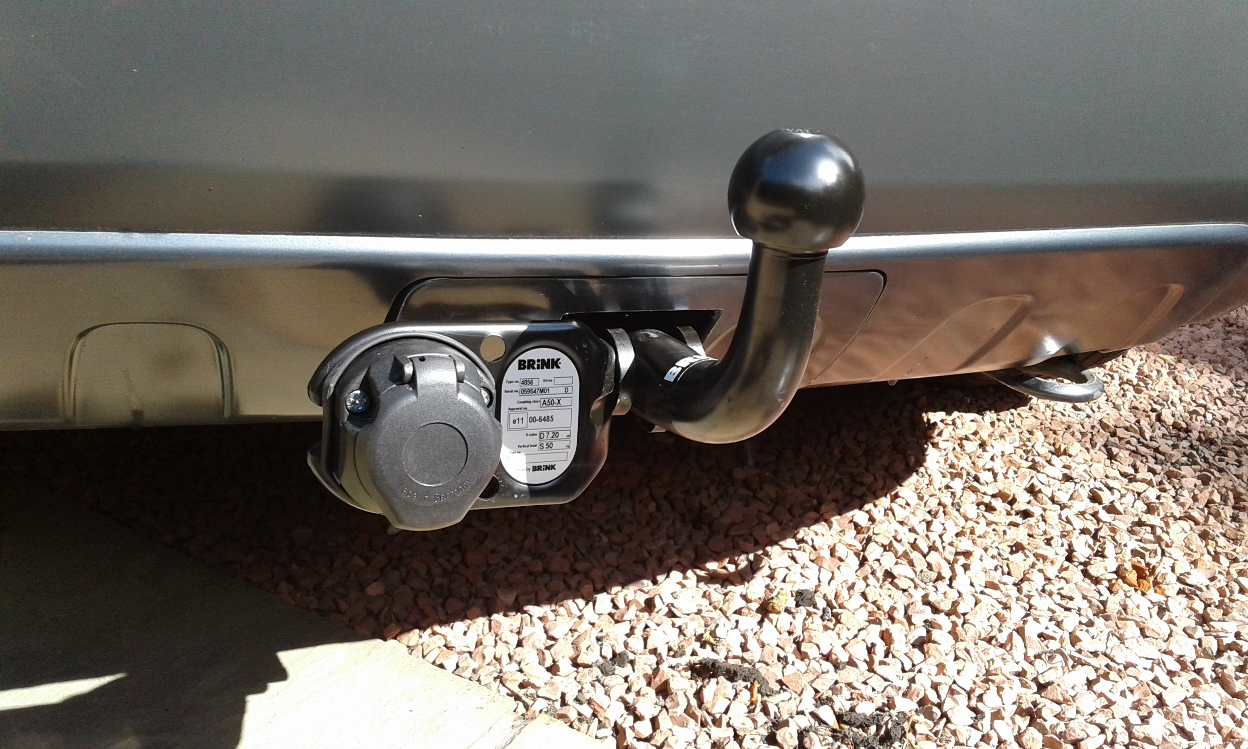

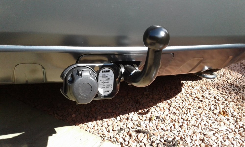

Is this a neat job, or what (I am from the midlands).
