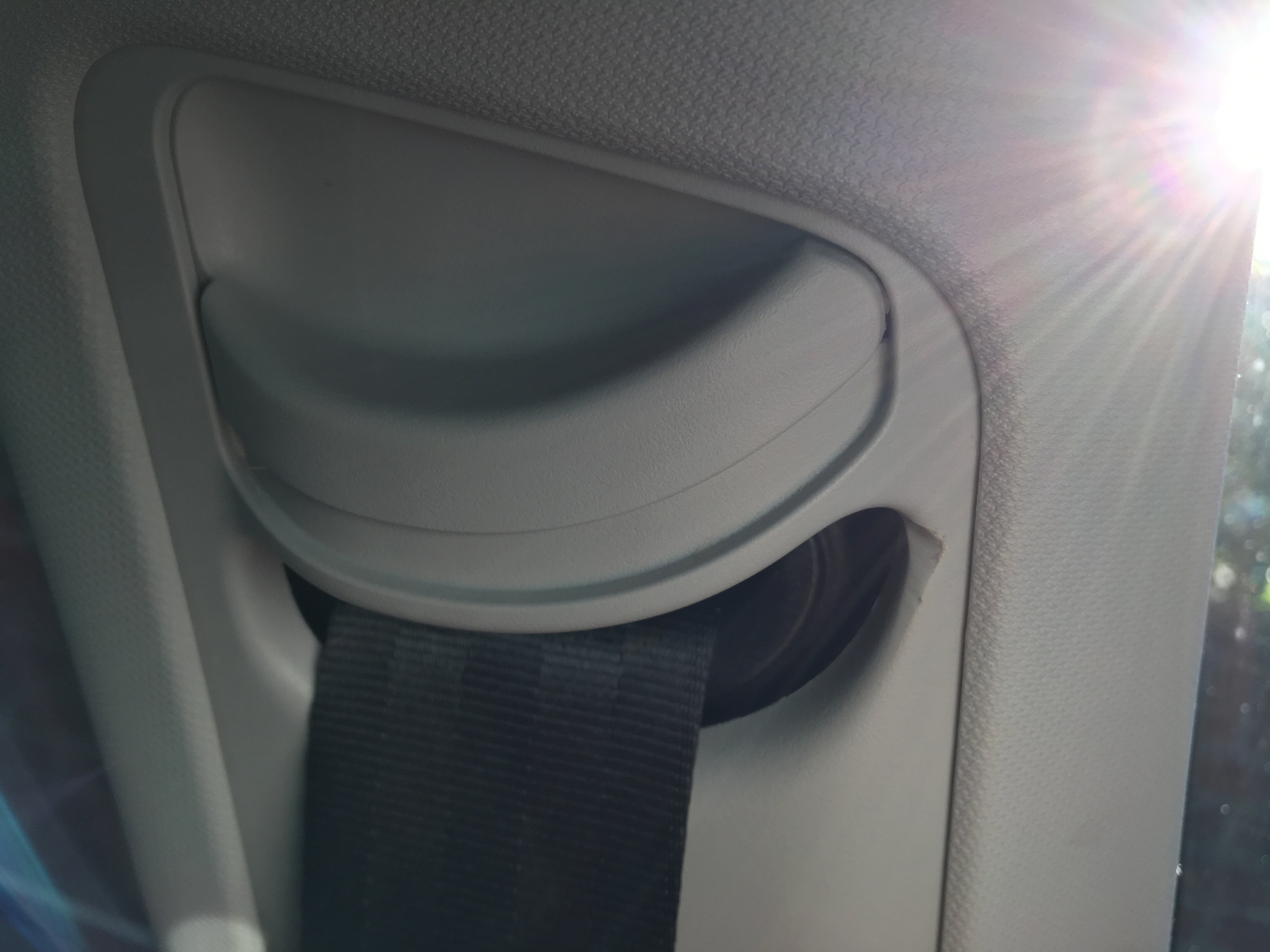

On ‎13‎/‎08‎/‎2018 at 17:10, madmancunian said:
Has anybody else had any issues with the drivers seatbelt eating into the adjustable plastic trip on the door pillar? Skoda will not approve a warranty repair, wondering if anybody else has come across this?
Can someone show a picture of what this looks like?
Not from a VRS but an 2014 Elegance. Seems a deign issue across the range.
Even the passenger side has the problem of course.
Yes and the Mk2's did it too
Looking at mine above it wont belong before I am sawing through the material on the B pillar! :D

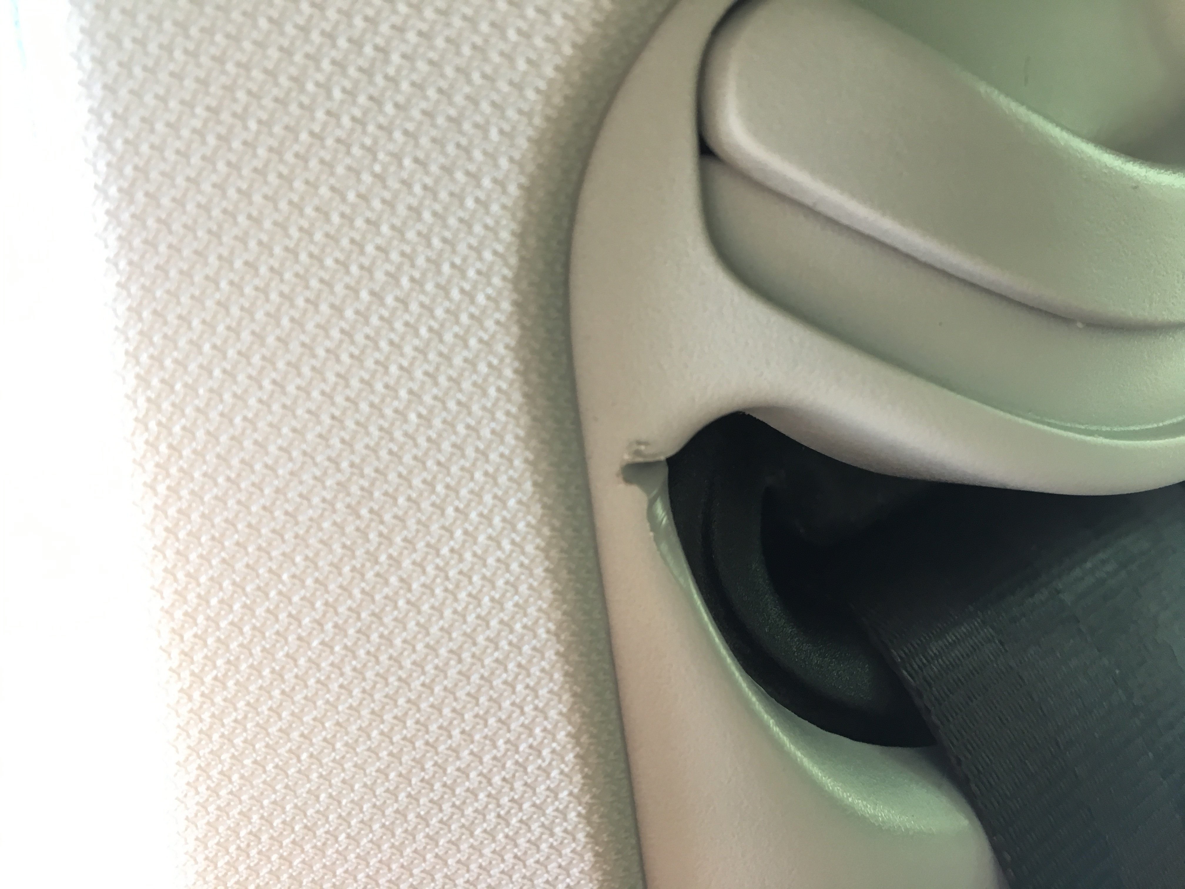

That's where I'm at now!
I have this issue and will be looking to sell my car in the next 6 months (Not due to this, due an upgrade).
Anyone have any idea on how easy it is to replace the plastic seatbelt housing? I assume it isn't straightforward considering it looks to be built into the pillar.
