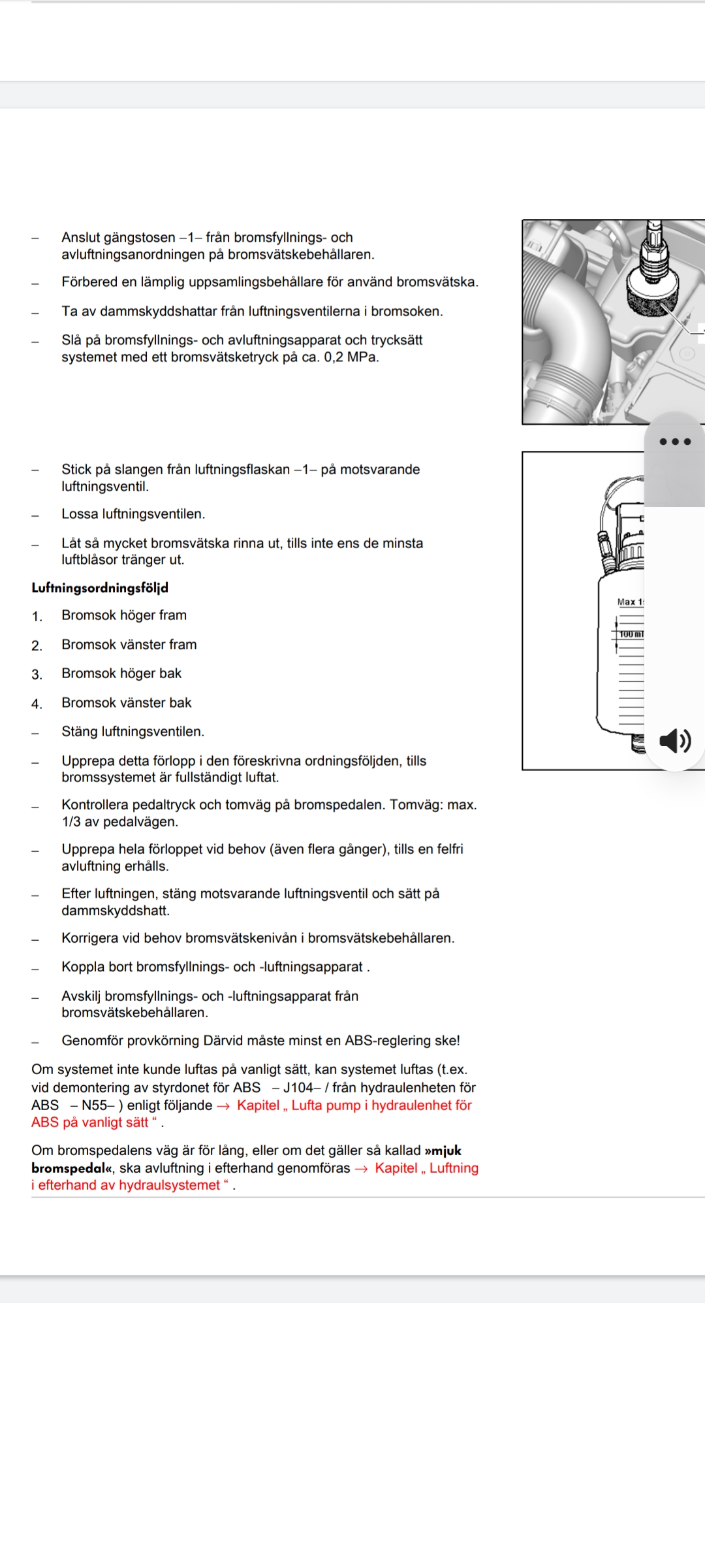

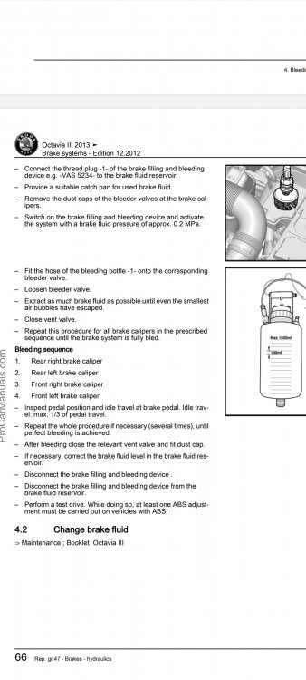

I was attempting to do this service myself but i gave up because of the confusion about different bleeding orders in different workshop books. Skodas Workshop Manuals sequence is rr,rl,fr,fl but the Erwin says fr,fl,rr,rl . I will leave it to Skoda dealer to fix it. Another problem i had was to get the airfilter housing of,( to bleed the clutch slave cylinder)  i managed to free airbox from all hoses,clips...But I couldnt lift it up..Doesnt worth damaging it before i know better...

The suggested pressure for doing it as read from @BerkCo's first image is 2 bar... Seems ample to me to prevent any backflow.

Thanks you very much for your replies.  I have a pressure bleeder that i can attach to reservoir and add pressure. i purchased from amazon so there won't be any problems with air escaping in to the system.  I am not going to change any brake lines or calipers. Just renew the brake fluid.
The second picture i shared is the Swedish Erwin which I obtained with  my chassinumber so it should be the correct. It says: " Bleeding (airing out) order:
1) Caliper Front Right
2) Caliper Front Left
3) Caliper Rear Right
4) Caliper Rear Left
I live in sweden so steering wheel is located on leftside.
Just to add more confusion to the situation. I called another Skoda dealer and asked the mechanic about the bleeding order. His suggestion was to begin from the furthest away from brake fluid reservoir and make your way to the nearest the reservoir.
Once again thanks for all replies!
Greetings from Sweden!
