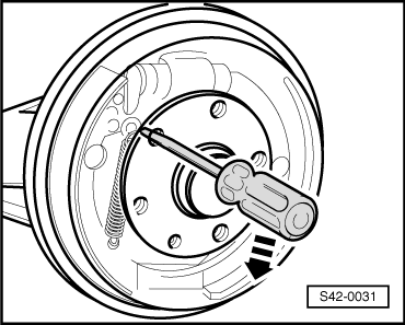

Removing the drum is quite easy. Just remember to push the adjustment wedge up from underneath with a screwdriver to retract the shoes before removing the drum. You can see the adjustment wedge if you shine a phone torch through one of the bolt holes at between 2 or 3 o'clock on right hand side, 9 or 10 o'clock on left side. The wedge is Item 16 here
When reassembling, after fitting the drum, press the footbrake firmly to reset the adjuster.
