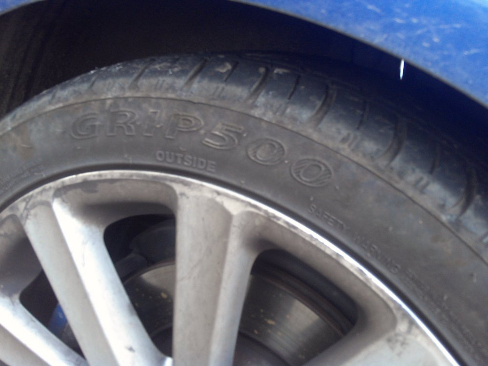

I feel for you, i bought cheap a quite fast car and it had Auto Grip 500 tyres on, just as long as it took to get proper tyres on it which was about 60 minutes.

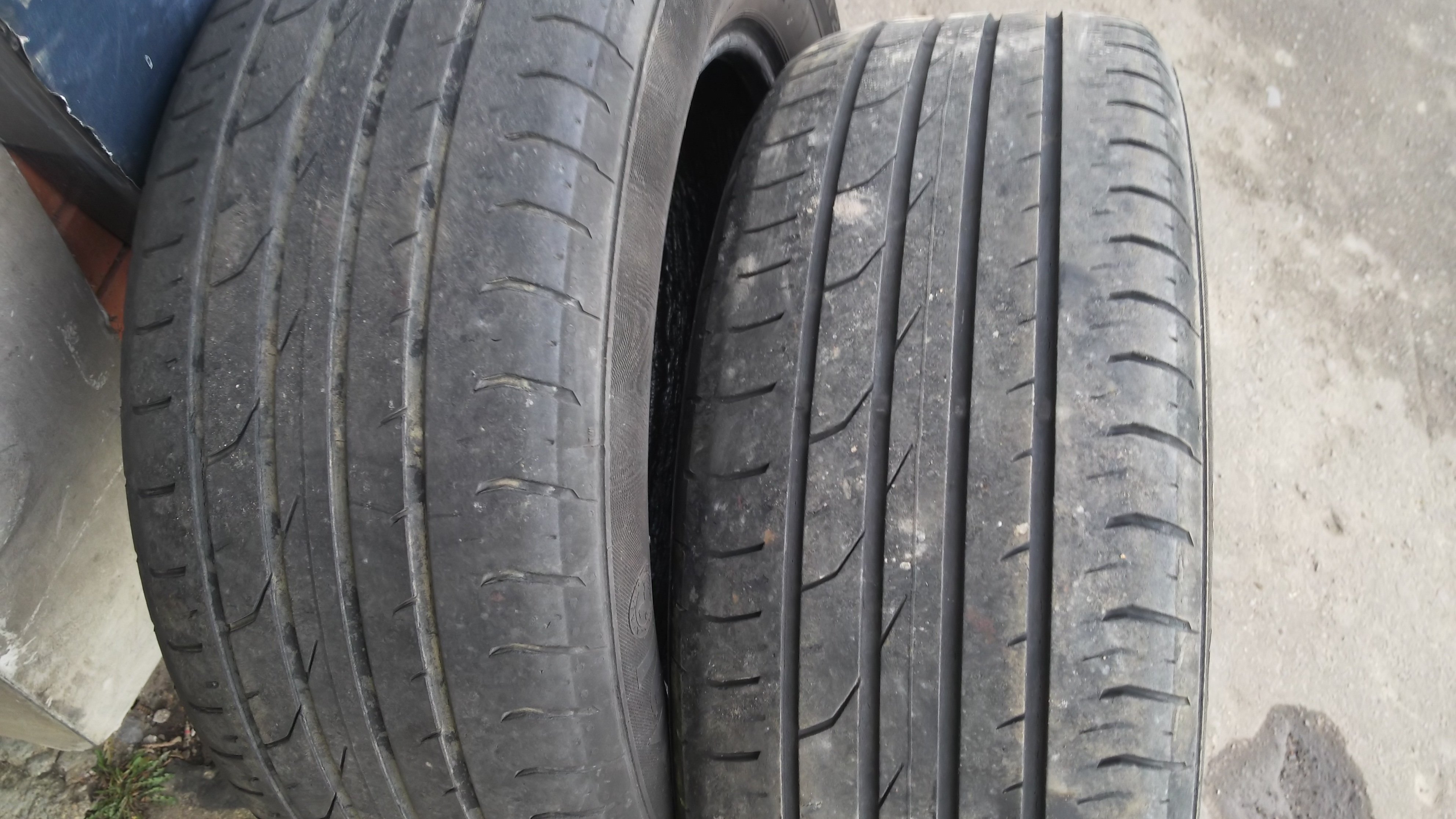

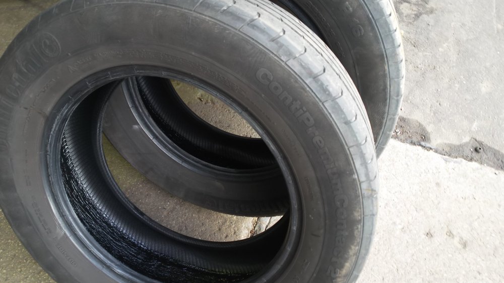

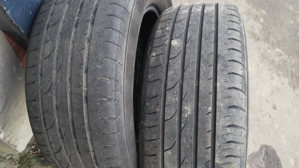

eg.
£150 to replace Continental Premium Contact 2 ContSeal.   Top pictures.
 Not cheap from this German Manufacturers if you have to go buy them, but just ****e on a SEAT 150ps Diesel with DSG.
