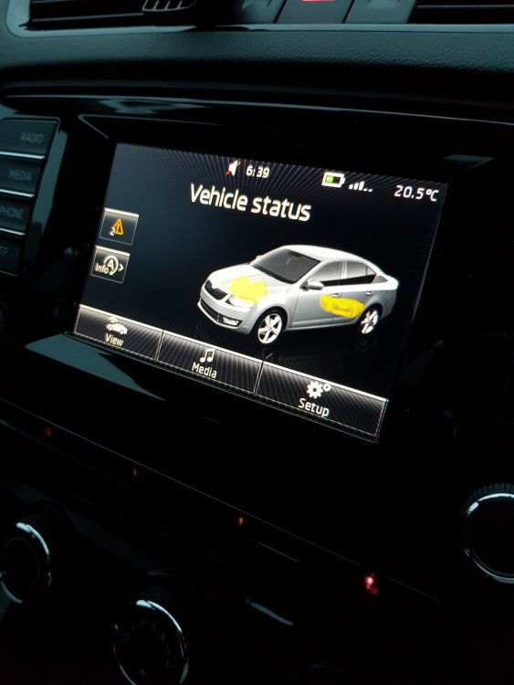

My car is an octavia 1.6 diesel dsg auto and has done about 86000 miles. It has been running perfectly fine until last night when I stopped in the parking space and then when i come back and started it and put it in drive it will only show D and not D1 as normal and then GEARBOX ERROR appeared.
I did notice that sometimes in D3 my car revs a bit longer to change to D4 than normal but didnt think nothing of it.

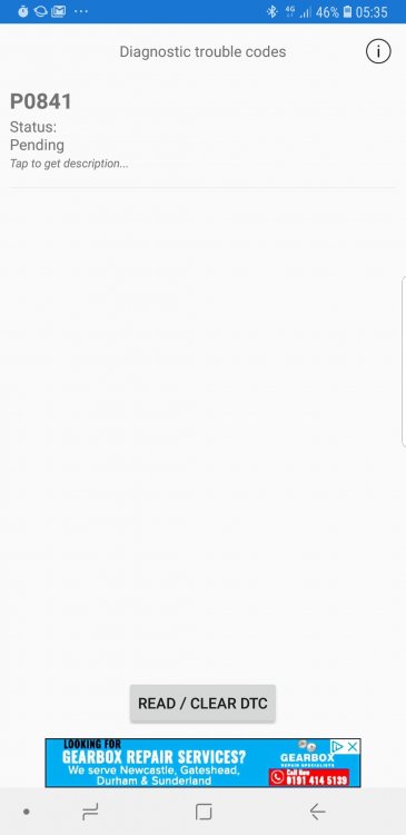

I had an obd2 adaptor and it gave me an error code P0841.
Can someone guide me what could it be or am I in for a hedty shock

Mine just says gearbox error and looking up code on web says it is transmission fluid pressure sensor circuit switch A error which I have no clue
hope i am not looking at about 5k for it to be fixed.
You need to get it into a specialist for it to be properly investigated. Indeed the error code description is:
Transmission Fluid Pressure Sensor/Switch A Range/Performance
It could just be a sensor, it could be an issue with the fluid level, or it could be something else. On the face of it, it doesn't sound like it's on the scarier side of DSG fault codes.

It turns out that mechatronics box is gone. I got a friend to have a look and upon exposing the bottom of car and the top of gearbox, we found leakage and also the black cover on the mechatronics box was bent as if something from inside hit it really hard and pushed it out causing oil leak and error with no transmission working.
My question is that can a software issue cause an item to break or was it just a bad luck for me that it happened out of the blue because i am told by skoda that there is an update pending on my car 34H5 which relates to issues with pressure in dsg transmission and it will be done free of cost from any dealer but if its not the cause of the problem then I have to pay.
