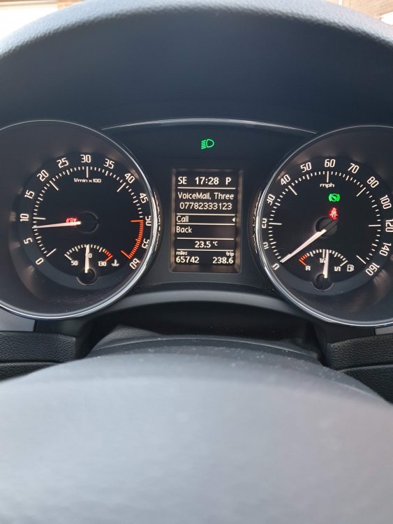

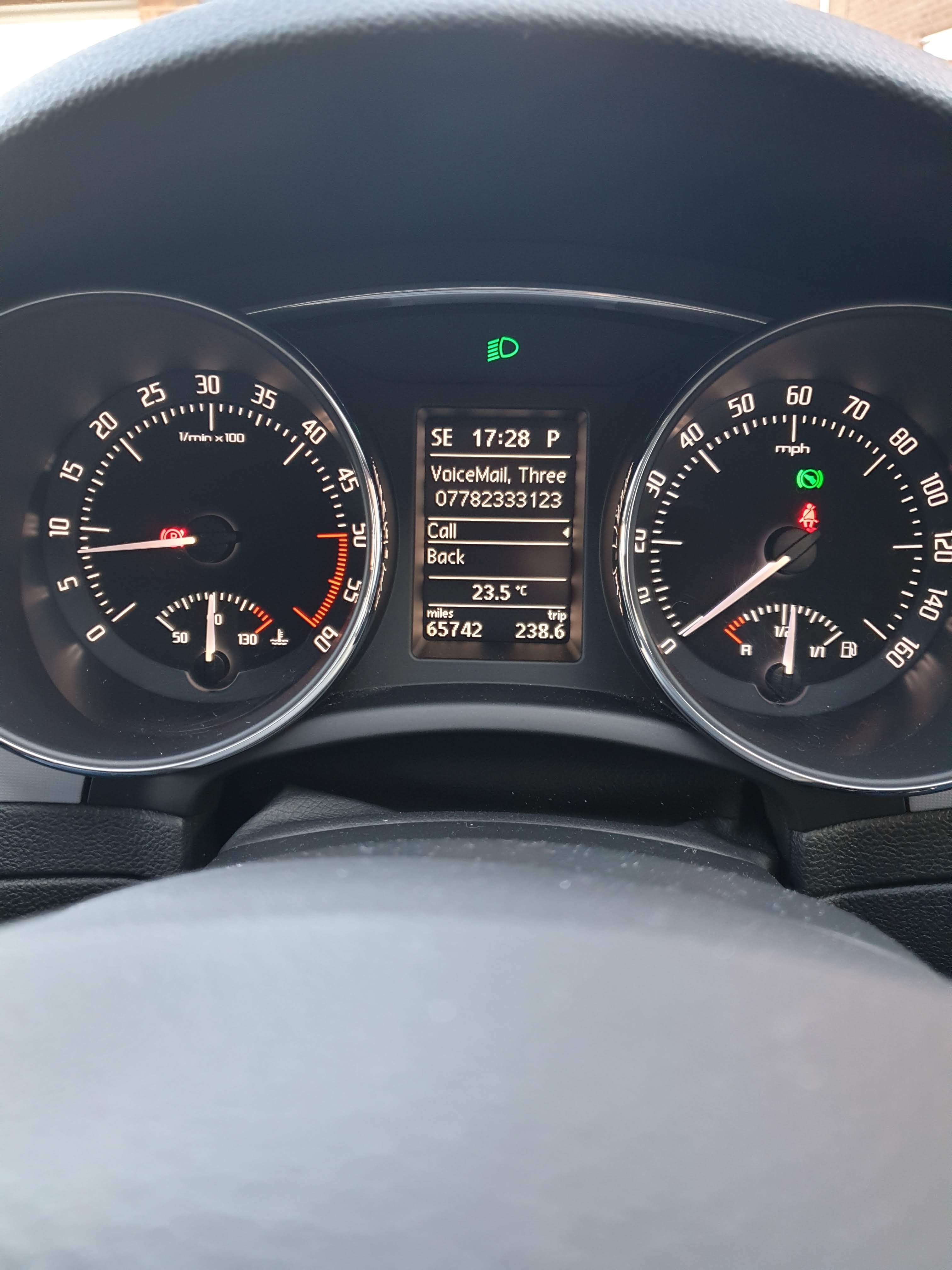

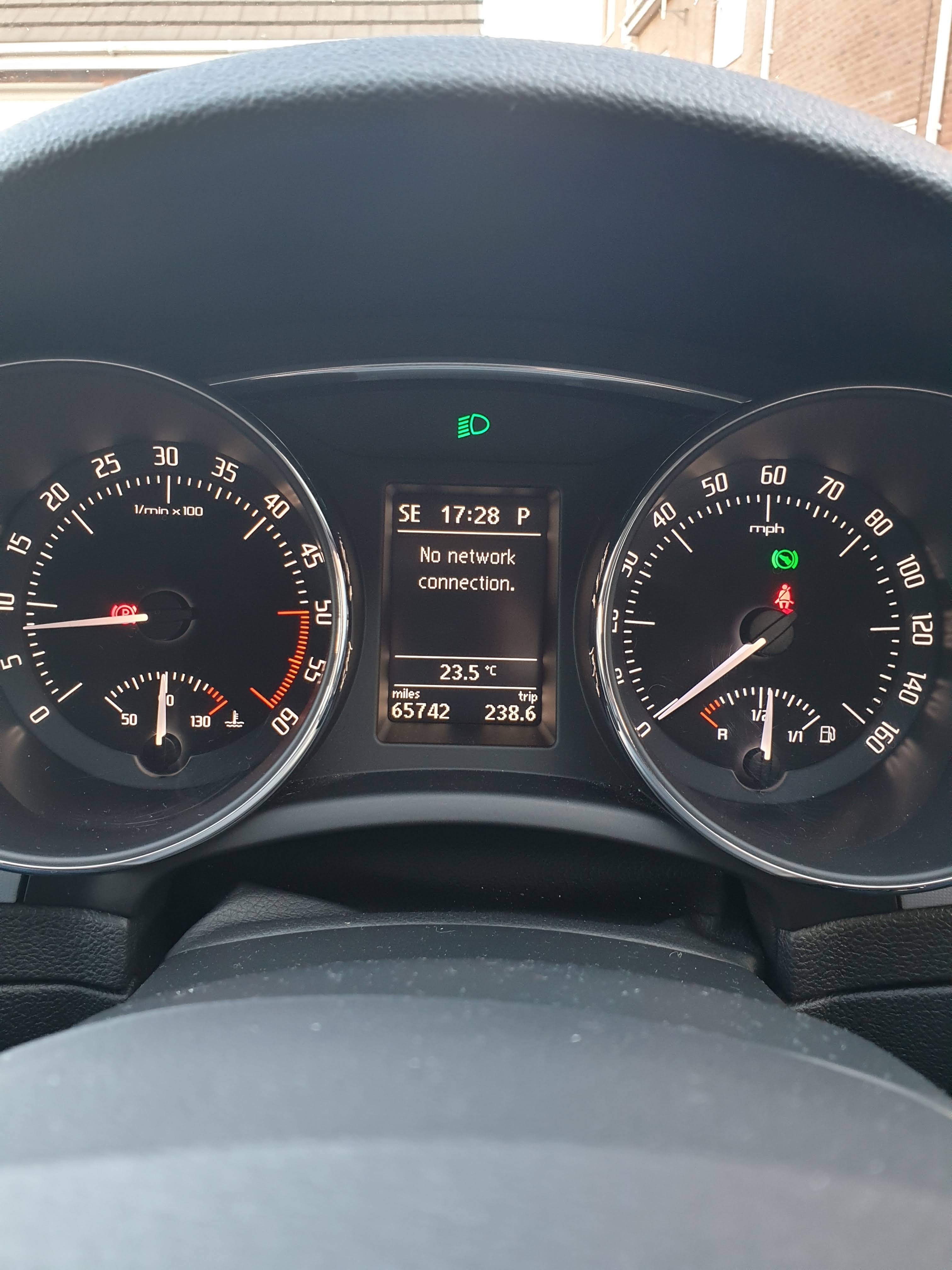

The new phone pairs seemingly without issue, however I can't make any calls via the headunit/Maxidot. I simply get the error 'No Network Connection'.
I can stream music fine, browse the phonebook, and even receive calls which I can accept via the steering wheel etc.. just do dice when trying to initiate the call.
Again, if I dial from the handset whilst it's connected, then it plays and displays the call info fine on the Maxidot.
I've tried connecting in both 'Premium' and 'Hands Free' modes, deleted and rescanned etc.. no change.

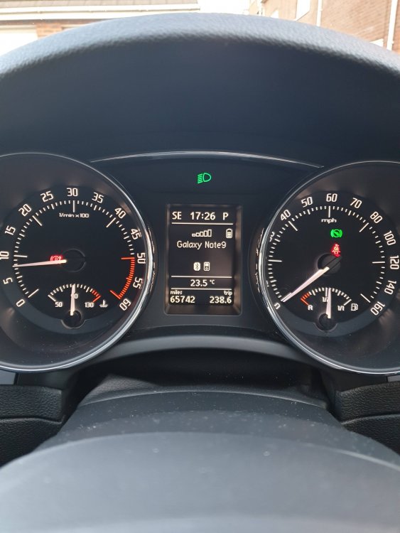

It appears the phone or car has no signal in the first image?
If I were you, I'd check the phone has signal before turning the car on. When you turn the car on, one of two things should happen:
- In rSAP/premium mode, the phone should have no signal as it's effectively got no SIM card. The car should then connect to the network assuming sufficient 2G or 3G coverage (no 4G support).
- In HFP/hands free mode, the phone should continue to have signal and the signal level should be reflected on the dash display.
What's happening in your case?

That's a good point actually, the iPhone would display the carrier (Three) in the Maxidot.. but the Note doesn't.
The phone does still have full 4G coverage though, as I say, I can initiate a call from the handset without issue and the call details etc then display on the Maxidot.. I just can't actually make the call from the car, only the handset.

"No network Connection" is the message I get when I drive through a no signal area and your phone is also not showing any signal.  Try another sim?

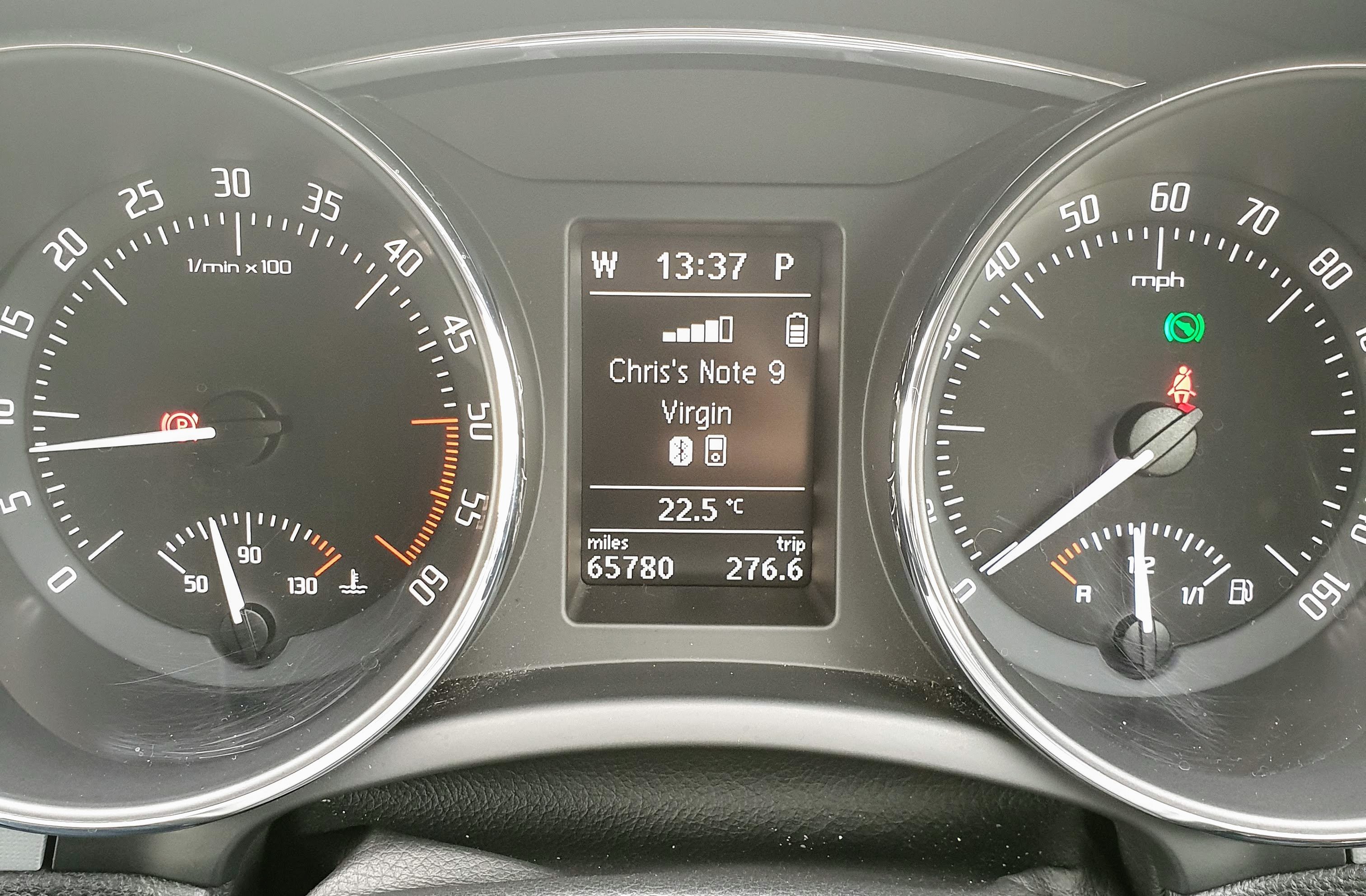

As soon as I put my other half's Virgin SIM in my phone - all issues disappear and the phone behaves as expected. :(
