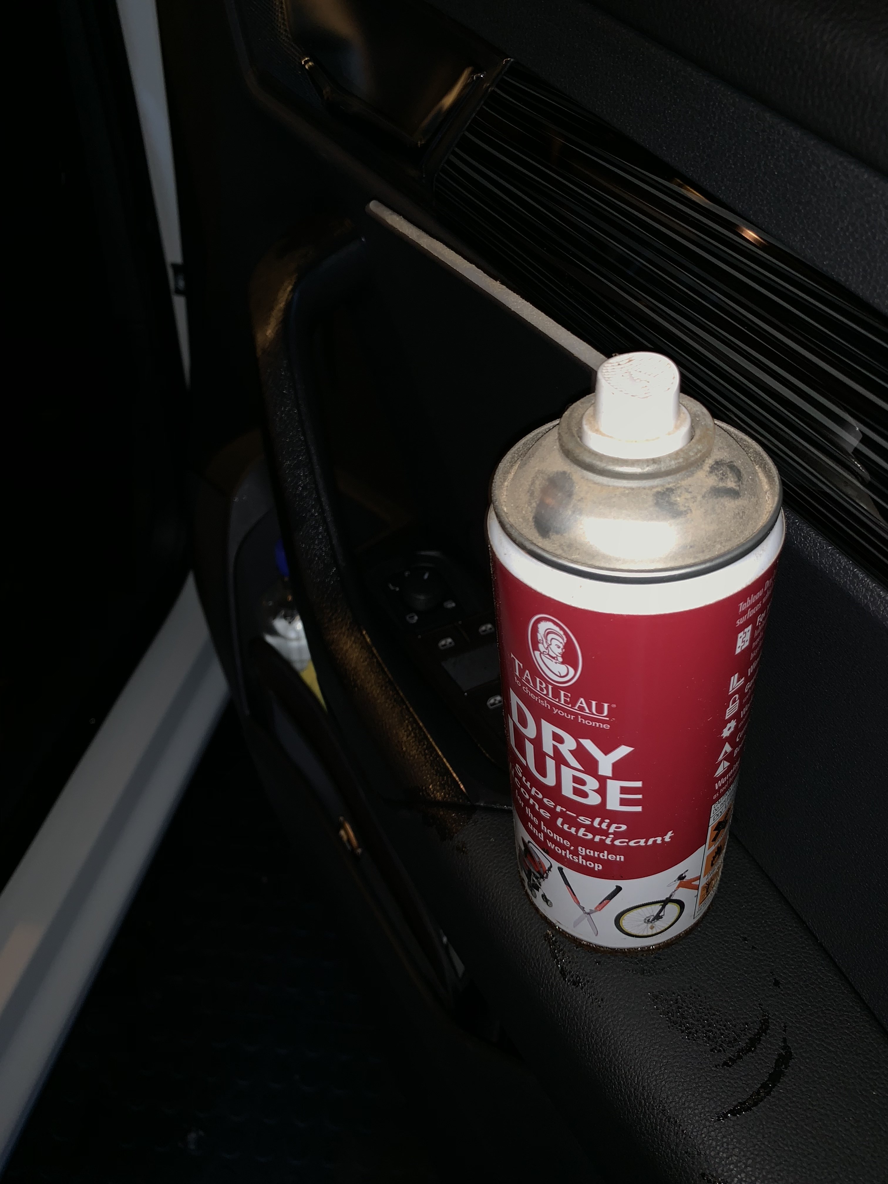

Sorted

Seems 100% sorted I carefully ran the spray using the straw along all the joints including around the window switches and the top of the handle
left it for a few minutes and then wiped everywhere
