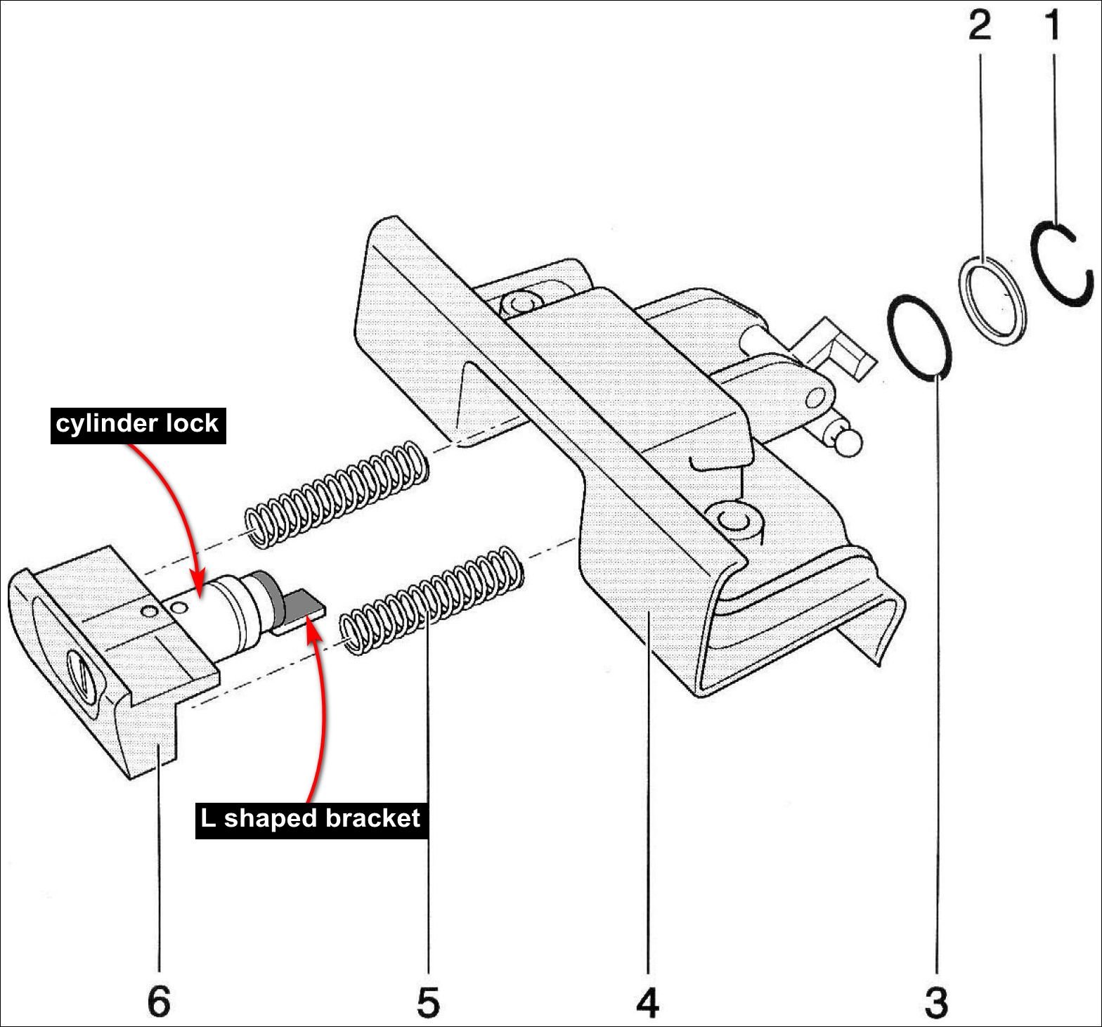

The key won't turn in the lock of my Felicia estate. It's currently in the 'unlocked' position and I believe that the central locking doesnt operate the tailgate as well. I've checked the spare key and that won't turn either. Any ideas please?
Thanks in advance.
  1. The cylinder lock may be broken, or
  2. The L shaped bracket may be damaged preventing the cylinder lock from turning.

Thanks for that, very useful. Can I buy a replacement cylinder? Will it come with the bracket? Is it easy to replace, bearing in mind that I am somewhat limited in my techincal capabilities?
