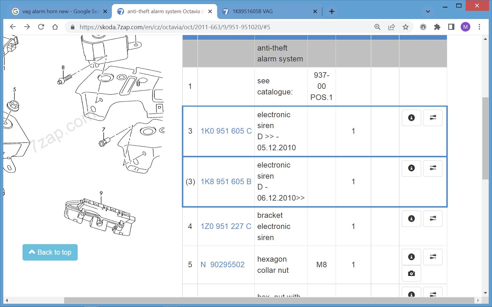

Ah, I think you may have mis-read 7zap.
According to the LLL link I posted above, the previous version to 1K8951605B  was 1K0951605C.

Pete, here is the page with information in two blue boxes

Yeah, same as on lll, but different from what you posted in your first comment 4 hours ago ^^
What I'm saying is that I don't think 1K8951605C exists, nor ever has done.
In my interpretation, D >> - 05.12.2010 means all dates before 5 Dec 2010 [for the C version]
and D - 06.12.2010 >> means from 6 Dec 2010 onwards. [for the B version]
How do you read it?
  • Sponsor
It's the third character I'm trying to draw attention to, 0 in one case 8 in t'other. Different base part numbers.
I thought that the number in that position has only 3 uses or versions, 0 = not sided, 1 = LHD and 2 = RHD, so I wonder what 8 could mean, or has VW Group numbering moved on a lot since I first looked into it? Maybe there were a couple of other numbers to denote hatch or estate, thought I could be wrong there. In this case I would think that they all would have a "0" in that position of a part number that would be "not sided" or "not handed".
