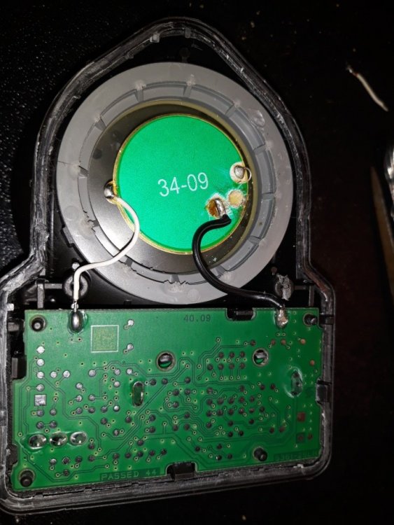

guessing I got a fault unit from scrappers, fitted it, when alarm triggered flashing lights but no siren 😞
I dont believe the unit needs coding or anything else? strange thig was the unit had a rattle, like a SMD component was loose in side
  • Sponsor
Shame. Doubt there's any coding involved.
If you post it to me I could have a look and maybe fix it for you? PM if interested.
scappers is off to swap it, if they said they didnt want it back, Id happily open it up myself lol
If battery on one I took off the car was leaking it was going to replace it, but voltage is still holding over 6v and looks fine
So only thing i could guess which maybe causing fault is the 3 capacitors, which i could swap, but thats just guessing 😞
  • Sponsor
Electrolytic capacitors can rattle if they dry out.
this sounds like its falling off, can here it rolling about inside 😁
  • Sponsor
got replacement, thats fixed the error on the alarm horn, onto next now 😞

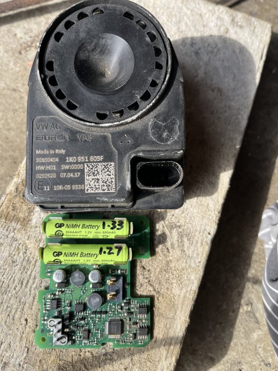

If anyone's still looking at this after three years I wonder if these alarms will work without the battery? I've had two which have failed because the battery's leaked so is it really necessary?
Usually if the battery leaked there will be (perhaps unseen) damage which is terminal.
My experience is that false alarms can generated when the battery is kaput.
Thanks, I was wondering if I could remove the battery before it had a chance to leak and would the alarm still work, as after all there's a battery in the car.
I haven’t had any faults yet but been reading the complete yeti service manual that says the alarm battery supposedly should be replaced every 6 years.
I presume the backup battery is the same as the OPs.
Varta 5/V200H are showing as available on some battery supplier sites, relatively expensive.
Note the fleabay listing using pic from here doesn’t show a pic of the actual battery - the sellers other listing for the same battery code has different solder tabs so not a simple swap.
Varta V200H individual cells are available (eg from TME for not much). Chinese lithium powered battery spot welders are great for joining cells using nickel strips. I have an FNIRSI one.
Varta 5/V150H is available (eg Conrad), smaller capacity and different solder pins and costs similar to the correct one. At least should keep the computer happy.
Varta CP300H (300mAh) is cylindrical and a bit longer (up to 10mm) and wider ?12mm but same height. Looks like it should be able to fit in the case with a little internal modification. I’m half inclined to try using flexible wire so the battery can be stuck in the case rather than soldered on the board. RS pro has the same battery size for half the price of Varta.
If happy to not have a backup battery, the circuit could be modified to get 6V from the car battery, which should keep the computer happy. I presume there is a 6V supply on the board already somewhere.
