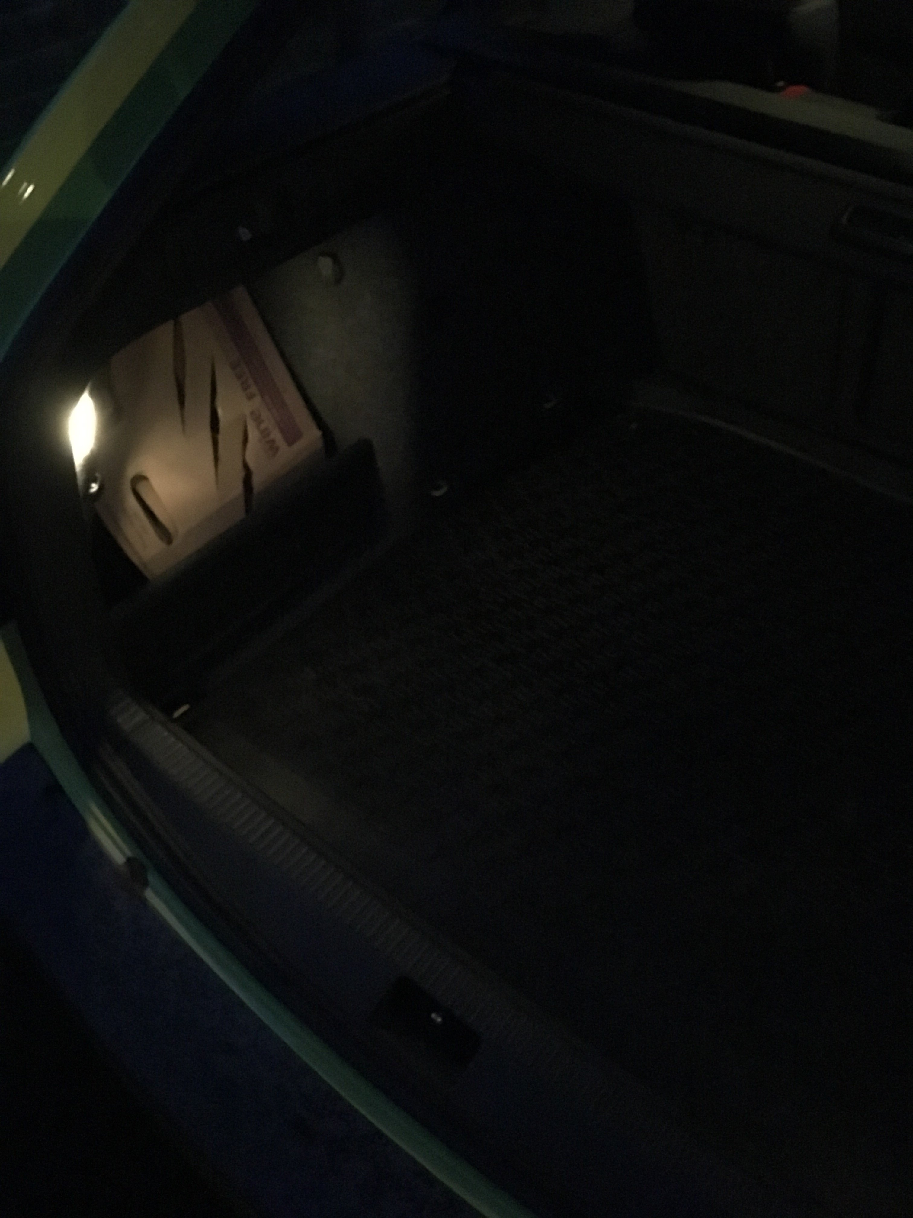

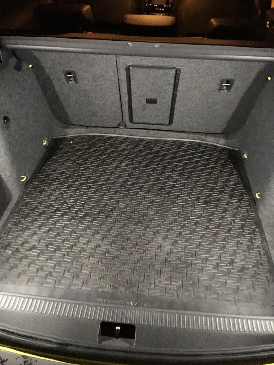

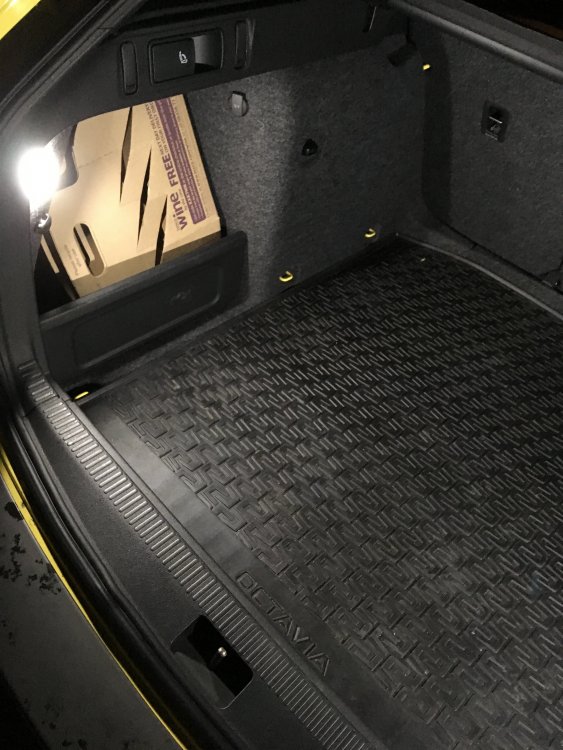

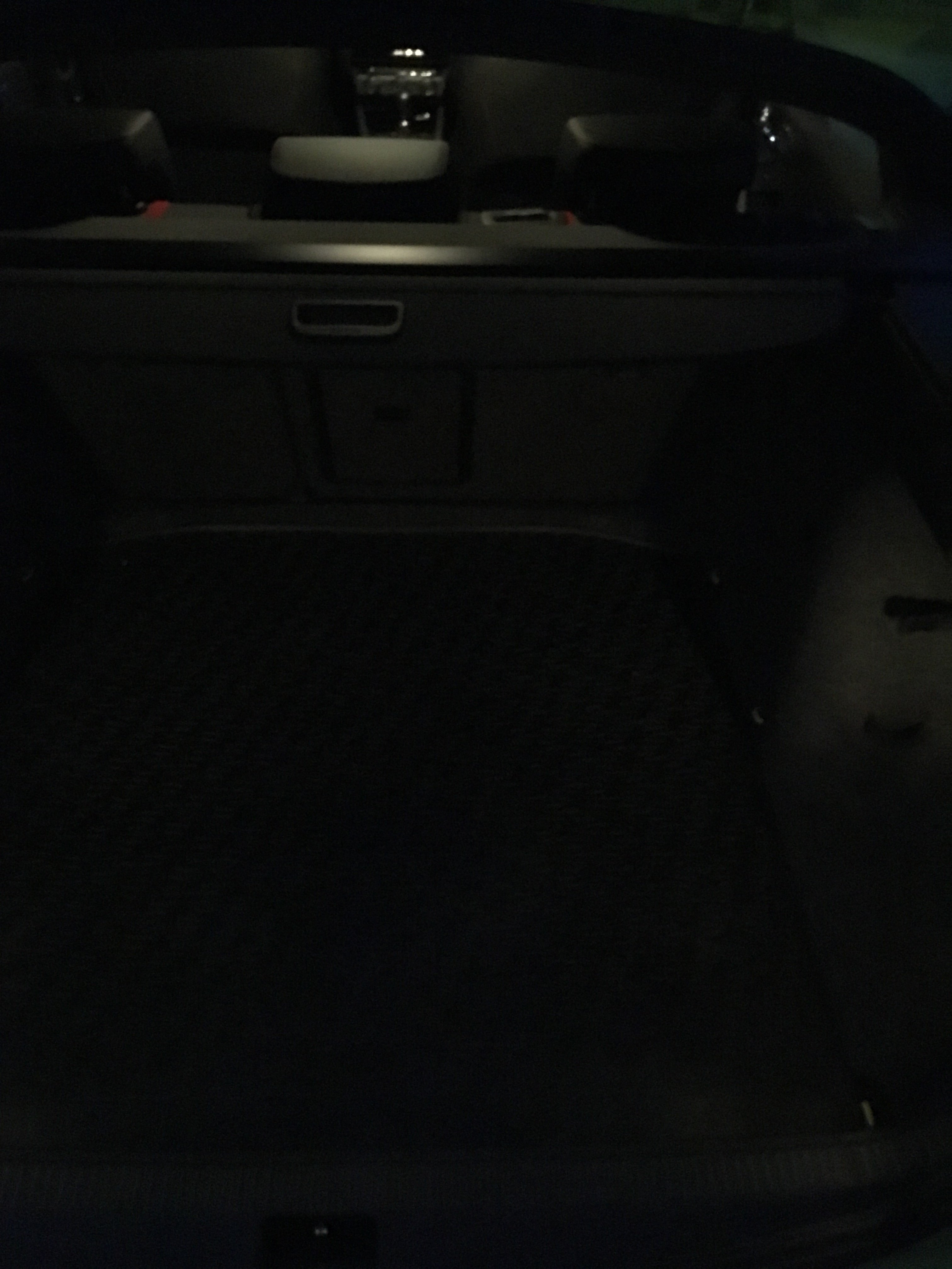

Before and after photo's, taken three minutes apart, same iPhone SE, no flash and no change in the ambient light, and I'd say what the photo's show are a pretty good depiction of what you get:
Having seen the difference, MrsV6TDI now wants me to do her Polo, so they also come with the SWMBO seal of approval (quite unusual).

1 hour ago, V6TDI said:
Just changed mine for these :thumbup:
Gaz
They look amazing, seem a bit steep at 35 euros but worth it if they do the job. Can anyone else show their osram versions at £10 a set for comparison?
