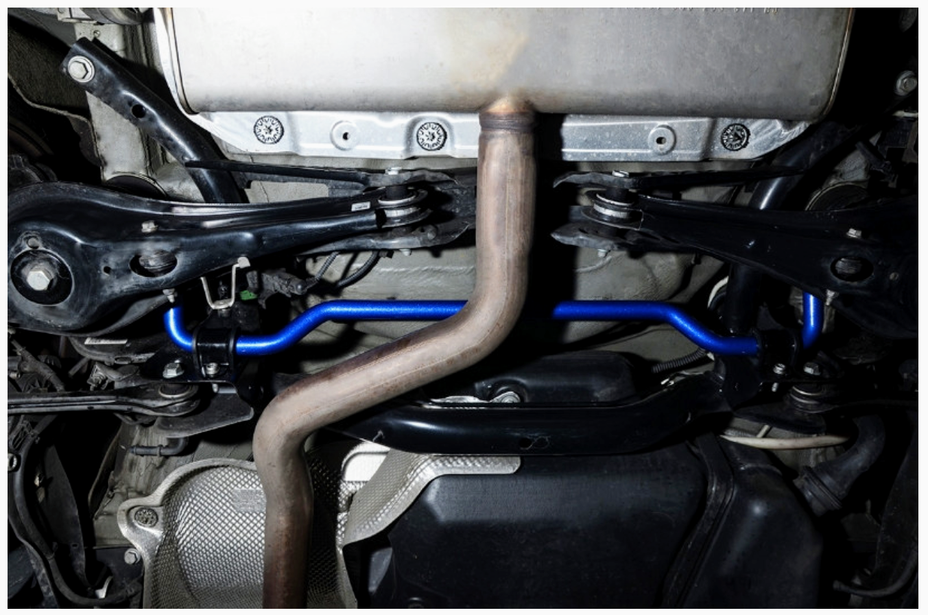

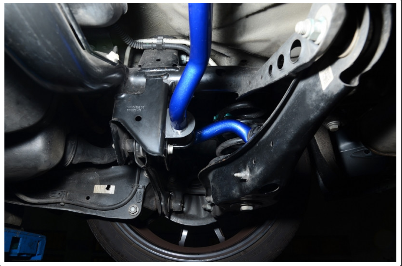

I've had a quick check of other marques/models to see if there's any chance they are available but just not advertised for the Superb.  If it's any help, (from my quick googling) I think any bars advertised to fit a SEAT Ateca, VW Passat, Arteon, or Touran would also fit the Superb as they all have the larger MQB chassis/suspension setup.
I got confirmation from Whiteline that the mk3 Superb FWD shares the same rear sway bar as the mk7 Golf GTi.
Similar to the Superb AWD is to the mk7 Golf R.

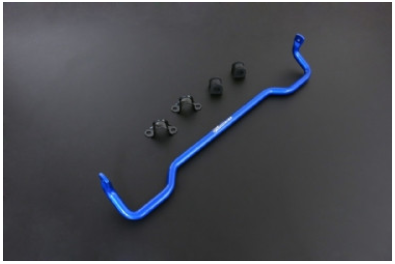

Nonetheless, I've decided to go with the Hardrace 25.4mm rear sway bar.
It's not adjustable, which I'm not fussed about.

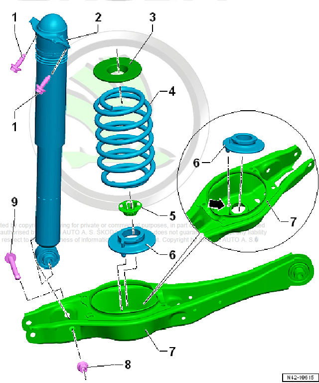

One of the things for me is I like the gap between the tyre and wheel arch the be more or less equal all the way around. Some of the pictures I've seen online make it look like the top of the tyre is almost in the wheel arch, and I don't like 'obviously' lowered look.
I thought maybe there may have been some spacers that the springs could mount onto the make back up some drop. I guess it would be possible to get some made, but could prove costly.
I'm on the same boat. I don't like when at the top of the arch, the gap between it and the wheel looks "squeezed", that shouts "I lowered my car" to me and I don't really fancy that. Some photos of Superb Estates on Eibachs looked a bit too lowered for my taste so I had abandoned the idea but looking now at @JR RS 's hatch above and even clearer at @Enriquez car (hatch also) who was kind enough to send me a full album of his L&K on Eibach Pro Kit a while ago, this seems to be the perfect drop, no?  I don't know if for some reason the hatches drop a bit less than the estates, but from the photos I've seen the hatches seem to be on the ideal drop for me.
