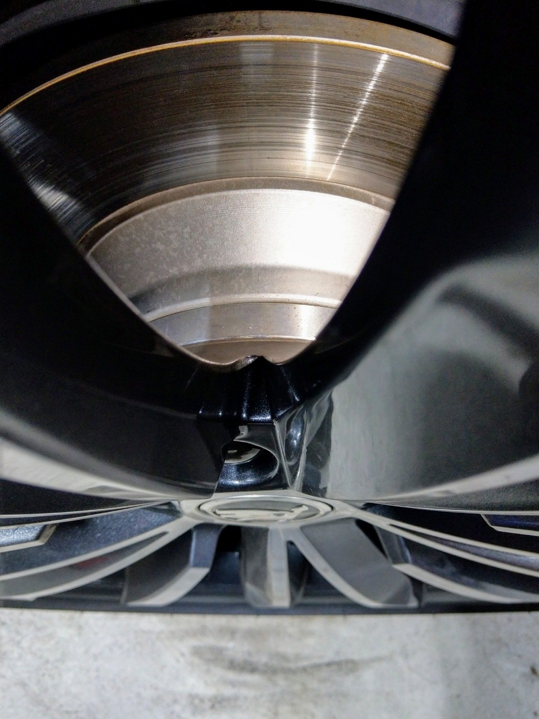

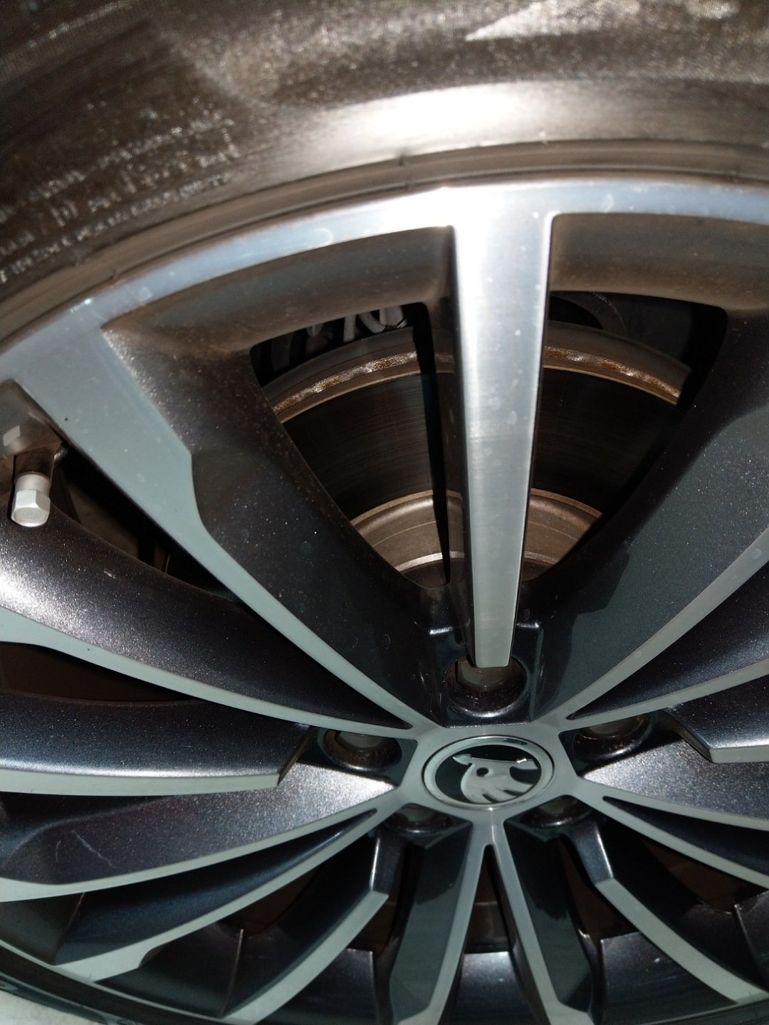

7 hours ago, ope126 said:
JR RS,
Any chance of a close up picture of the wheels / brakes to see what the spacers look like.
More so to see how they look sandwiched between the wheel and rotor hat.
What a nice stance though...
Thank u 🙂
Pics as requested.  To the untrained eye, u'll not notice it's there, and that too only if u actually look closeup between the spokes.
I've got black spacers up front and silver/alloy ones at the rear.
front

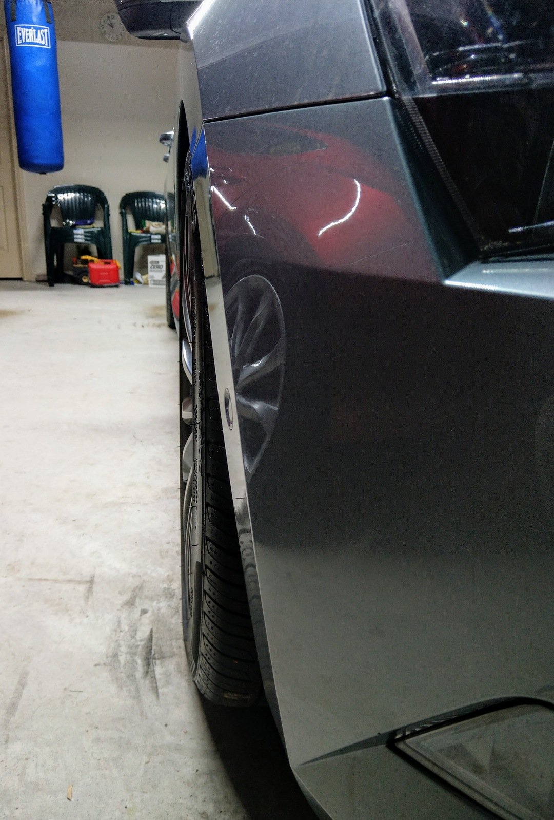

    Spacers arrived yesterday, here's what they look like on standard sportline suspension.
Another "must do" mod on this car (or even better some lightweight alloys with smaller offset - two birds with one shot).
Looks so much better and 100% OEM still 👍
Looks great, nice work 👍

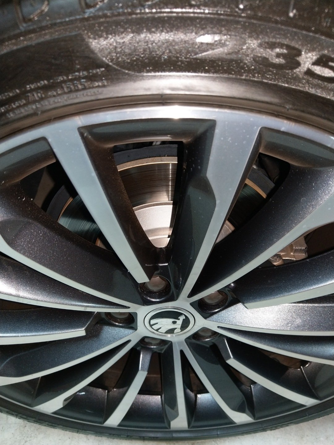

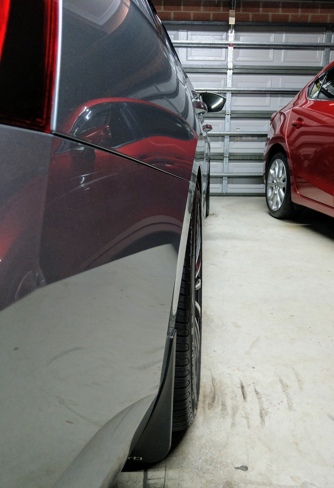

This is wat 15mm looks like.
Front

Rear

Just wait until you get those 245 tyres JR RS...😀
14 hours ago, JR RS said:
I think 13.4mm will b fine n not stick out.
Front
