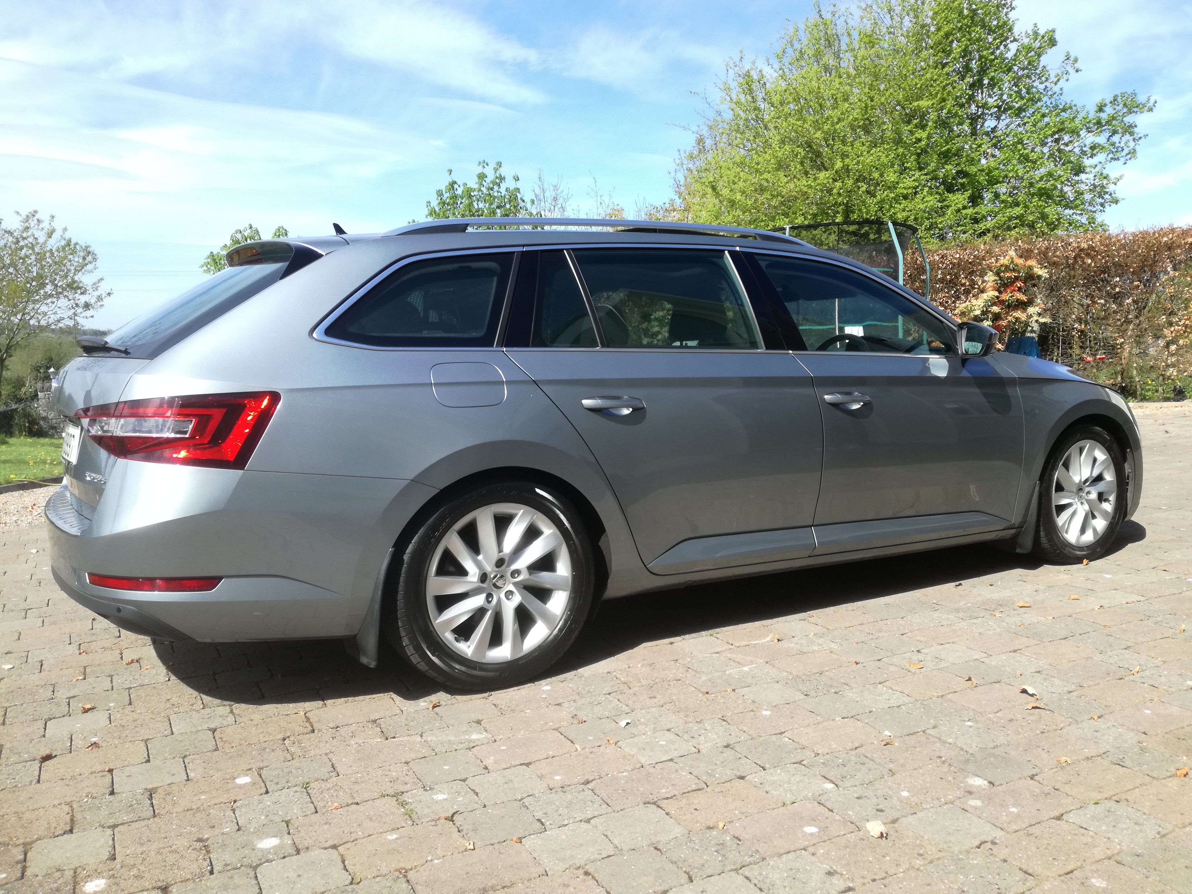

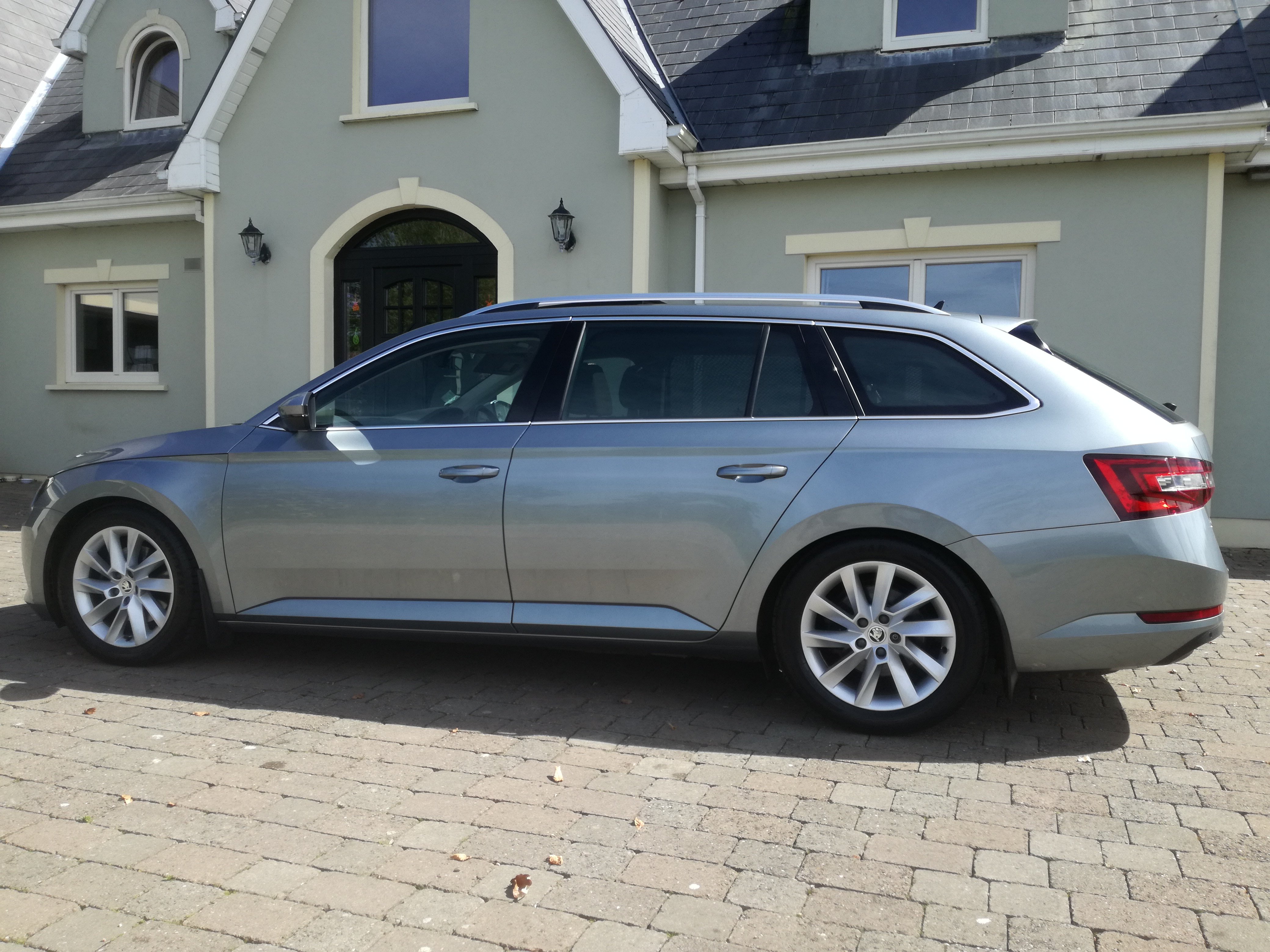

Gave it a quick wash so I could post a few pics....
Nice house BTW.
Looking good mark
@Esseesse200 Cheers just need to sort some dampers and then maybe consider a power hike, no rush as it will be a keeper

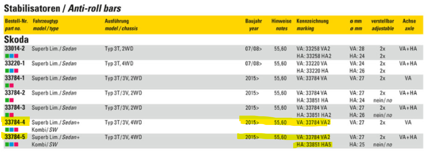

Update: Just ordered the H&R rear arb :) , to heII with procrastination. I had this upgrade in mind since before even picking the  car up, it's cheap, easy to install (I think, haven't done the installation on AWD cars and not sure whether I'll need to remove more parts than usual) and huge bang for your back in the cornering department.
So I guess stay tuned for the findings of its impact...
1 minute ago, Esseesse200 said:
Watch out as the quoted front & rear set is not the correct one for the 4x4 models. According to H&R's catalog the model numbers for the 2.0 TSI 4x4 (both hatch and estate) are:
33784-4   - FRONT only
33784-5   - FRONT & REAR
33851 HA5 - REAR only    <<< That's what I got
Oooosh steady. Cheers mate.
