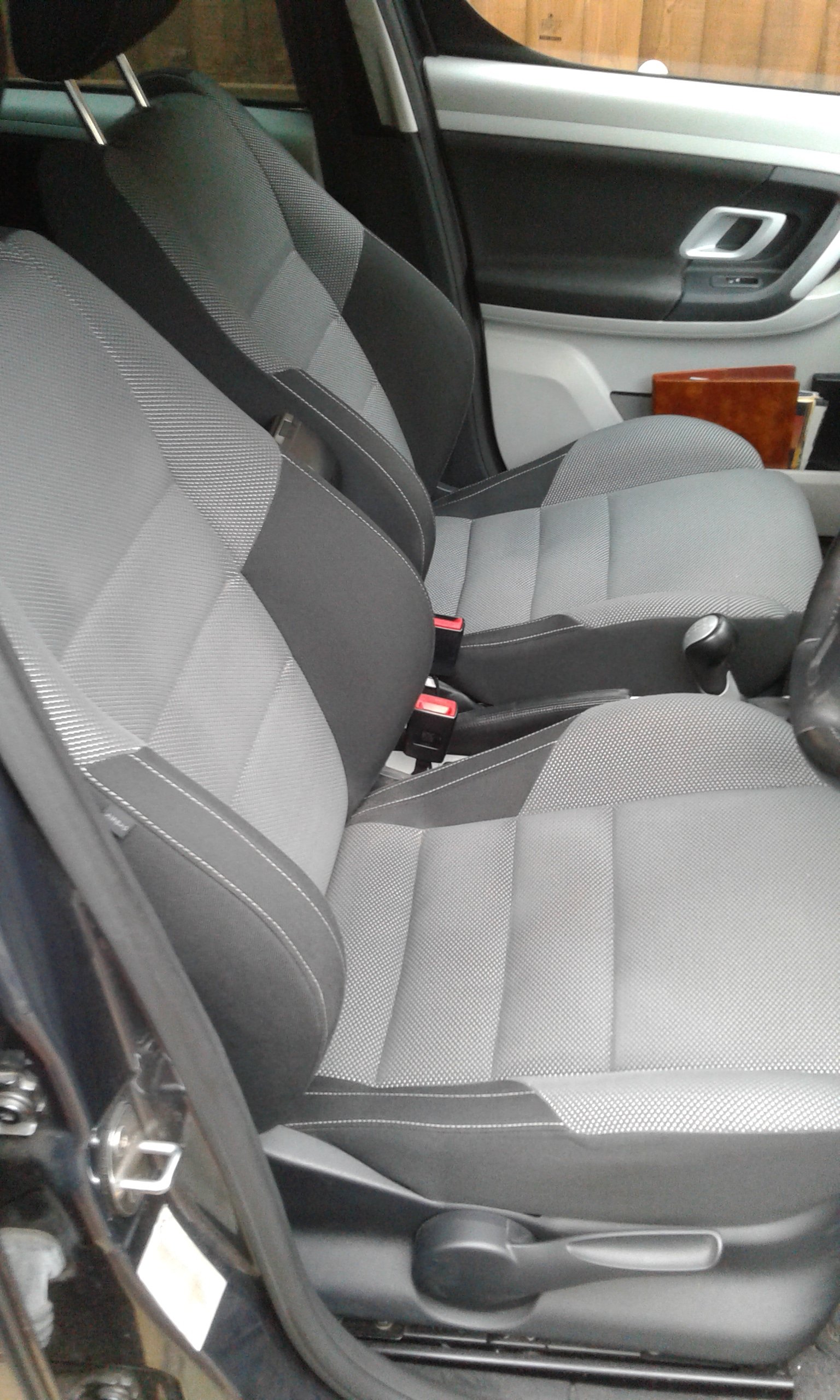

Has anyone ever taken the center console out of a Roomster.
Could not find anything on site, the closest i could find is a Fabia, which does look the same ?
Hi, don't know if you've had any success with this but it's a relatively easy job. Just need to remove the side panels from the main upright strut at the back of the armrest as it meets with the console.
Hi, i had a bit of a go last weekend.
There isn't an armrest, once I found the hidden screws it seems that the console then slides back.
I'm waiting for some good weather to put some heated leather seats in, but just looking at how to fit a loom etc before hand.

Hi Pete, if i think about it, i might just do that.
I have fitted different seats in the past, the last ones i fitted were from a Fabia Monty Carlo.
I was worried about the wiring side of things, but got some great help from people on the Fabia site.
My biggest problem are the switches, that's why i was looking at taking the center console out to see what space i had, there isn't a lot .
On the heated pad side of things, my local Aldi are selling heated pads that just sit on top of the seat, and plug into cigarette lighter, might be easier for me to do that, but i've bought the loom now.
