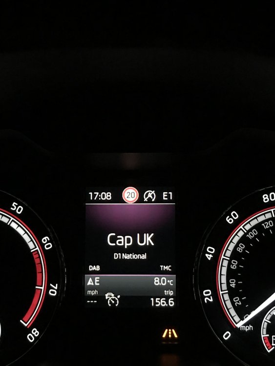

I have recently did the TSR coding through VCDS. When I start the drive it says no road signs available. Then it picks the first one up but I also get an error message. Which says: Dynamic road sign display currently restricted.
but it does work. It gives me all the speed sign. No overtaking too. It displays them on the Amundsen and the Maxidot too. But this message comes on 500 metres after I pull away. It goes away once I turn the ignition off. It can’t be a critical error as it goes away with the ignition and when I restart the engine is not there. VCDS couldn’t find it as an error code either. I have the latest map on my satnav.
