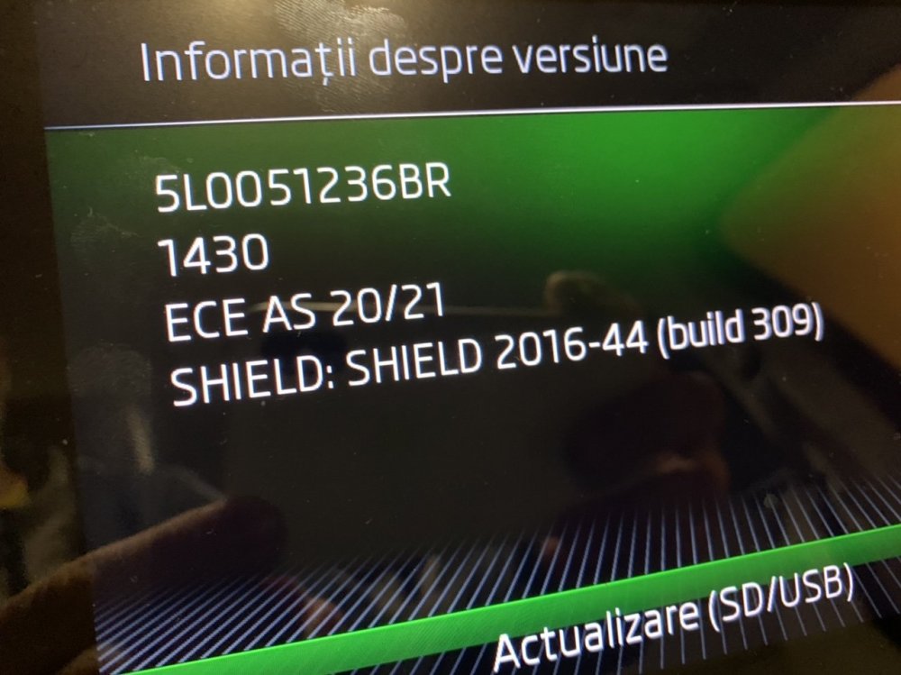

My Nav shows the following:
5L0051236BJ
1310
ECA AS 2020
SHIELD: SHIELD 2016-44 (build 309)
Anyone know if that is the latest? I'm hoping the 2020 is a clue ... But I am however pretty clueless.
5L0051236BJ
1310
ECA AS 2020
Thanks
There is a newer version available - ECE A1 2020/2021. Here's a direct download link from the Skoda Update Portal:
http://infotainment-cdn.skoda-auto.com/base/maps/STD2_1410_EU_A1_202022.zip
Alternatively, if you visit the Skoda Update Portal and enter your vin you will be provided with the same link when you scroll down the page:
http://updateportal.skoda-auto.com/
Thanks. I might have a go with my old 2018 card now I have the 2020 to fall back on, I didn't fancy risking cocking up my only card so I got a spare (spec as above) and tested it works.

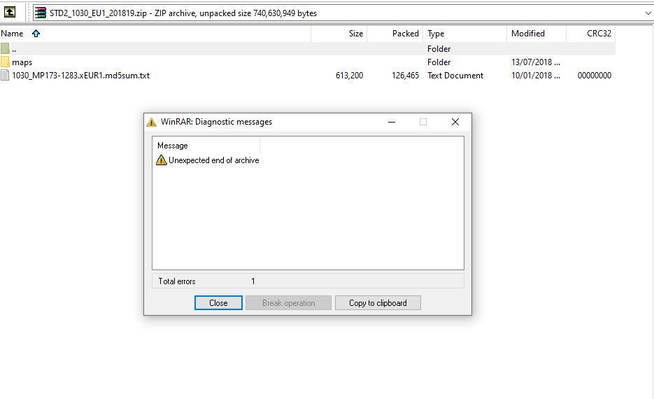

How long does the download / transfer process take ?  I downloaded and unzipped the file but when I went to transfer the new maps file onto the Skoda SD card my computer was estimating 5 hours to do the transfer. Any ideas ?
Problem solved, it didn't take as long once the transfer got going, BUT am I glad I kept a copy of the original maps on the computer ?
A map download should take around about 30 mins on a good connection, several hours on a bad one, my PC copies (unzips) the download to the memory card in about 15-20 mins or so.
No real need to keep the old maps, they just clutter up you hard drive, if you really want to I suppose you can always archive them to a bluray disc.
