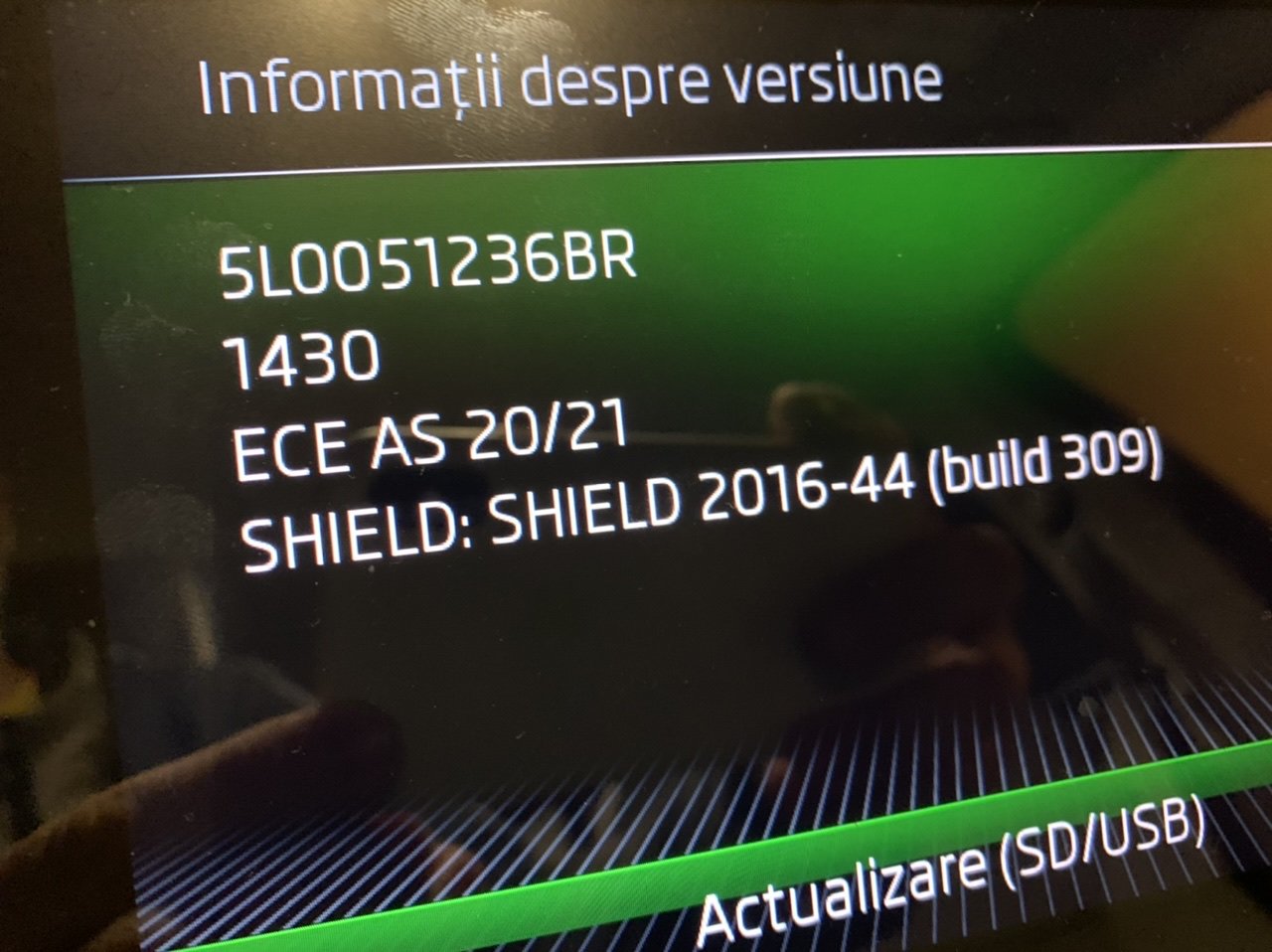

@Kenai: you're right, the latest Skoda is version 1310. So I'm now trying to download the vw files and see if it's working. Thanks!
Also, ny 2017 SD card has the code 5L00...
Update finished! Downloaded the files from vw, unzipped and copied the resulted maps folder to the sd card. Size seems larger than Skoda’s 1310 version. Hope that Romania’s map is full (says it is partial)...
And just to add that my card is the 16GB one and the VW "maps" folder size is around 15.5 GB while the Skoda was almost 1GB smaller. Both fitted without problem on my sd card.
