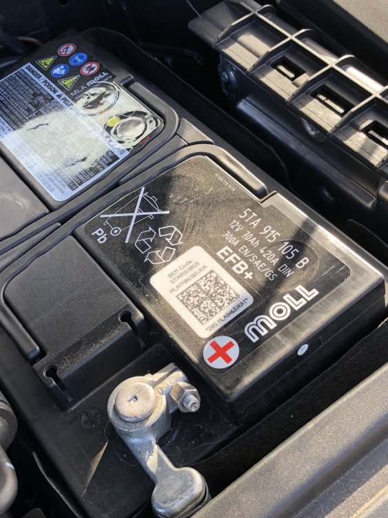

 We're just getting battery in our 16 month old Superb replaced under warranty due to it suddenly deciding it didn't have enough power to start the car.
  The garage told us that Skoda have been having 'issues' with batteries manufactured by Moll.
Mine was by Moll. The new one is Varta (Johnson). Same capacity/CCA/type though.
I've checked and it's a Banner battery.

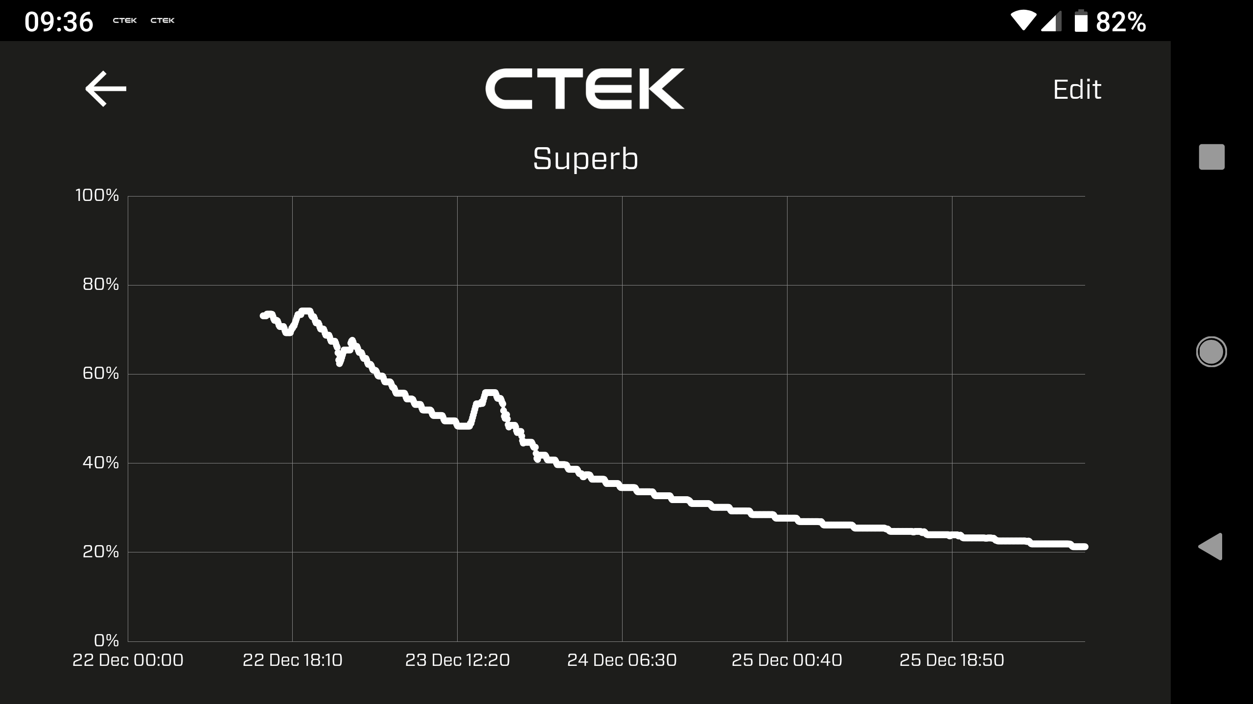

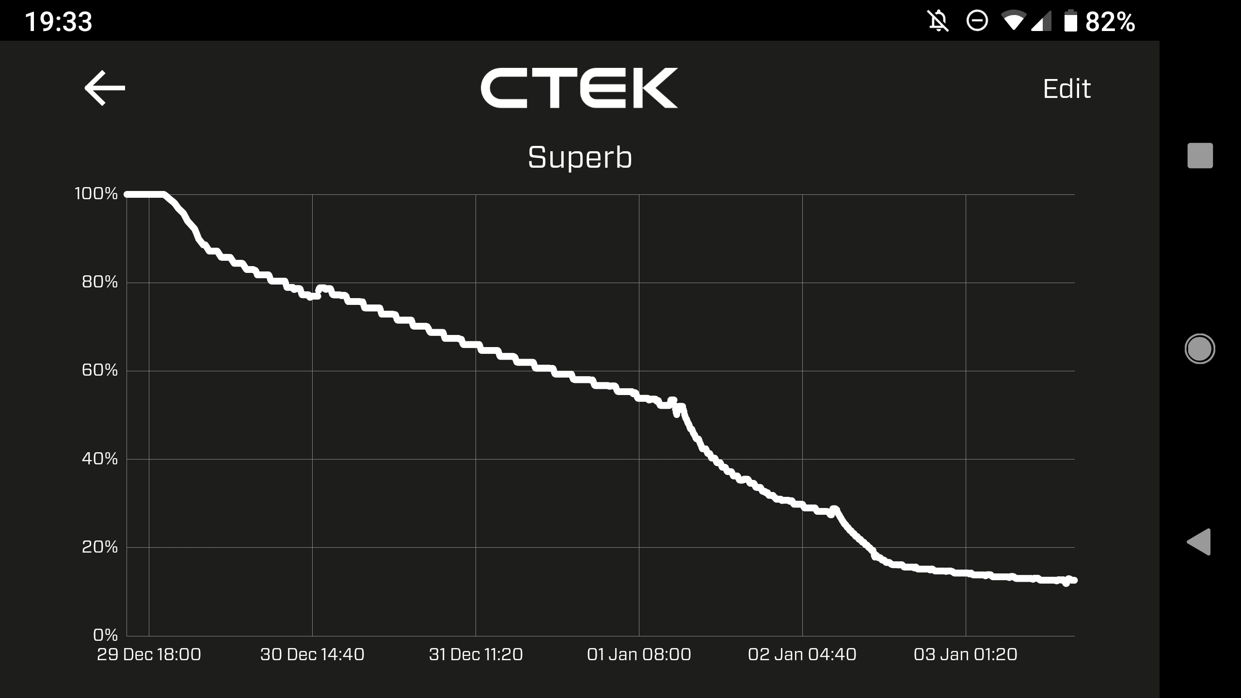

I've connected my CTek sensor.
Not entirely convinced that what it's telling me it's accurate, but the trend isn't good
I'm going to do 200-300 miles over the next couple of days so I'll see how well it charges
