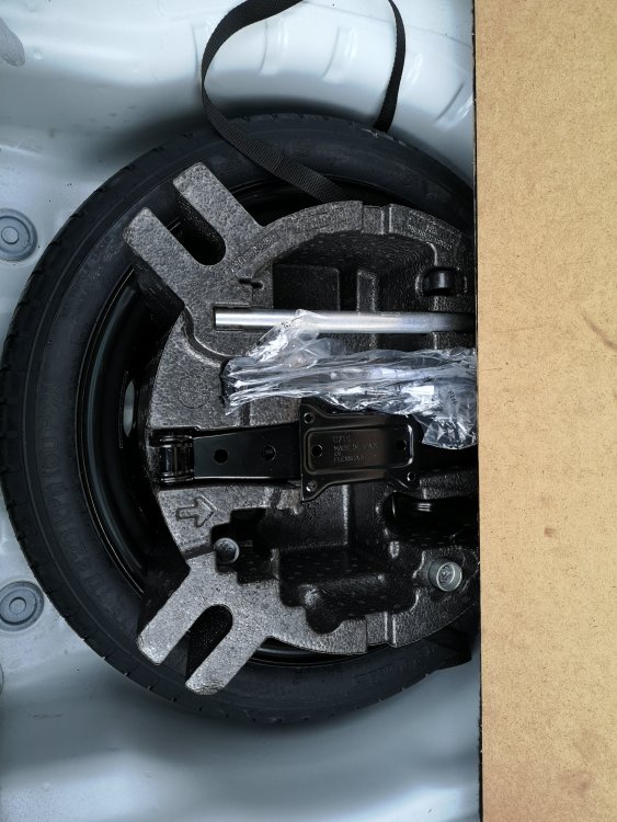

What should be in the polystyrene insert for the 18 inch space saver?
There are 2 large voids in the side that I can't work out what they're for?
Does the compressor fit in somewhere and the tyre foam from previous setup?
Ta
Hey DC04R, I've had my spare 18" arrive today and just ordered the jacking kit like yours, so does the foam insert stick out of the tyre ? is that so its at the right height to support the boot floor ? kinda looks odd.
Exactly, yes. Perfect fit to support the false floor.
