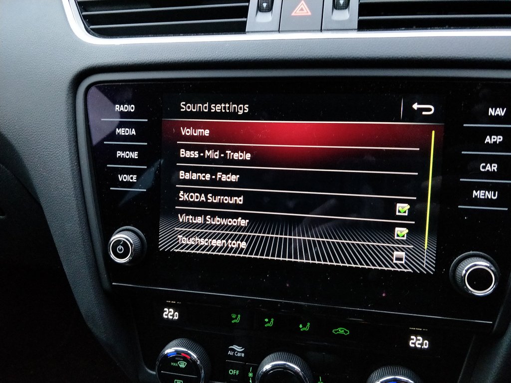

Also enabled the virtual sub today.  I made a start on the traffic sign recognition but ran out of time today in between working on my other car.  Also ordered some more LED bulbs to fit.
@greg_s Hi! Did you do the long coding for the stereo or did you do it with the text version? I looked on my OBD11 and there were some different text descriptions on the long coding before I moved the tab over to hex.
I switched to the hex view as it wasnt clear on the OBD11 descriptions if they were in a numerical order.  I started to work on traffic sign recognition but got stuck on the second step as I couldnt find

@greg_s Guess I need to learn how to do the hex coding then!
Its really straightforward.  Press the 0-1 button at the top of the screen.  Press on top left to select the byte then on the right at top of screen tap the number and select the hex value you want.
All it is doing is setting a bit mask on the values.  This guide should help too http://forum.obdeleven.com/thread/102/long-coding
Thanks Greg, found some helpful pictures to go with the instructions and its alldone!
Great news @ExSEAT I’m gonna have a bit more of a look at the traffic sign recognition and see if I can find the missing value.
